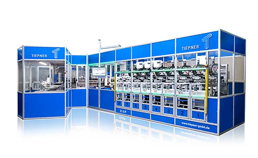

Tiepner designed this card manufacturing system to be run by one person in a three-shift operation. Photo courtesy TOX Pressotechnik

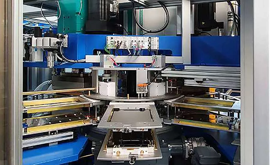

Three servo presses are installed in the laminator: two in the heating presses and one in the cooling press. Photo courtesy TOX Pressotechnik

The system can produce 2,000 cards per hour. Photo courtesy TOX Pressotechnik

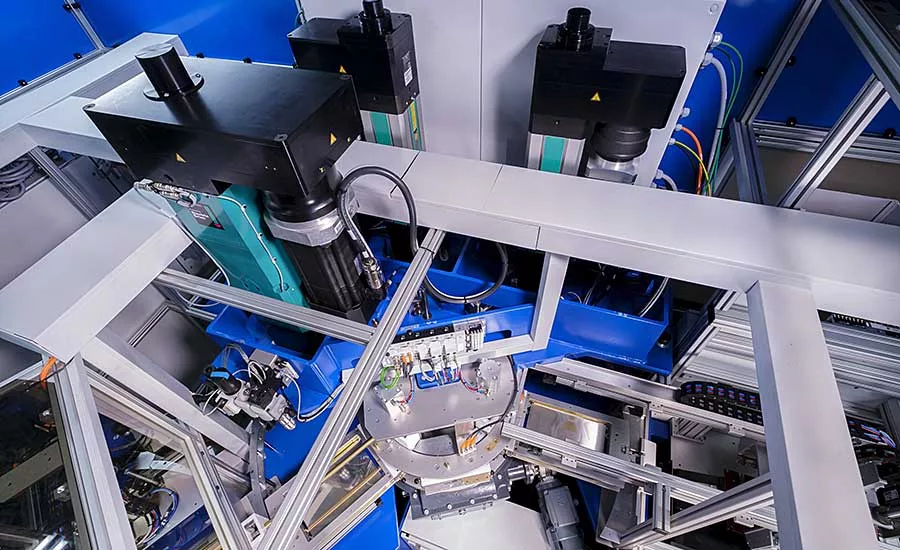

The servo presses are quieter and more economical to operate than pneumatic presses. Photo courtesy TOX Pressotechnik

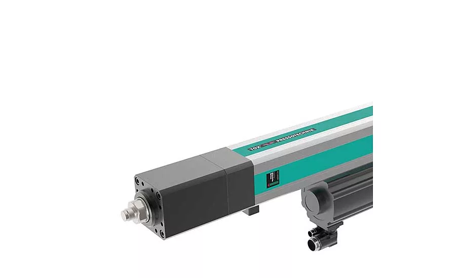

TOX servo presses are designed for highly dynamic processes. Power is transmitted from the servomotor via the planetary drive. Photo courtesy TOX Pressotechnik

A rotary indexing table forwards this collated foil booklet to the heating press, consisting of two heated punches—one at the top and one at the bottom—that can be heated to up to 200 C. The heated press softens the plastic foils and joins them together. Then, a cooling press is used to lower the temperature of the assembly and stabilize the plastic.
The lamination process occurs at cycle times of 18 seconds. The system then forwards the laminated package to the punch. At the end of the process, the punched cards are checked for size accuracy, surface quality, RFID function and other features, before they are stacked in a magazine.

“We have always used the TOX Power Packages for the lamination process, because they are reliable and robust,” says Christian Höltge, CEO of Tiepner. “But we have now replaced the Power Packages operated with compressed air with the TOX Electric Drive in a new machine. It is the first system with electromechanical press drives, which have many advantages for this application.
“These press drives can be set precisely and work more accurately. Above all, they are quieter, which is particularly appreciated by employees. Furthermore, the data can be read and analyzed. For example, we can create force-displacement processes and evaluate performance data for quality control and traceability.”
System operation has also improved with the TOX electric modules, says Höltge. Not least, the overall system has become more economical to operate, since expensive compressed air is no longer needed.
Three TOX electromechanical servo presses are installed in the laminator: two EX-K drives with planetary threaded spindles in the heating presses and one EPMK drive with sensors for force and position measuring in the cooling press. These drives are designed for highly dynamic processes. The power is transmitted from the servomotor via the planetary drive and the planetary threaded spindle to the working piston and consequently the tool. TOX supplies the electromechanical power modules as units that are preassembled and ready for connection.

With the current system, Tiepner has realized the most technically complex card production system to date. The machine is approximately 8 meters long, 5 meters wide and 3 meters high. It is designed to be run by one person in a three-shift operation. It produces 2,000 cards per hour, each one precisely 85.6 millimeters long, 53.98 millimeters wide and with rounded off corners.
