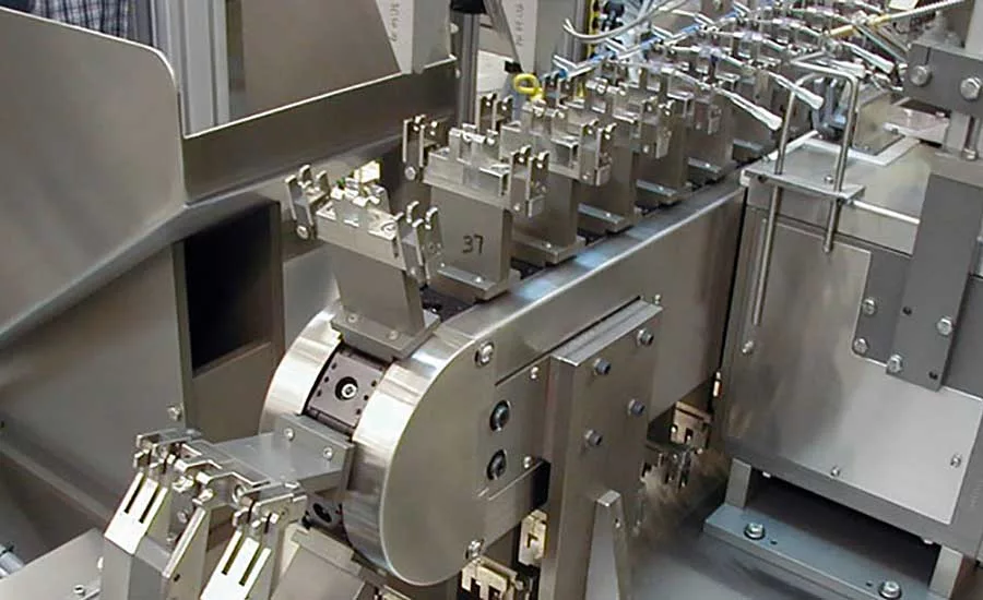

Using precision-cut cams to control tooling motions offers the highest repeatability and reliability in high-speed automated assembly systems. Photo courtesy Concep Machine Co..

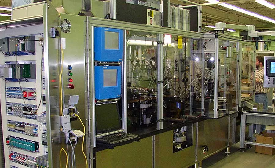

Concep has built numerous automation systems to assemble and test drug delivery devices, such as syringes and cartridge pumps. Photo courtesy Concep Machine Co.

In particular, Concep excels at building cam-controlled, synchronous assembly machines. Using precision-cut cams to control tooling motions offers the highest repeatability and reliability. By driving all cams with a common drive, these machines offer the highest efficiency or lowest cost to operate. Cam-actuated machines provide a lower mean time between failures than any other means of process automation.
