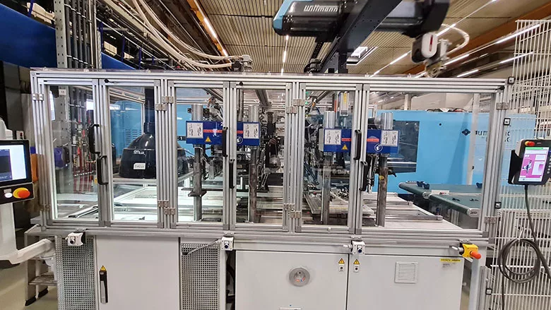

For a few months now, the vacuum cleaner manufacturer, which produces on behalf of Bosch-Siemens with 400 employees, has been running its second hot stamping machine with two ElectricDrive electromechanical servo drives from Tox. The system was designed and installed by Gebr. Gierlich GmbH & Co. of Bonn, Germany, which specializes in the manufacture of hot stamping systems.
In the system, BSH finishes components for vacuum cleaners with a thin film of plastic under the action of pressure and heat. The process is fully automated. A linear handling system removes the plastic parts from the injection molding machine and places them in a hot stamping fixture. In the first stamping step, foil is heated and pressed onto the component with a stamp. In the second step, a temperature-controlled silicone stamp moves onto the plastic part at high pressure and rests there briefly before moving back again. The film part detaches from the carrier and bonds with the component. A camera then checks the process.

For a stable process and an error-free result, the parameters of the individual stamping steps must be set precisely. The pressure with which the stamp moves onto the component is decisive, but the temperature, stroke speeds and stroke lengths of the cylinders are also important.
“This is where the precise adjustment options of the electromechanical servo drives really come into their own,” explains Zehe. “Since we equipped our hot stamping machines with the Tox stamping cylinders, we can automatically measure and readjust the pressure during the stamping process.”
And even after a stamp change, the system readjusts the pressure independently because all parameters have been stored in the software beforehand.
With the old systems with pneumatic drives, this all had to be set manually. Thanks to automation, any number of programs can now be stored, which the plant operator can call up at the push of a button. “Before, we were constantly readjusting and setting the mechanics. Now we specify in advance exactly when we want to have which speed and which stroke,” says Zehe.
He can then read out whether the process has run as planned and correct it if necessary.
