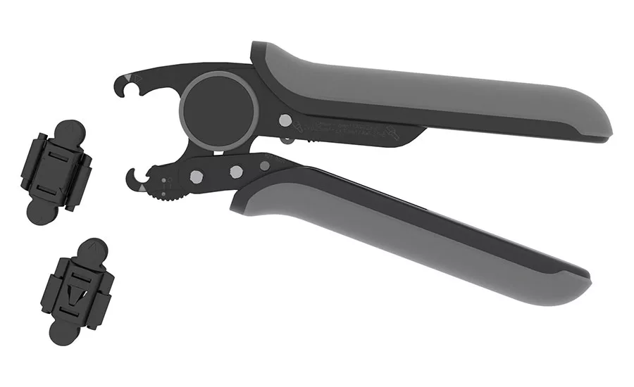

Comfortable and Safe Ferrule Crimping
PZD 16/R and PZU 16/R crimping pliers
October 13, 2023
The PZD 16/R and PZU 16/R crimping pliers are used for precise and safe attachment of ferrules to conductors according to the DIN 46228 standard. The pliers are supplied with a square or trapezoidal crimp insert, respectively. The tools are easy to handle and can be adjusted 360 degrees in 45-degree increments, depending on preference or available space. The inserts can be exchanged quickly without tools. This allows users to adapt them to their preferred posture and work comfortably even in hard-to-reach places.
One tool is sufficient for ferrules, with and without insulating collars, up to 18 millimeters in length, with cross-sections from 0.08 to 16 square millimeters. The tool can also handle twin sleeves from 2 by 0.25 to 2 by 10 square millimeters. The crimp is automatically adapted to the conductor cross-section.
The crimp tools are durable, ergonomic and designed for fatigue-free work. They are compact, lightweight, handy and self-opening via an internal spring. They have soft handles with molded slip protection. Crimping requires minimal effort. An unlockable forced lock ensures safety. The crimp tools are made of high-strength steel, with a special coating for the most stressed parts.
