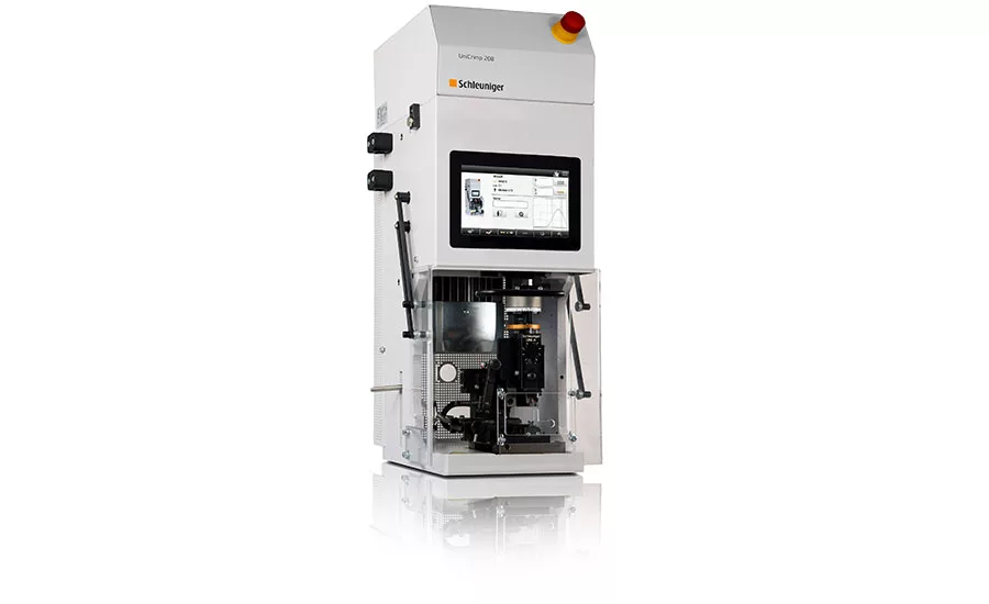

UniCrimp 208 crimping press
Photo courtesy of Schleuniger Inc.
April 25, 2024
The UniCrimp 208 crimping press has a modern and user-friendly design. With maximum crimp force of 33 kilonewtons, the machine reliably connects all rear-feed and side-feed banded terminals to a conductor with high quality and speed. A 7-inch touch-screen interface enables easy and direct operation. It can hold all common mechanical or pneumatic universal crimp tools and the corresponding terminal material. The optional, fully integrated ACO 08 crimp force monitoring system offers enhanced quality assurance. It accepts wire from 30 to 8 AWG. Crimp height is micro-adjustable.
