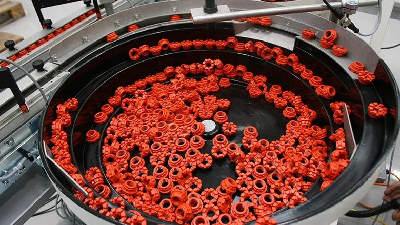

As a rule of thumb, assemblers should provide the feeder manufacturer with enough parts to run a bowl for 1 hour. Photo courtesy RNA Automation

Another early step is to put several parts in a generic bowl with a flat track to see how they react under vibration. The goal of this exercise is to discover the part’s natural orientation and to see how many parts accept that orientation. For example, a pen cap will likely feed with the open end trailing, because more weight is at the closed end.
If 80 percent of the parts come up in a certain position—even if it’s the wrong position—engineers will start with that position and look for ways to change it. Engineers should not fight the part; that will only lead to a small percentage of parts to work with from the beginning.

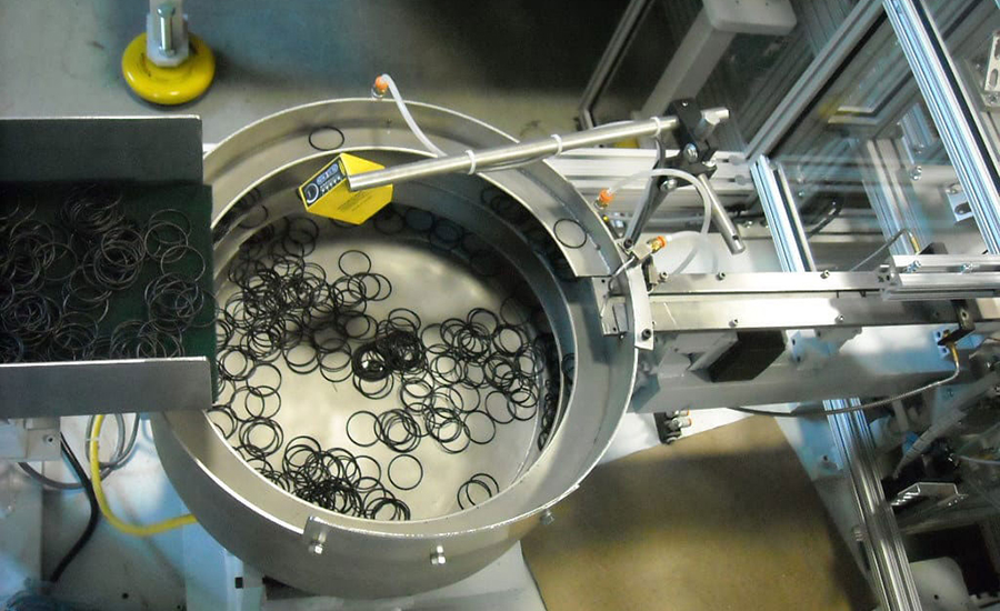

Vibratory feeder bowls are usually made from 300 series stainless steel, because it’s durable and easier to weld than other stainless alloys. Standard bowls are made from 304 stainless, while bowls for food and medical applications are made of 316 stainless.
Various coatings can be applied to the bowl to protect fragile parts, reduce noise, improve part traction, and increase the durability of the bowl. Feeder bowls get smoothed down with use, so parts have less traction. A coating will increase the life of the bowl.
The size of the bowl depends on the size of the part, but a good starting point is what bowl builders call “the rule of seven.” Measure the largest dimension of the part, multiply that by seven, and that will provide a minimum diameter of the bowl.

Vibratory feeder bowls are usually made from 300 series stainless steel, because it’s durable and easier to weld than other stainless alloys. Photo courtesy Engineered Automation of Maine Inc.
From there, the size of the bowl can be modified depending on the feed rate and the space limitations of the assembly system. If the feed rate is high, the bowl will have to be enlarged to accommodate more parts and more lanes. Alternatively, the assembler can add a hopper feeder that replenishes the bowl whenever the level of parts reaches a minimum level.
