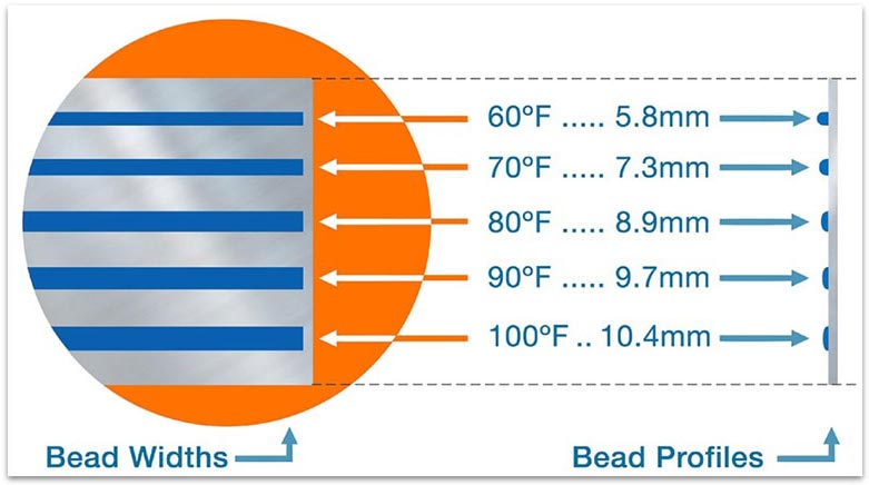

All liquids change viscosity as a function of temperature—even water. As the temperature increases, the viscosity decreases. Conversely, when the temperature decreases, the viscosity increases.
The viscosity of an adhesive can range from 200 to 1.5 million centipoise (cps). However, that viscosity will vary, depending on the temperature. For example, one sealant’s viscosity drops steeply from more than 8,000 cps at 64°F to less than 4,000 cps at 78°F—a twofold decrease in viscosity in a span of just 14 degrees.
Temperature-related variation in viscosity
Temperature-related variation in viscosity can directly affect the shape of the bead or fan pattern being dispensed. Photo courtesy Saint Clair Systems

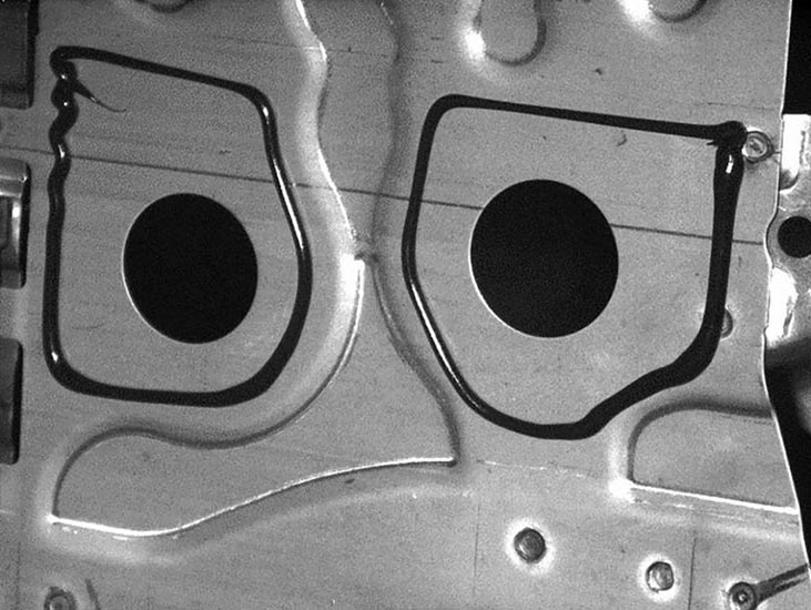

The company’s technology is important for bonding, because temperature-related variation in viscosity can directly affect the shape of the bead or fan pattern being dispensed. For example, if a hem flange sealant is thinner than expected, the bead might be wider and flatter than specified. This is often referred to as spread or slump. It can significantly compromise the function of the bead.

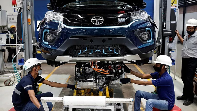

This was the case at the Tata Motors assembly plant in Pune, India. Tata Motors is India’s third-largest manufacturer of passenger vehicles. Every seventh car sold in India is made by Tata Motors.

If a sealant is thinner than expected, the bead might be wider and flatter than specified. This can significantly compromise the function of the bead. Photo courtesy Saint Clair Systems
