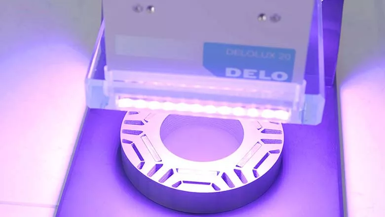

light-curing, heat-resistant epoxy
Light-curing, heat-resistant epoxy is used to attach magnets in electric motors.
Photo courtesy DELO Industrial Adhesives
