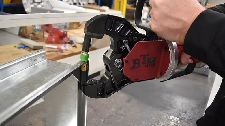

Hand-held presses are used for stationary applications that require multiple fastening locations.

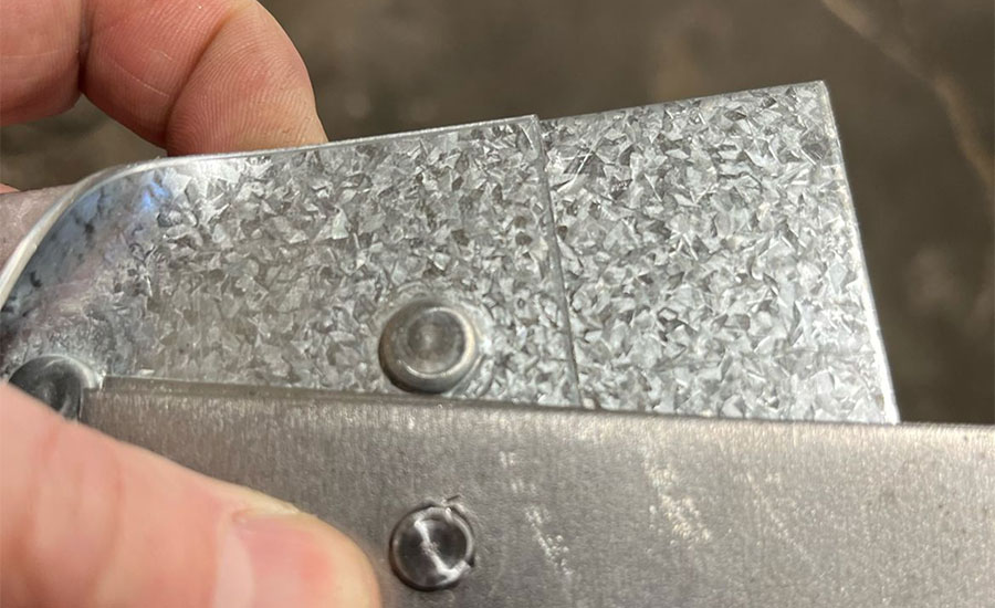

Clinching is an old-school joining process that is commonly used to fabricate pieces of sheet metal. It’s a high-speed assembly technique that can eliminate the need for adhesive bonding, screwdriving or welding.
Clinching produces a round, button-like connection between two to four layers of sheet metal. The process can join metal sheets of different thicknesses. It can also join dissimilar materials, such aluminum, copper, stainless steel and titanium, without creating an isolating intermetallic phase. However, clinched joints are not as strong as spot welds.

Clinching can be done manually with handheld tools or with robotic automation. A variety of benchtop, floor mounted and portable machines are available, including electric and pneumatic models.

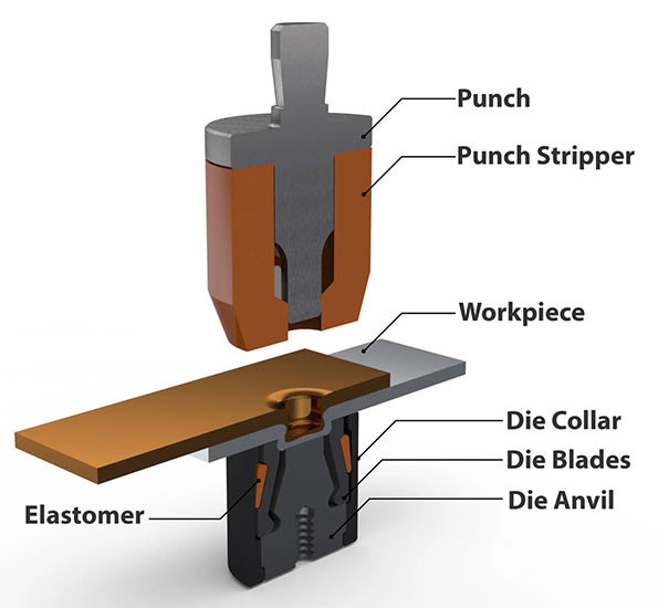

Sheet metal clinching uses a punch and a die to mechanically join material. Illustration courtesy Press Lock Technologies
Tooling consists of a punch and a die that are designed specifically for the materials to be joined. Material is pushed into the die, forming a mechanical interlock similar to a press stud.
There are two types of dies: solid, fixed-cavity dies, and dies with moving components. The punch forces the layers of sheet metal into the die cavity. The pressure exerted by the press forces the punch-side metal to spread outwards within the die-side metal. Joints typically range from 1.5 to 26 millimeters in diameter.
