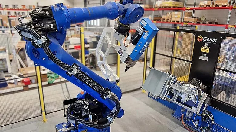

robot equipped with C-frame tooling and a servo press
This robot is equipped with C-frame tooling and a servo press that applies 55 kilonewtons of force. Integrated sensors on the press measure force and displacement during clinching.

Recently, BTM Scandinavia was contacted by contract manufacturer Steinadler AB of Astorp, Sweden, for help producing a ventilation housing that had previously been assembled with spot welding and blind rivets. The task was to join six metal sheets of different thicknesses with 34 clinch joints. The manufacturer wanted an energy-efficient process and durable, residue-free joints.
BTM Scandinavia replaced the spot-welding process with a semiautomatic clinching process featuring a six-axis robot and an energy-efficient electromechanical press from Kistler.
clinching
Quality assurance is supplied by the maXYmos system. It controls, visualizes and monitors the clinching process and makes production data accessible for higher-level software systems. Photo courtesy Kistler
“Dragiza Tosovic, the CEO of Steinadler, explicitly asked for the newest and best technology for production of the ventilation housings. We had to consider both economic and ecologic aspects. So, it was a perfect opportunity for the new NCFC servo press from Kistler. With its low weight of 46 kilograms, compact size, and maXYmos process monitoring system, it is ideal for robotic assembly,” reports Claesson.
The robotic work cell uses a rotary indexer position the parts. The robot is equipped with C-frame tooling and a NCFC servo press that applies 55 kilonewtons of force. Integrated sensors on the press measure force and displacement during clinching. Quality assurance is supplied by the maXYmos system. It controls, visualizes and monitors the clinching process and makes production data accessible for higher-level software systems.
“The main challenge in this application was to realize 34 clinch joints in a cycle time of one minute and 20 seconds,” explains Volker Eilmannsberger, development engineer for joining systems at Kistler. “In addition, the assembly had to be moved multiple times to reach all the clinching positions. This parallel operation also has an influence on cycle time. Thanks to the NC functionality of our joining system, the different traverse paths could be optimized relatively simply.”
clinching
The main challenge in this application was to produce 34 clinch joints in a cycle time of one minute and 20 seconds. Photo courtesy Kistler
Thanks to its small size and low weight, the NCFC press is particularly suited for robotic assembly. Efficient integration is fostered by the new hybrid cable technology of the press. Energy, signals and data are transmitted via a single hybrid cable.
The work cell has worked so well that another production cell for ventilation housings is already in progress.
