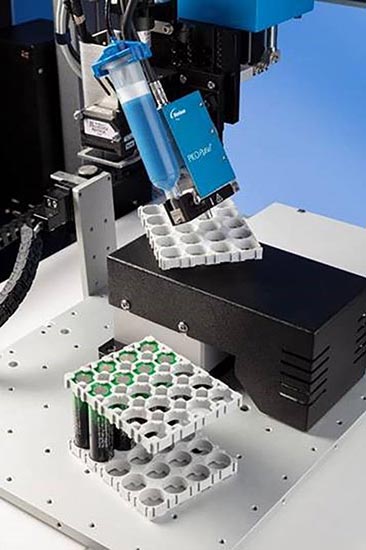

Adhering anode, separator and cathode layers requires small, precise amounts of material to attach more than 100 thin electrode layers contained in cylindrical and prismatic lithium-ion batteries. Each application requires a fast dispense time between 1 and 4 seconds per dot of adhesive applied between the layers of each battery cell.
For this application, jetting systems provide the most control at the high speeds. They dispense fluid deposits as small as 0.5 nanoliters at up to 1,000 hertz (Hz) with bursts up to 1,500 Hz continuously.
Products such as Nordson EFD’s recently released PICO Pµlse XP piezo jetting system are designed to maintain precise, repeatable noncontact fluid dispensing regardless of external factors such as temperature changes. Its sustained stroke target permits the valve to self-adjust to maintain a micron-level stroke setting for long periods, despite changes in environmental conditions that can alter dispense results over time.
Dispensing equipment must also be able to withstand the corrosive properties associated with filling electrolyte cells. Accurate, repeatable amounts of adhesive are required to seal the top of cylindrical and prismatic battery cells to prevent short-cuts. Jetting dispense systems provide the speed and accuracy needed to keep up with the throughput and quality assurance requirements of this application.

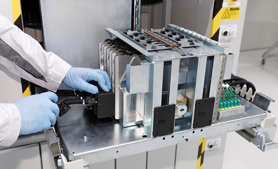

When applying TIMs, the conventional approach has been to apply thermal tape or thermal gap pads manually instead of thermal grease because of cost reductions. But, the pads do not always conform to different gap geometries, which does not allow consistent coverage of thermal material on the part.
For some applications, battery manufacturers use a handheld fluid dispenser to apply fluid manually, which allows coverage that thermal tape and gap pads do not always provide. However, with manual dispensing, coverage inconsistencies frequently occur due to operator-to-operator variability.
