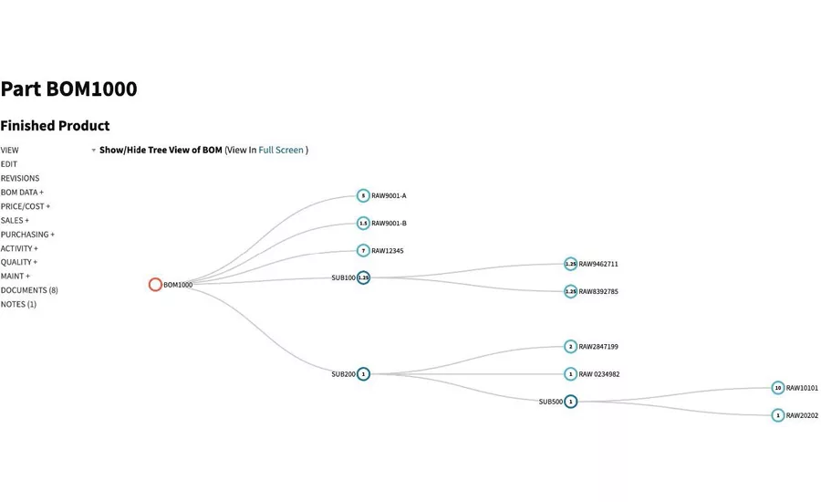

'BOM Tree View' of a sample multilevel, hierarchical (or indented) bill of materials modeled in an ERP system. Source: Cetec ERP

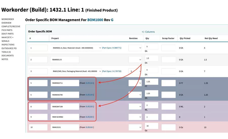

Example of a phantom BOM on a work order. The material and labor of subassemblies roll up into the parent BOM, taking a product with a complex BOM structure from engineering and simplifying it into a single work order for production. Source: Cetec ERP

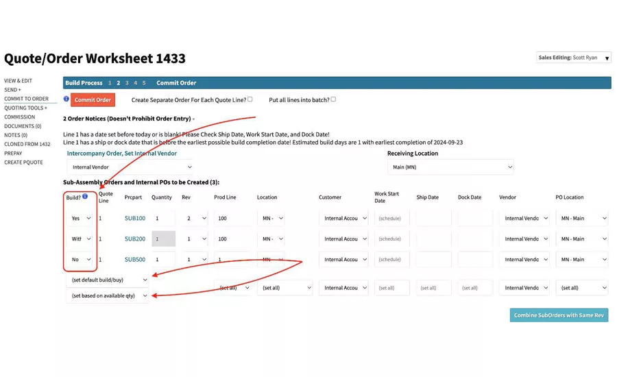

Example of order entry for a top level BOM containing multiple sub-BOMs, highlighting different paths for managing material planning and production. Source: Cetec ERP

In engineering-heavy manufacturing environments, decisions about part numbering and structuring multilevel bills of materials (BOMs) can impact the entire company’s operational efficiency significantly and in unexpected ways.
For manufacturing engineers, creating multilevel BOMs seems natural. It mirrors the product’s logical build flow, often with subassemblies reflecting nested dependencies. However, this engineering-driven approach may not always align with production realities, causing inefficiencies on the shop floor. Production workers are faced with building through these layers in real time, which can create unnecessary paperwork and slow everything down.

When a work order for a top-level BOM is entered into your ERP, the system should auto-detect any sub-BOMs within the overall BOM structure. For example, with Cetec’s ERP system, engineers have three options for handling sub-BOMs at the time of entering a work order for the top-level BOM.
The first is “Build = Yes.” This option creates a work order for the subassembly, nesting it beneath the parent work order. The entire work order structure is dynamic, allowing easy adjustments to schedules through the “related orders” page. This option is ideal for scenarios where subassemblies are built internally, providing full control over the production flow.
The second option is “Build = No.” If you choose this option, the subassembly is treated as a purchased component. The system will not create a work order, which is useful when outsourcing the subassembly or when the subassembly is used across multiple products. This option also allows demand to flow through the material requirements planning system, letting production planners manage it independently.
The third option is “Build = With Top (Phantom BOM).” This is a phantom BOM setting, which effectively bypasses the subassembly. Instead of creating separate work orders for each subassembly, all components of the subassembly are pulled into the parent BOM. This method simplifies production by treating the subassembly as part of the top-level product.

To further streamline production, you can automate the build settings for subassemblies based on available inventory. If sufficient inventory of a subassembly exists, the system can automatically select “Build = No.” If no stock is available, it can set “Build = Yes” and even calculate the exact quantity needed. This eliminates manual intervention and ensures that production schedules align with material availability, minimizing delays.
The third sub-BOM option provides a compromise to the problem of overly structured BOMs that slow down production. For manufacturers running multilevel assembly processes, creating separate work orders for each subassembly can be cumbersome. Phantom BOMs allow companies to model complex product structures without generating a surplus of unnecessary production orders.
For instance, consider an autombile engine with components like the block, camshaft and piston assemblies. While each of these could be treated as separate subassemblies, creating production orders for each is impractical. By marking the piston assembly as a phantom BOM, you combine its components into the top-level engine BOM. This simplifies the workflow, as production workers only need to issue one production order that includes all the materials for the piston assemblies.
Phantom BOMs flatten the BOM structure while preserving the logical dependencies engineers value. They enable streamlined production by bundling subassemblies together, reducing the number of work orders required.
