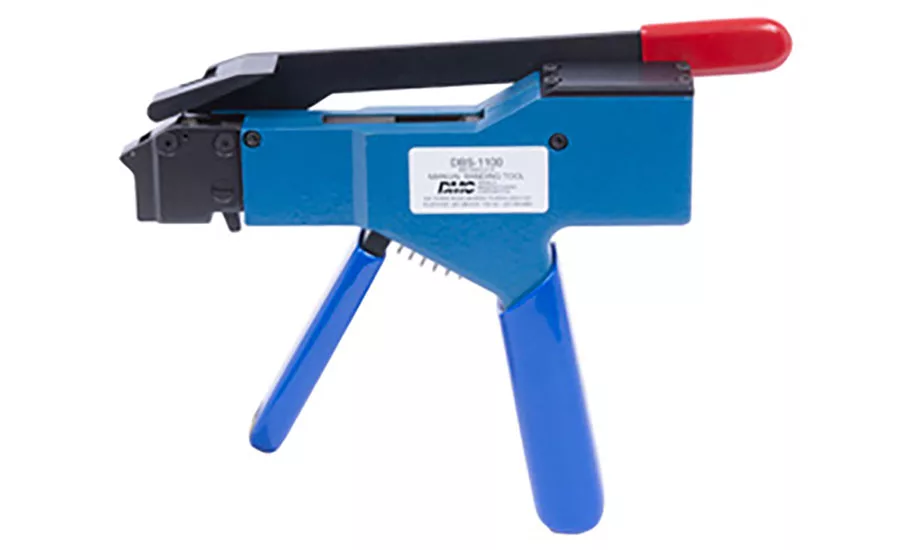

Daniels DBS-1200 two-step banding tool
Image courtesy of Daniels Manufacturing Corp.
January 28, 2025
These manual two-step banding tools are qualified to SAE AS81306/2 specifications.
The DBS-1200 is designed to install 0.25-inch M85049/128 welded buckle bands. These tools tension and cut the band leaving an extended cut off tab. The DBS-R05 roll-over tool is then used to fold the tab 180 degrees to prevent slippage. It also installs M85049/128-5 flat bands and M85049/128-6 coiled bands. The tool weighs just 1.4 pounds.
The tools apply tension ranging from 70 to 90 pounds, and they are sold with banding calibration certificate traceable to NIST standards. The tools can be adjusted and verified to ensure correct band tension. (An optional verification gauge is available to measure the tool tension.) The cut-off blades are replaceable.
For improved ergonomics in high-volume production environments, the PBT1200 pneumatic banding tool is also available.
