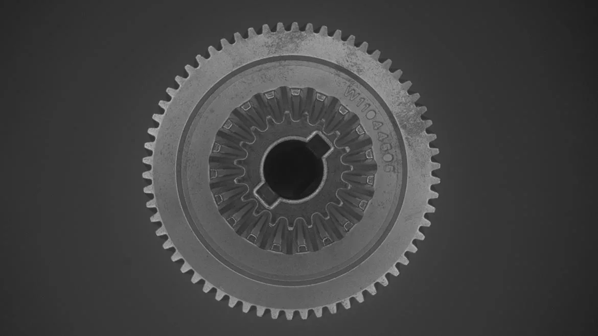

Different types of machine vision applications require different lighting setups. An optimal lighting setup must highlight the features to be detected relative to the background and must help create repeatable images regardless of part or product variation. Figure 1, for example, shows the same part with two different lighting setups. On the left, is a “good” image of a beveled gear captured with a dark field ring light, while the image on the right shows an image captured with a linear dark field setup, which produced linear effects on two sides of the gear. The image on the left shows sufficient contrast, allowing the software to clearly see teeth of the gear, along with the character printed directly on the part.
Figure-1AB. The image on the left uses a ring light dark field implementation while the image on the right shows a linear darkfield setup, which does not produce sufficient contrast needed for a machine vision system.
Figure 1: The image on the left uses a ring light dark field implementation while the image on the right shows a linear darkfield setup, which does not produce sufficient contrast needed for a machine vision system. Image Source: Smart Vision Lights
