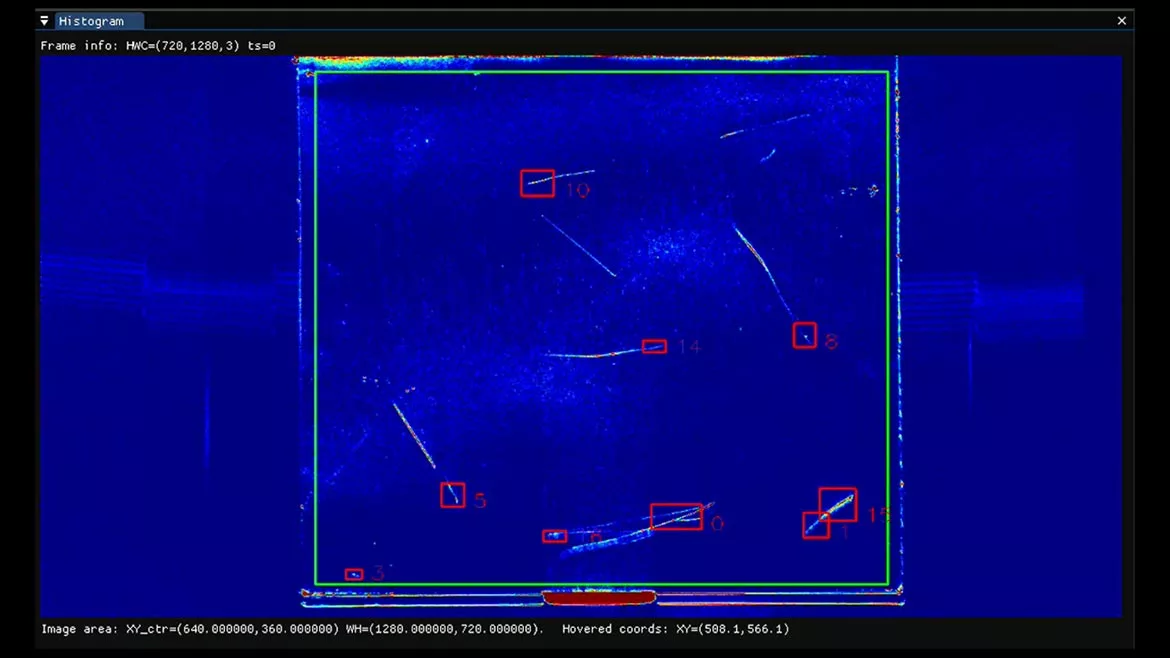

Histogram Screenshot
Image Source: Prophesee

Event cameras help lower reject rates with real-time feedback and advanced processing down to a 5 µs time resolution and blur-free asynchronous event output. One specific use case is in the automatic detection and classification of the finest imperfections in manufacturing materials, for example in automotive part to perform paint defect inspection, scratch detection, and planarity testing (See Figure 2).
