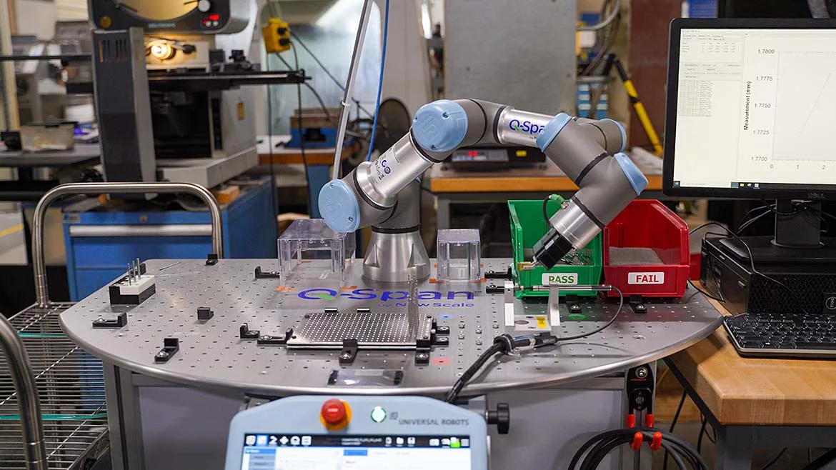

New Scale Robotics: an automated gaging system used to measure a small tray of surgical drills.
Collaborative robots enable production workers to deploy automated gaging for high-mix low-volume production. This example shows an automated gaging system used to measure a small tray of surgical drills. Source: New Scale Robotics
