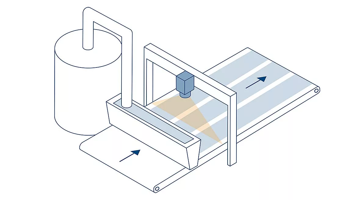

Battery inspection coating
Image Source: Basler

Coating the substrate foil with slurry is a critical production step. The surface quality must be uniform, free of voids and particles, and the thickness of the slurry must be precise and homogeneous.
Electrode coating in detail
In electrode coating, the carrier or substrate foil is coated with the previously mixed slurry using an application tool such as a slot die, doctor blade, or anilox roller. The top and bottom sides of the foil can be coated in parallel or sequentially. This is followed by a drying process.
This process step is particularly critical because many parameters must be precisely coordinated: the slurry must have the required stability and be applied at the correct rate. The aim is to achieve perfect coating homogeneity, without cracks or agglomerates, as the electrode layer is particularly important for battery performance.
However, many defects can occur in both intermittent and continuous electrode coating. Typical defects include agglomerates, coating cracks, contamination from foreign bodies and micro-compressions that occur when the coating is applied too thinly. Mud cracks, pinholes and breakouts at the end of the coating web are also possible defects.
