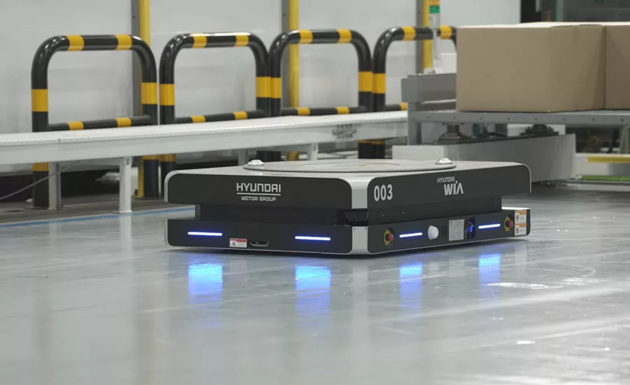

automated guided vehicle
Hyundai has deployed 5G networking technology in its factories to control automated guided vehicles.
Photo courtesy Hyundai Motor Group

Hyundai tested Samsung’s system with its in-house vehicle inspection equipment. Engineers developed a custom device to verify the network’s operational capabilities.
The company applied the technology on automated guided vehicles at its flagship assembly plant in Ulsan, South Korea. It also adopted the technology at its U.S. factory in Montgomery, AL, to operate a fleet of more than 200 autonomous mobile robots.
“The implementation of the technology at [our] plants in Korea and the U.S. has significantly reduced communication disruptions and downtime,” says Jae Min Lee, vice president and head of E-FOREST Center of Hyundai Motor and Kia. “[We have] also developed a patented dual wireless communication solution combining 5G networks with Wi-Fi, leading to zero communication-related downtime since its deployment.”
