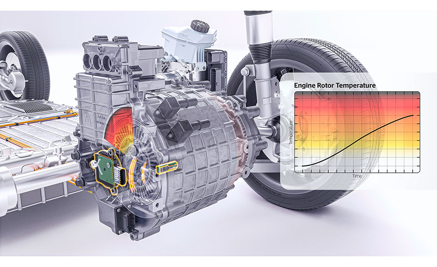

Continental Takes the Temperature
As EV motors and drives evolve, Tier One suppliers are investing in technology to improve performance and reduce costs. For instance, engineers at Continental AG recently developed a rotor temperature sensor (eRTS).
The device enables direct temperature measurement on the rotor, giving e-motors more control over key aspects of power train engineering, potentially unlocking material savings and improved performance. It opens new possibilities for optimizing both magnet configuration and motor cooling.
For PM motors, the ability to measure temperature precisely at the rotor enables engineers to significantly narrow the tolerance range they must design for. That tighter band of uncertainty gives them a choice: either improve performance or reduce the amount of dysprosium required in the magnets.
“In one case, OEMs can reduce the dysprosium content thanks to the smaller tolerance range now needed,” says Franck Nieceron, electronic group leader for development e-mobility sensors at Continental. “This leads to material savings in both cost and environmental impact.”
Alternatively, engineers can maintain their current rare-earth usage and stretch the operating temperature range of the motor, thereby enhancing performance under demanding conditions.
The potential impact on motor cooling is also notable. Direct rotor measurement could enable future designs that rely less on aggressive cooling strategies, although it’s still too early to quantify savings in that area.
“It will potentially allow for reduced cooling requirements, but so far there is no evaluation of savings,” explains Nieceron. “For rotor balancing, integrating the eRTS sensor requires drilling a cavity in the rotor for the sensing unit, a process that could impact existing manufacturing workflows.

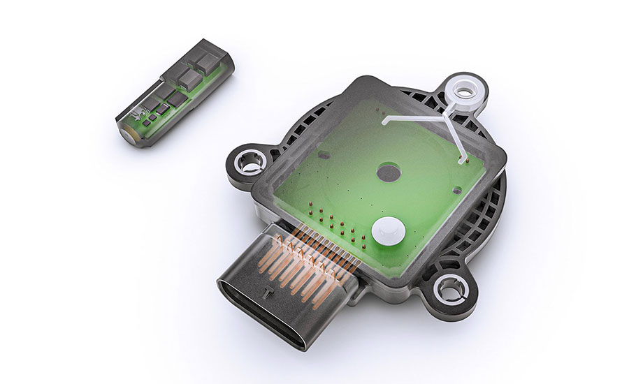

rotor sensor
This rotor sensor enables direct temperature measurement. Illustration courtesy Continental AG
Given the diversity in EV motor designs, including differences in shape, operating speeds and thermal environments, Continental doesn’t expect to deliver a one-size-fits-all solution.
Instead, Nieceron says the goal is to adapt the eRTS architecture with only minor modifications to suit different customer requirements and inverter protocols.

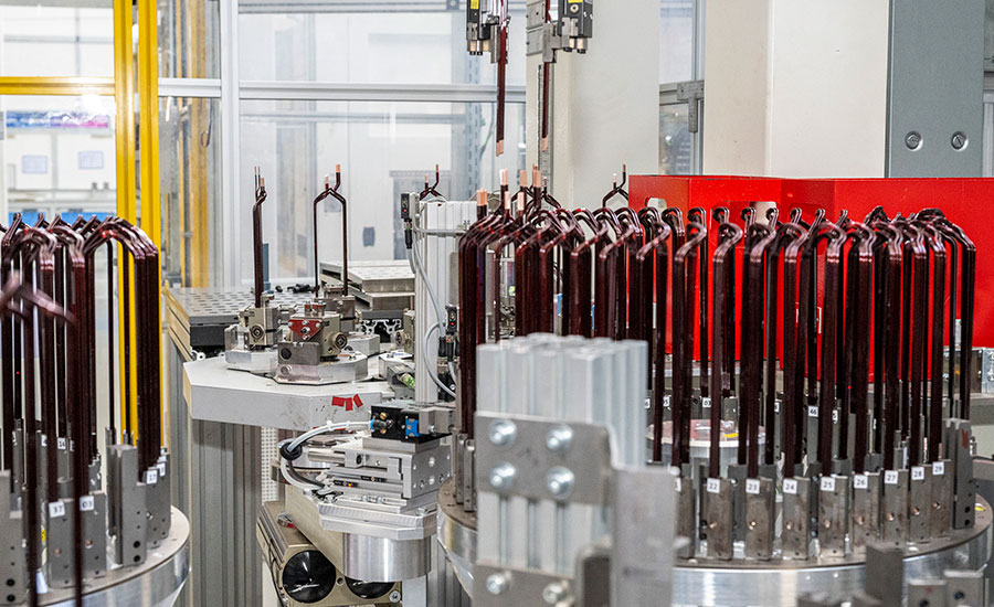

insulated copper hairpins inserted into stator slots
Insulated copper hairpins are inserted into stator slots, shaped and positioned using automated equipment. Photo courtesy Volkswagen AG

Volkswagen uses a highly automated process to mass-produce motors. The most complex element, the stator, begins with a laminated steel core made from 0.2-millimeter thick sheets, which are stamped and prepared with slot insulation to electrically isolate the copper hairpins inserted in the next stages.
The insulated copper hairpins are inserted into the stator slots, shaped and positioned into a configuration referred to internally as a “basket.” That is joined with the stator core, followed by a series of fully automated steps, including widening, twisting and laser welding, to form all electrical connections.
To stabilize and secure the stator windings for a lifetime of operation, the assembly undergoes a “dipping and trickling” process, where a liquid resin is applied and then hardened through controlled heating and cooling.
“This ensures the hairpins are fixed in place,” explains Krick. “Otherwise, movement during operation could lead to insulation issues and electrical failures.”

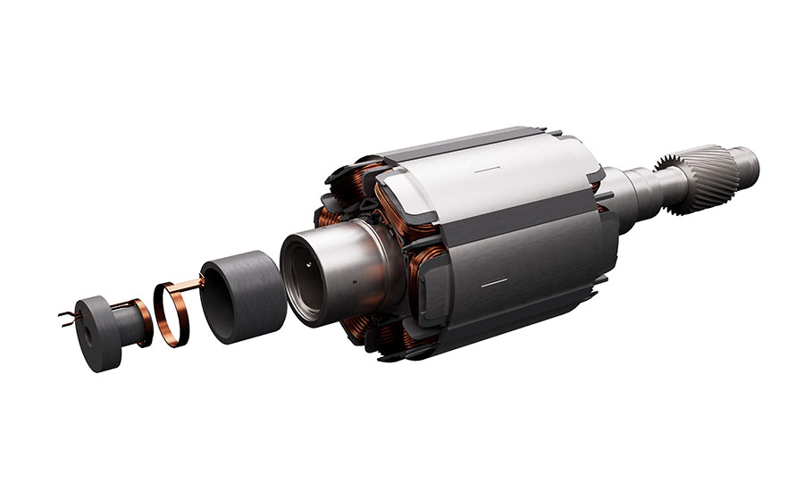

separately excited synchronous motor technology
Separately excited synchronous motor technology eliminates rare-earth dependency. Illustration courtesy ZF

To address this issue, ZF engineers have developed a separately excited synchronous motor (SESM). It transmits energy for the magnetic field via an inductive exciter inside the rotor shaft. This makes the motor compact, with maximum power and torque density.
Compared to traditional SESM systems, the inductive exciter can reduce losses for the energy transmission into the rotor by 15 percent. In addition, the CO2 footprint in production, which arises with PM synchronous e-motors due to magnets that rely on rare-earth materials, can be reduced by up to 50 percent.
Torque density is also significantly increased, because of an innovative rotor design. The space-neutral integration of the exciter into the rotor means that there are no axial space disadvantages. In addition, an increase in power density in the rotor leads to an improvement in performance.
