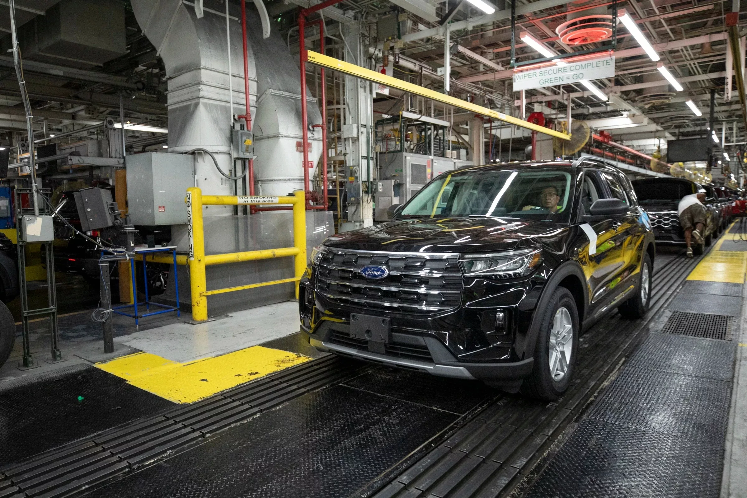

Ford has received a U.S. patent on a vision-based quality system. Photo courtesy Ford Motor Co.
