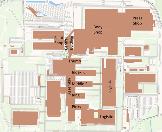

BMW calls its idea a “finger” structure. Ford has developed an “assembly tree.” Tesla refers to its method as “unboxed” assembly, while Toyota has deployed a “bias chassis” line. Each of these new-age approaches has pros and cons.

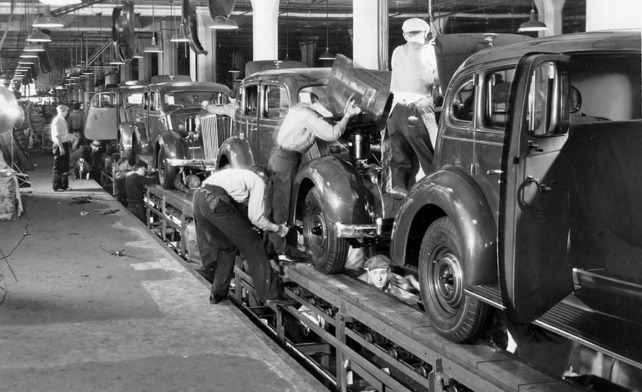

Photo from 1935 of Packard Motor Car Co. assembly line in Detroit
Automobiles have been mass-produced the same way for decades. This view from 1935 shows the Packard Motor Car Co. assembly line in Detroit. Photo courtesy National Automotive History Collection, Detroit Public Library
“What has changed are variations of the theme rather than the core process,” says Sullivan. “Modern innovations like fingers, subassemblies and door-to-door vs. nose-to-tail configurations are all variations designed to improve access, flexibility, isolation of variation and automation integration. These modifications all serve the same fundamental goal: return on invested capital.

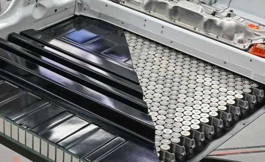

structural battery
Structural batteries serve as the floor of electric vehicles assembled with modules. Photo courtesy Tesla Inc.
“It will enable operators to work faster. It also opens up the opportunity for swarm assembly, where five or six people can be working in the same area at the same time vs. only one or two people, because of crowding issues.”

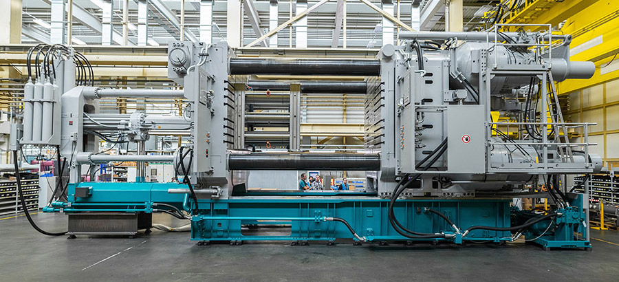

high-pressure aluminum die-casting press
High-pressure aluminum die-casting presses can produce large-dimension parts that enable modular assembly. Photo courtesy Buhler AG

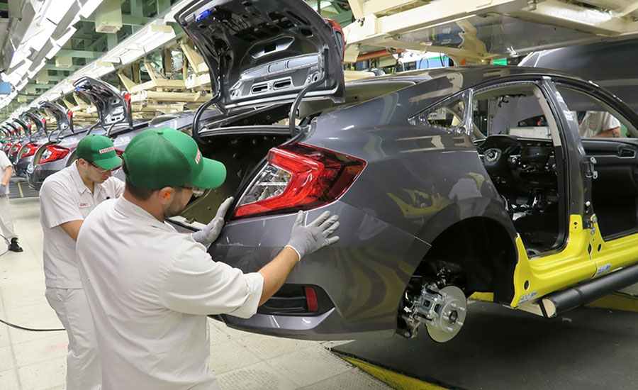

door-to-door assembly
Honda pioneered door-to-door assembly at its Alliston, ON, factory. Photo courtesy Honda Motor Co.
Side-by-Side Assembly
Toyota is not the first automaker to experiment with door-to-door assembly lines. In fact, other Japanese companies have deployed the concept in the past, such as Honda’s factory in Alliston, ON., which builds the Accord sedan, and Mitsubishi’s flagship Okazaki plant in Japan which assembles the Outlander SUV.
“The concept has also been used in other industries,” says Locher. “I worked with a company many years ago that produced large waste containers and dumpsters. It reconfigured its inline assembly line to turn units 90 degrees and build them in a sideways configuration.
“This manufacturer was able to balance its line, because it eliminated a ton of unsafe movement and reduced a lot of wasted motion,” explains Locher. “But, the company had much longer takt times than what’s typically found in the auto industry.”
“Bumper-to-bumper assembly is better when working on the inside of a car through the doors,” adds Christoph Roser, Ph.D., a professor of production management at Karlsruhe University of Applied Sciences who has studied numerous auto plants in Germany and Japan. “Side-by-side is better for working under the hood or the bumper, and to a lesser degree, for working underneath the axles.
“On a door-to-door assembly line, the front and rear workers have to walk less than on a bumper-to-bumper line,” explains Roser, who has written several books and is the author of a blog entitled AllAboutLean. “But, anyone working on the door side has to walk slightly more.”

BMW's assembly fingers
BMW uses “assembly fingers” at its plant in Leipzig, Germany. Illustration courtesy All About Lean
BMW Gives Assembly the ‘Finger’
When BMW’s new assembly plant in Debrecen, Hungary, opens next month, it will be the automaker’s first factory designed specifically for the production of electric vehicles. Located 155 miles east of Budapest, the facility will assemble the iX3 SUV, which will be built on BMW’s much-anticipated Neue Klasse platform.
“The innovative vehicle architecture of the Neue Klasse opens totally new possibilities with regard to assembly: greater efficiency thanks to modularization, fewer different connecting elements and a simplified installation of the wiring harness,” says Hans-Peter Kemser, managing director of BMW Group Plant Debrecen. “An innovative cockpit assembly also accelerates the process.
“Some components are modularized when one module is formed from many small individual parts,” explains Kemser. “The variation of connecting elements has also been radically reduced for the Neue Klasse. This in turn reduces the number of different plugs, screws and clips. All of this makes assembly significantly more simple.”
Another unique feature of the Debrecen plant is its layout. It will use a “finger structure” that resembles the five fingers on a hand: thumb, index, middle, ring and pinky. The assembly line loops around each finger.
The design, which was pioneered at BMW’s factory in Leipzig, Germany, improves material flow. It enables components and preassembled modules to be easily transported directly to the assembly line.
“A record proportion of parts—up to 80 percent—can be delivered directly in Debrecen, as the fingers will enjoy logistics supply from both sides for the first time,” says Kemser. “This is the highest ratio in [our entire] production network. The finger structure allows subsequent extension and the integration of further assembly steps [for greater] flexibility.”
“The finger structure represents a sophisticated variation isolation strategy,” adds TBM’s Sullivan. “Each finger or appendage isolates specific variations, such as right-hand drive vs. left-hand drive configurations, allowing the main backbone to handle common elements while fingers manage unique requirements.
“Speed and efficiency optimization occurs through independent finger operation,” explains Sullivan. “Different fingers can operate at different speeds depending on their specific variation requirements. Some fingers might run four-minute cycles consistently while others handle shorter, variable cycles. This isolation prevents the feast or famine scenarios that occur when high-variation work is handled on main lines operating at fixed takt times.”
According to Sullivan, flexible capacity management allows fingers to be idled when specific variations aren’t needed, activated when demand increases or operated at different speeds based on model mix requirements. This flexibility provides significant advantages for managing market variability and production scheduling.
“The system particularly benefits European manufacturing requirements,” notes Sullivan. “European plants typically serve global markets with far more variation than American plants, including right-hand vs. left-hand drive configurations and diverse regulatory requirements. BMW's experience serving 90 countries from single plants necessitates sophisticated variation management capabilities.
“Material access advantages are substantial, with a high percentage of parts deliverable directly to workstations,” Sullivan points out. “The finger structure enables logistics supply from both sides, dramatically improving material flow efficiency.
“However, these systems require significant investment and coordination,” says Sullivan. “While Germans excel at these techniques and have proven their effectiveness through modeling and implementation, the complexity and cost are substantial. The approach reflects European manufacturers’ long experience managing variation that American automakers traditionally avoided through market segmentation.”
