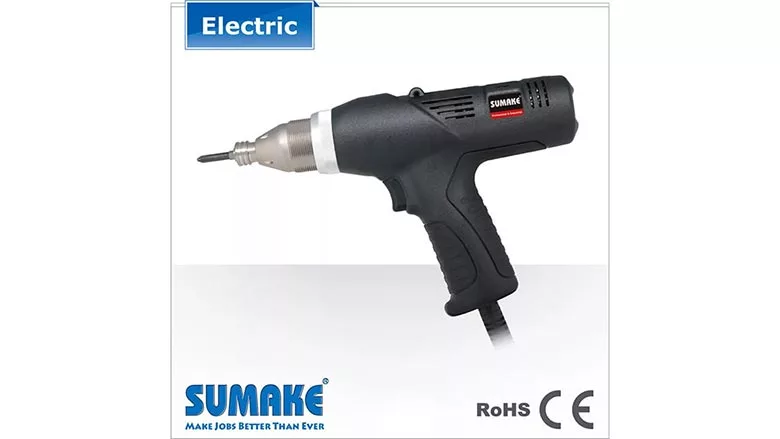

Pistol-Grip Screwdriver With Transducer
When paired with the SMT Smart Controller, the Transducer DC Pistol Screwdriver is engineered to deliver precision, efficiency and control for critical fastening applications. The screwdriver features a high-precision torque transducer with a rotational resolution of 36 degrees, or one-tenth of a full revolution. The tool can save torque and rotation data to a micro-SD card or transmit it in real-time via RS-232 for centralized monitoring and analytics. The tool saves 50 unique job profiles for maximum flexibility and tailored assembly operations.

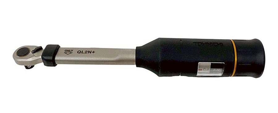

Adjustable Click-Type Torque Wrench
The QL+ adjustable click-type torque wrench is designed for low torque ranges: 0.4 to 2 newton-meters or 1 to 2 newton-meters. The newly designed scale is easy to read and intuitive to use. The internal structure has been improved to provide a smooth clicking sensation and high-precision tightening. Its compact design makes torque management easier in tight spaces. It uses 48 gears for efficient tightening with reduced ratcheting loss.

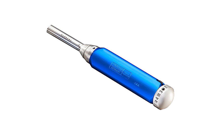

Manual Torque Screwdriver
The Exactorq 100 manual torque screwdriver covers a torque range of 20 to 100 inch-ounces. It has a bidirectional accuracy of ±6 percent of the preset value. It meets or exceeds ASME B107.300-2010 and ISO 6789 standards. The operator cannot over-torque the screw; the clutch releases automatically when desired torque has been achieved. The short dwell time prevents repetitive motion injuries. The torque is preset using a torque tester. It can be set in any unit of torque measurement. It uses standard ¼-inch bits, adapters and sockets.
It can be ordered preset from the factory with a calibration certificate from Sturtevant’s ISO/IEC 17025 accredited calibration laboratory.
