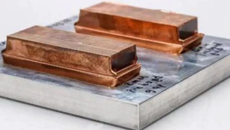

Cold welding can be used to join similar and dissimilar materials, such as copper to aluminum.

Cold welding is ideal for joining metals and alloys when the high heat of traditional welding methods could compromise the integrity of the materials. The process is particularly effective for joining gold, zinc, silver, brass, copper and aluminum, especially grades that are deemed non-weldable with traditional methods.
The process is often used to bond dissimilar metal parts, like copper wires to aluminum fittings in electrical applications. It’s also used in the aerospace industry to bond metals such as stainless steel or copper to aluminum. Trying to join dissimilar metals with conventional welding processes can result in heat-affected zones and brittle bonds that would be subject to failure.

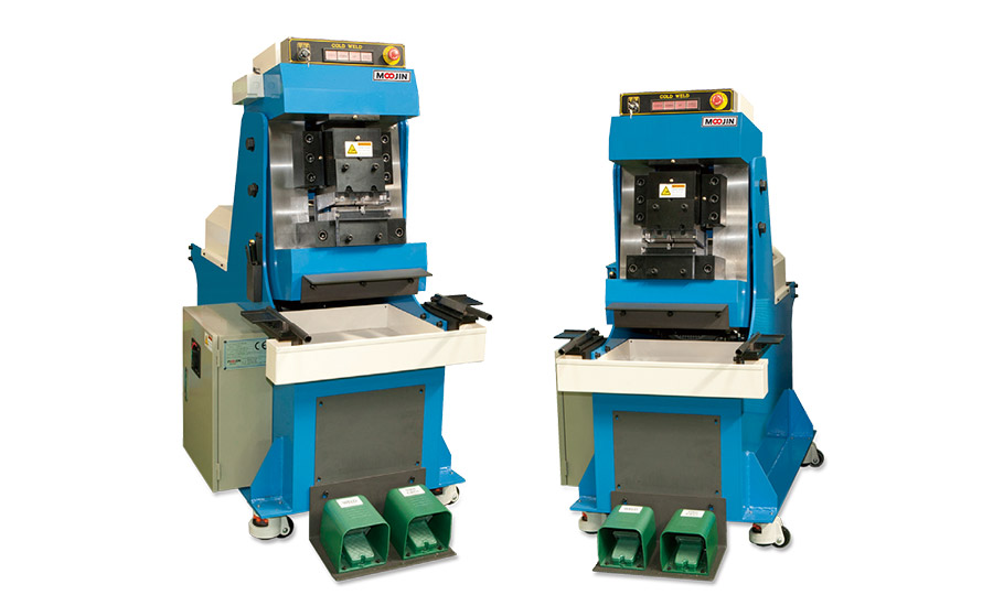

cold welding with a press
Cold welding is a solid-state process for joining two pieces of metal together with high pressure. The pressure causes the metal atoms to deform, flow and come into intimate contact. The atoms come so close together, in fact, that they form a metallurgical bond. Photo courtesy Moojin Service

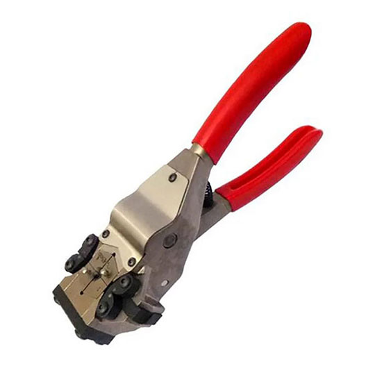

A distinct advantage of cold welding is it doesn’t rely on machines that require large amounts of electricity. Modern cold welding applications use tremendous amounts of pressure applied in a vacuum. The most common usage of cold welding involves a portable, sometimes even handheld, device to join or cold weld copper wire.
cold welding with a hand tool
Cold welding does not necessarily require a press. In some cases, a simple hand tool can provide enough pressure to cold weld two metal wires. Photo courtesy Jieotwice
Cold welding machines vary depending on the materials to be welded and the size and shape of the parts. For instance, a cold welding machine to join copper wires to aluminum parts may be a handheld device. For cold welding larger parts, a large stationary machine may be necessary. In these instances, the metal parts are placed in a die on one side and pressed tightly against the other piece being joined. Under enough pressure, a tight bond at the atomic level is formed between the two metals.
One advantage of cold welding is the small number of tools required. A wire brush, sanding pads or grinding discs, and possibly some cleaning solvents and rags are typically all that is necessary to prepare the parts for joining.

Next, operate the welder. Parts are typically fed into a welding machine from the sides and placed in a die. The pressure brings the metal together so firmly that any gaps in the connection are effectively pressed out, and the parts are so tightly fused together that there is an almost total fusion bond between the two.
Once the bond has been established, the assembly can be removed from the machine. Any surface residue or abnormalities that the welding operation has created should be chipped away. In most cases a small, handheld wire brush will be sufficient for this.
