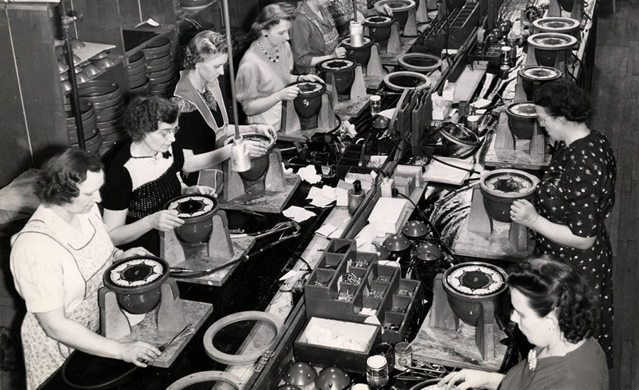

women assembling auxiliary indicators for gyrocompasses used in U.S. Navy ships
During World War II, the Dodge Main factory mass-produced gyrocompasses, in addition to other products. This photo from 1942 shows a group of women assembling auxiliary indicators for gyrocompasses used in U.S. Navy ships. Photo courtesy National Automotive History Collection, Detroit Public Library

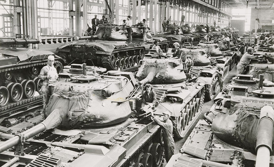

M47 tanks
For decades, Chrysler operated a tank arsenal in Warren, MI, that produced thousands of machines such as these M47s. Photo courtesy National Automotive History Collection, Detroit Public Library

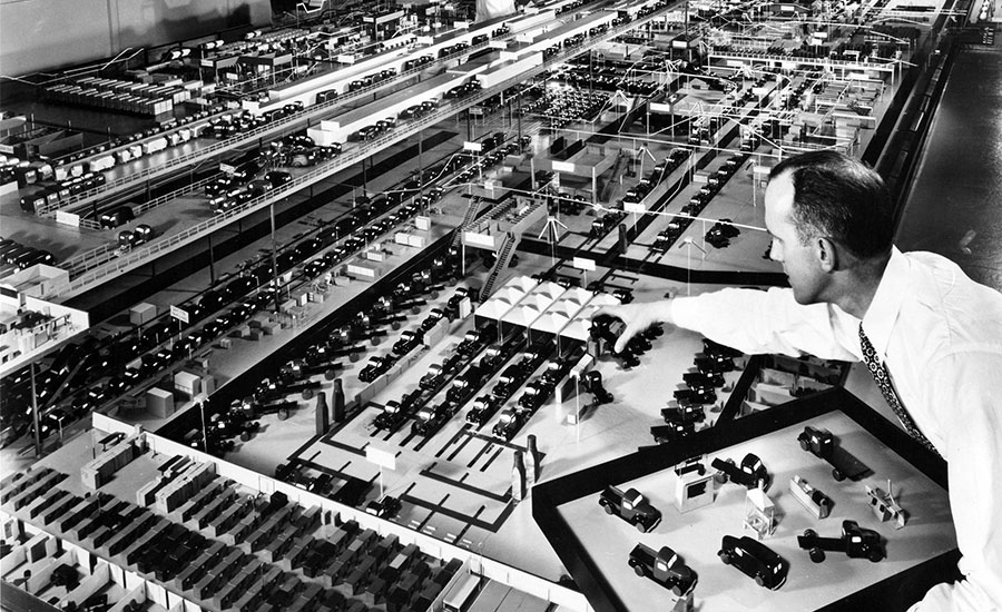

Chrysler engineers use toy models to lay out assembly lines at the Warren truck factory
Chrysler engineers used toy models to lay out assembly lines at the Warren truck factory in the early 1950s. Photo courtesy Stellantis

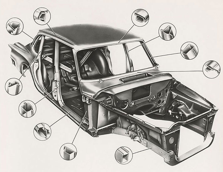

In the late 1950s, Chrysler began secret plans to develop a compact car with a team of more than 200 engineers. The result was the 1960 Plymouth Valiant. It featured a “slanted six” engine that was mounted on a chassis at a 30-degree angle to provide a low center of gravity and a low hood line.
The innovative vehicle also featured a unitized body construction, which eliminated the conventional frame. The unibody provided greater structural strength and interior roominess than was possible with traditional body-on-frame assembly processes.
Box members in the underbody absorbed driving, braking and suspension loads. Structural components such as front fenders and engine-support cross members were bolted on to facilitate servicing and reduce the cost of repairs to damage caused by collisions.
“Resistance to twisting and bending is as much as 150 percent greater than the frame-body designs still used on most other cars,” proclaimed Chrysler in promotional literature. It also pointed out that “the new four-door sedans show a 100 percent improvement over conventional body-and-frame construction in torsional rigidity and a 40 percent increased beam strength.”
Chrysler claimed that the stronger, quieter unibody was the “most significant quality advance in a decade,” with rattles and squeaks eliminated by 6,000 welds.

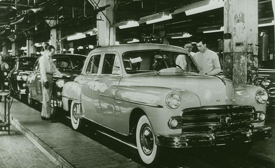

sedans about to roll off the line at the Dodge Main plant
Shiny new sedans are about to roll off the line at the Dodge Main plant in 1950. Photo courtesy AACA Library & Research Center

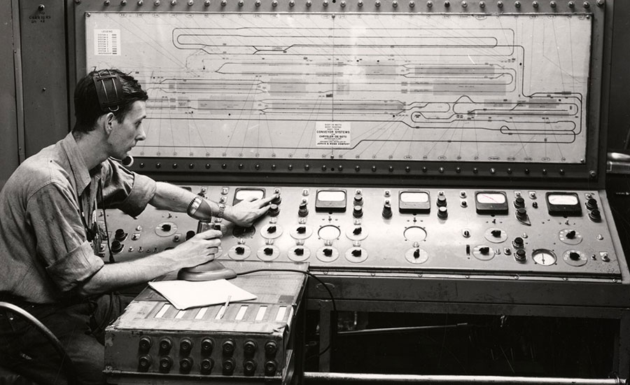

electronic control board regulates conveyors at the DeSoto assembly plant
In the mid-1950s, this electronic control board regulated conveyors at the DeSoto assembly plant in Detroit. By manipulating switches on the state-of-the-art system supplied by the Jervis B. Webb Co., an operator could direct, reverse and redirect every conveyor inside the factory. Photo courtesy National Automotive History Collection, Detroit Public Library

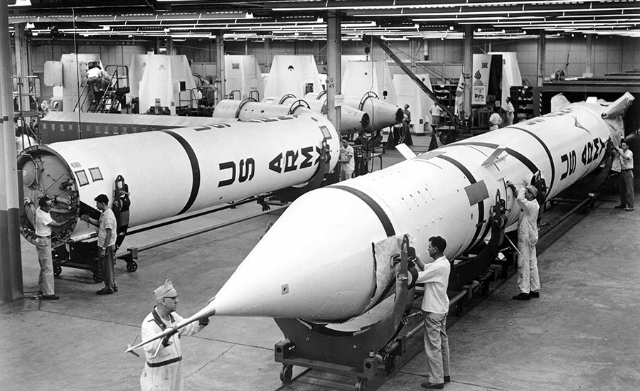

missiles and rockets
During the 1950s and 1960s, Chrysler was a major producer of missiles and rockets. Photo courtesy Stellantis

By 1969, Chrysler was producing 46 boat models and 40 different engines at state-of-the-art factories in Texas, Wisconsin and Ontario.
1961 Dodge Lancer
The 1961 Dodge Lancer featured full unibody construction, which provided greater structural strength and more interior roominess than conventional designs. Some structural components, such as front fenders and engine support cross members, were bolted on to facilitate servicing. Illustration courtesy AACA Library & Research Center

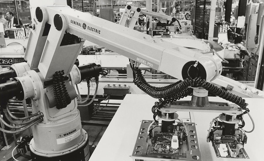

The factory was equipped with robots that assembled and tested spark control engine components used in all Chrysler, Dodge and Plymouth vehicles. The Huntsville operation included 18 robots for loading and unloading electronic components, in addition to vision systems that could identify up to 200 different part numbers. It was Chrysler’s largest robotic installation outside of its automotive assembly plants.

assembly robots in use at Chrysler’s electronics plant in Huntsville, AL
This scene from the 1970s shows assembly robots in use at Chrysler’s electronics plant in Huntsville, AL. Photo courtesy AACA Library & Research Center

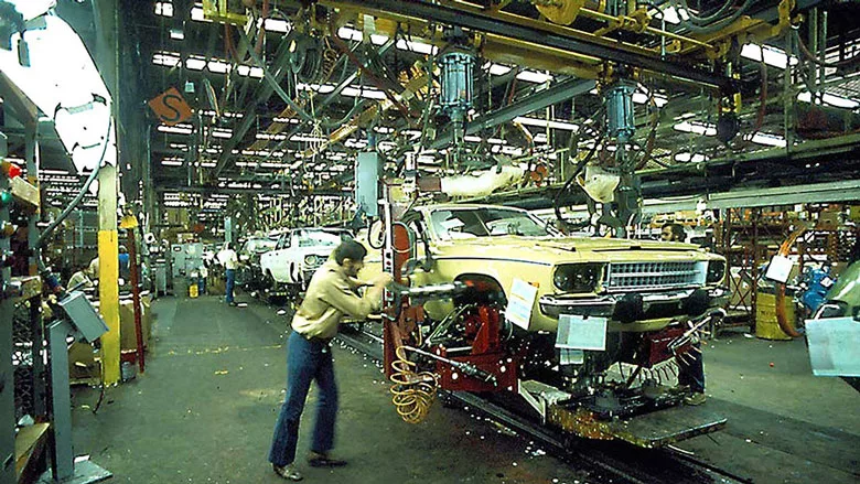

In the late 1970s, Chrysler spent $57 million to renovate its Lynch Road assembly plant. The highlight was 14 Unimate welding robots, which a press release proclaimed were the “first fully automatic welders in a Detroit car assembly plant. When operational, they will make more than 450 welds in bodies that will become the all-new, full-size Chrysler New Yorker and Newport, and Dodge St. Regis automobiles.”
In June 1979, Iacocca announced plans to produce K-cars (front-wheel drive compact vehicles) at the Jefferson Avenue plant in Detroit. Chrysler spent $100 million revamping the aging plant, which was equipped with 90 Unimate welding robots; an automated, modular Comau RoboGate framing system; and a variety of computer-controlled quality control systems.

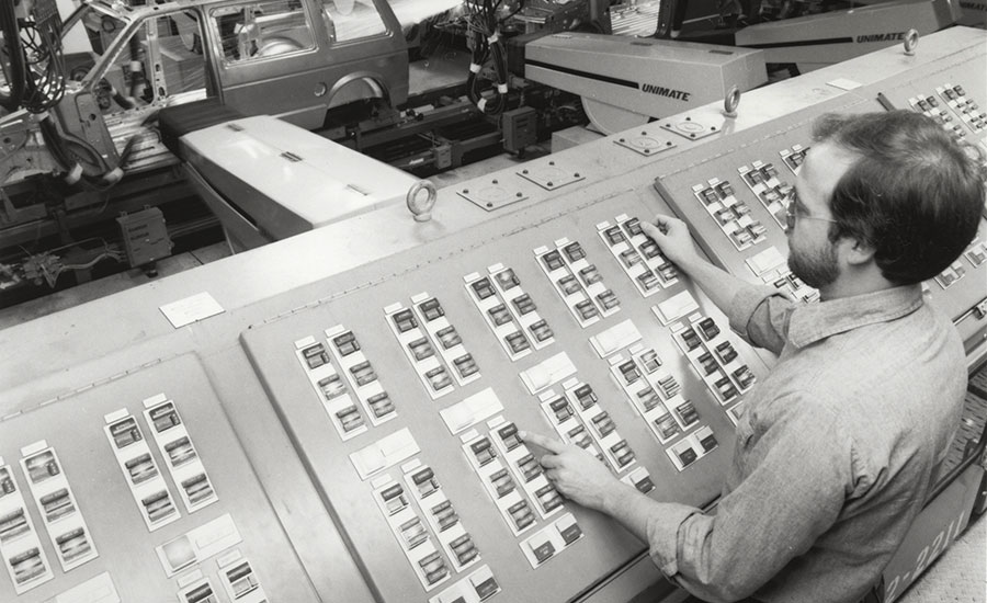

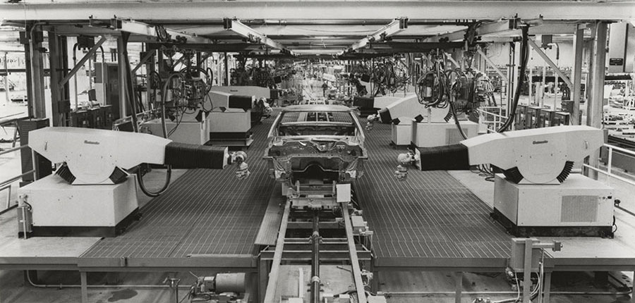

Unimate welding robots at the Lynch Road Assembly Plant
In the late 1970s, Chrysler installed Unimate welding robots at its Lynch Road Assembly Plant in Detroit to produce full-sized New Yorker and Newport sedans. Photo courtesy AACA Library & Research Center

“The new robots do not really look like Frankenstein’s monster, or like Artoo Deetoo in ‘Star Wars,’ but rather like a row of giant birds,” noted an article in the Dec. 8, 1980, issue of Time magazine. “They poke their 9-foot-long, rubber-sheathed necks toward the row of automobile frames. From their beaks, a blinding shower of sparks streams forth. The escape of compressed air creates a loud hissing sound.
“This is Chrysler’s sprawling 145-acre Jefferson plant in East Detroit, where the trouble-ridden firm is building the new K-cars—the Plymouth Reliant and Dodge Aries—that it hopes will save its future. Once 200 welders with their masks and welding guns used to work on such an assembly line.
“Here there are no welders in sight; there are only 50 robots craning forward, spitting sparks. They work two shifts, and the assembly line’s output has increased by almost 20 percent since the robots arrived earlier this year.”
