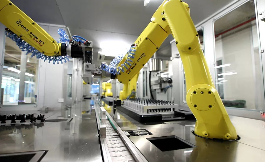

Photo courtesy FANUC America Corp
A new initiative will enable more robots to communicate with each other.
