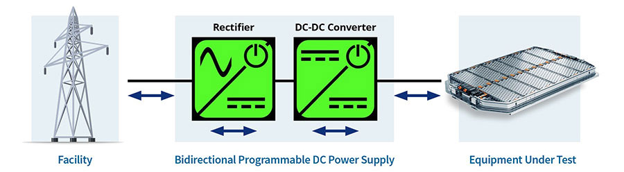

battery test system with bidirectional power supplies
A battery test system made with bidirectional power supplies can draw power from an EV battery and return it to the grid, lowering facility energy costs. Illustration courtesy Ametek Programmable Power Inc.
“The Modular Intelligent-Bidirectional Energy AMplified (Mi-BEAM) allows users to scale with a modular approach,” says Ben Jackson, director of product line management at Ametek Programmable Power. “It includes built-in features to allow for future test needs without having to buy an entirely new system. As users need more power, they just add a new power supply.
“Increased voltage allows for future expansion past the current 1,000- to 1,500-volt EV battery requirements via stackable 37.5-kilowatt-hour building blocks,” explains Jackson. “Mi-BEAM’s modular, regenerative design enables precise control and efficient performance, helping [engineers] accelerate development, while improving safety and sustainability.”
The system also has numerous features to ensure safe testing, such as islanding detection, output isolation, over-voltage protection, over-temperature protection, output current limit protection, reverse polarity detection, and both hardware and software limit controls.

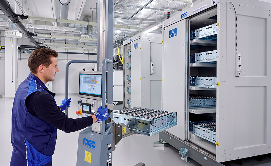

battery cell manufacturing
Battery testing systems that are easy to use and easy to scale enable manufacturers to develop better products. Photo courtesy BMW AG

Jackson: As the industry matures, battery manufacturers are striving to reduce costs by standardizing modules, improving yields and utilizing materials more carefully. One barrier has been battery test equipment that is difficult to scale and use. For example, some test systems are not modular, preventing economic or efficient ability to scale with development. Safety has been another concern. Fortunately, EV battery test systems are emerging that are more foolproof. They feature additional isolation and monitoring capabilities that are easy to use and easy to scale by adding modules.

Jackson: Battery testing requires a bidirectional test system with source-and-sink capability. Such systems have been available for years, but now we see more power-dense and scalable systems. Factory floor space is important. The size of test systems has grown to match the increased power of modern batteries with power-dense test systems consuming less floor space. The systems have also become modular, so the equipment can easily scale with production volume and battery capacity.  In addition to power, test systems must now support greater than 1,000 volts.
At these higher voltages, creating a more efficient test becomes increasingly important not only to reduce R&D costs, but to allow for expanded facility capabilities within the existing electrical footprint. Battery test systems capable of returning power to the grid (bidirectional), rather than dissipating absorbed energy as heat, allow for this by lowering facility energy costs, avoiding the need for additional HVAC infrastructure and improving space requirements.
