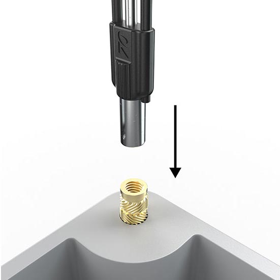

impulse heat staking process - step 1
impulse heat staking process - step 2
impulse heat staking process - step 3
impulse heat staking process - step 4
A specially designed tip delivers a brief and intense pulse of electrical current through a heating element that is tailored to the requirements of the specific application. The heated insert is pressed onto the plastic parts, causing the plastic to soften and flow. Within seconds, the tip is cooled with compressed air, allowing the plastic to rapidly cool and solidify. Photo courtesy U.S. HeatStake
Impulse heat staking simplifies installation of brass inserts by generating heat only when needed and keeping the cycle consistent from part to part. Real-time depth verification adds straightforward confirmation of final insert depth and insert presence—so the system can abort before heating if an insert is missing.

Impulse heat staking uses heat “on demand.” Instead of a continuously hot tool or a process that soaks the surrounding plastic, heat is generated only during the portion of the cycle where it contributes directly to installation. This helps keep the process consistent and reduces surprises associated with excessive heat exposure.
A specially designed tip delivers a brief and intense pulse of electrical current through a heating element that is tailored to the requirements of the specific application. The heated insert is pressed onto the plastic parts, causing the plastic to soften and flow. Within seconds, the tip is cooled with compressed air, allowing the plastic to rapidly cool and solidify. The heating element is then retracted with no risk of sticking or stringing.
