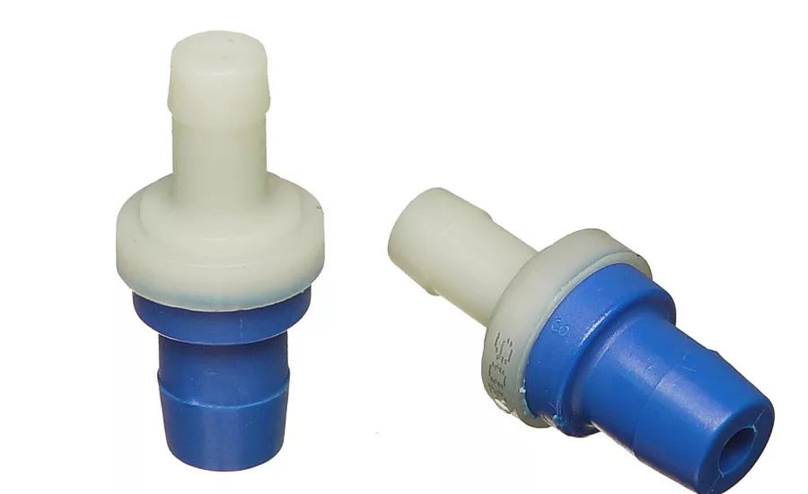

Automotive PCV (positive crankcase ventilation) valves appear to be such simple devices. They’re small, with only one moving part and a spring inside. Nevertheless, they must meet surprisingly rigorous performance specifications to win approval from OEMs. Valve suppliers must document that every valve design will reliably permit specific amounts of airflow at specific vacuum levels.
For Novo Products Inc., satisfying these requirements went beyond learning new techniques for vacuum and flow testing. When customers began requesting test data on prototypes presented in graphic form, we had to find test capabilities that no known instrument could provide. We ultimately met that challenge—and cut design time significantly—with a customized combination of mass-flow leak-tester and PC-based test-networking software.
No stranger to stringent component specifications, Novo has been serving the automotive industry since 1973. The company has built itself into a leading Tier 2 and Tier 3 supplier of emission control devices, fuel delivery components and electronic engine controls, and it has earned ISO and QS 9000 certification along the way. When the opportunity to solve one automaker’s PCV valve failure problem came along in 1999, we sensed a long-term business opportunity. These inexpensive parts offered the potential for high-volume sales. Today, Novo produces more than 4 million PCV valves per year in seven designs.
Flow testing is vital because PCV valves must relieve engine crankcase pressure correctly to prevent backfiring or blown gaskets and seals. To do this, they regulate pressure outflow from the engine by means of a tapered poppet moving in and out of a tapered orifice. The orifice outlet is connected by tubing to the engine’s air-fuel intake. Vacuum generated by the air-fuel intake modulates the poppet. Spring tension holds the poppet open when vacuum is low, but allows increasing vacuum to gradually pull the poppet closed. When the poppet is open and engine gases are venting, the tubing and low vacuum channel those emissions back into the air-fuel intake so they can be reburned rather than vented to the atmosphere as a pollutant.
Each engine design has a different relationship between the amount of vacuum and the amount of crankcase pressure allowed to vent. That relationship, in turn, requires each PCV valve design to have a unique balance among the geometry of the poppet and orifice, the force of the spring, and the level of vacuum.
Customer specifications define the valve’s external size and shape, along with flow values desired at designated vacuum levels, termed "delta points." For PCV valves, vacuum typically ranges from 1 to 20 inches of mercury, while flow values might be anywhere between 0.2 and 8 cfm. Novo engineers are left to determine the internal design needed to achieve the desired performance.
