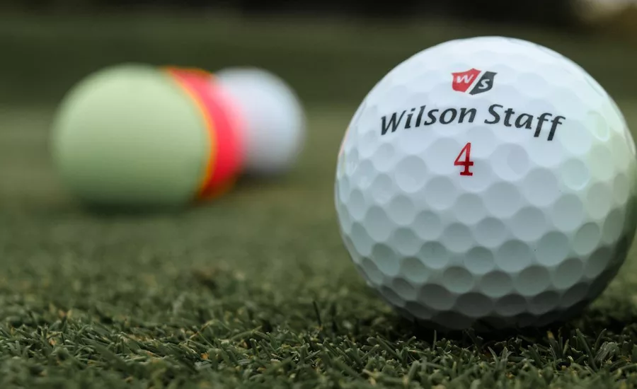

Mention dimples to an avid golfer, and he won't think of his daughter's winning smile. He'll think of golf balls.
Golfers love golf balls. Serious golfers can discuss differences in core compression and cover hardness, and they'll staunchly defend why their ball of choice improves their game.
That obsession with golf balls is one reason Wilson Sporting Goods produces 16 types of golf balls by the millions each year. That's a lot of balls-enough to make Doug Sellers, a senior manufacturing engineer at Wilson's plant in Humboldt, TN, want to lower costs by automating the golf-ball packaging line.
