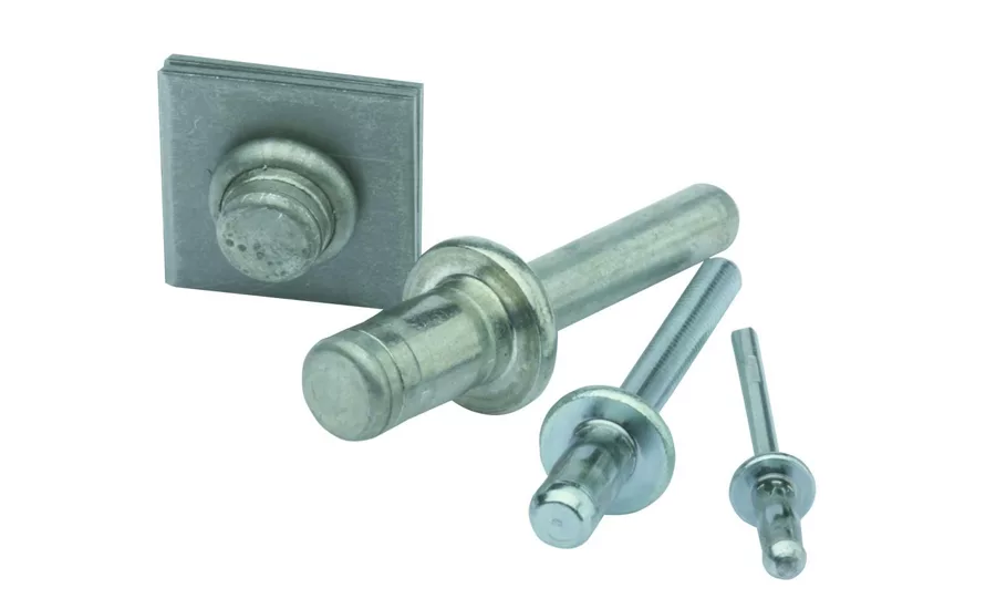

Joining dissimilar materials has long posed a challenge for design engineers. However, by combining different technologies such as adhesive bonding and mechanical fasteners, manufacturers can create strong, rigid assemblies that incorporate the best of both worlds.
Hybrid joining comes in many different forms, but is typically defined as "the combination of two or more joining techniques to produce joints with properties additional to those obtained from a single technique," says Ewen Kellar, principal project leader of the polymers group at The Welding Institute (TWI, Cambridge, England). "The most common types of hybrid joints are used for joining sheet materials and involve an adhesive in conjunction with a single-point joint technique, such as a rivet."
According to Kellar, techniques such as riv-bonding have been successfully used to join aluminum sheets in aerospace and automotive applications. Typically, an adhesive is applied to the surfaces to be joined prior to assembly. The parts are then joined with rivets. Compared to joints made only with rivets, riv-bonding offers benefits such as:
  • Continuous, leak-tight joints.
  • Higher-strength joints.
  • Increased joint stiffness.
  • Improved peel and impact resistance, because crack growth away from the joint is arrested by the adhesive bond.
"Although purists may argue that a high quality, all-bonded structure is aesthetically and structurally superior, or that a bolted structure is the simplest and most effective solution, both approaches have their shortcomings," Kellar says. "The hybrid joint offers the benefits of both systems in that the number of fasteners can be reduced significantly, thereby reducing the effect of hole damage and increasing the fatigue resistance of the structure....The fasteners that remain can act as a backup mechanism in the event of significant adhesive failure."
When riv-bonding, the presence of adhesive does not change the basic setting operation. But, it may influence the setting parameters and the load-displacement characteristics. Adhesives can also have a lubricating effect on the riveting process, a variable that needs to be taken into account during rivet and die selection, says Michael LaPensee, vice president of applications and marketing at Henrob Corp. (Novi, MI).
To reduce cycle times and prevent contaminating riveting tools with adhesive, engineers at TWI have developed a new hybrid riveting process called AdhFAST. This system is unique in that components can be assembled dry, checked for tolerance and then injected with adhesive at the final stage.
"This ensures a simplified process with increased quality control, maximizing the benefits of hybrid joint technology," says Steve Westgate, technical specialist in TWI's laser and sheet processes group. "Adhesive dispensing can be metered, with minimal wastage, making the process cleaner, with resultant health, safety and economic benefits."
According to Westgate, the adhesive is injected into the joint through specially designed fasteners. The fasteners also incorporate a means of controlling the spacing between the top and bottom substrates.
"This gives greater control of bond-line thickness and, therefore, improved process reliability and joint quality," he says. "The AdhFAST fastener can be either in the form of a specially designed component or, in some cases, a standard commercial fastener to which some modification has been made."
