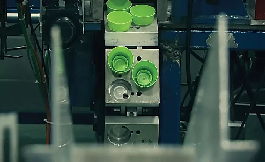

The LFA precision-link conveyor accurately moves detergent bottle caps into position so vented liners can be quickly inserted. Photo courtesy Motion Index Drives

A micro-porous vented liner, such as that made by M-Industries LLC, can relieve this internal pressure when inserted into the detergent bottle cap. The liner allows air to flow through the cap but does not allow the liquid to escape.
According to Karlis Mateus, president and founder of M-Industries, developing the liner proved to be much easier than placing the liner into a bottle cap. For quite awhile, the company struggled to find the right equipment that would automatically place a liner with precision and repeatability.
That all changed in spring 2012 when Mateus came upon the LFA precision-link conveyor from Motion Index Drives. This conveyor became the main piece of equipment on M-Industries’ bottle cap assembly line, and remains so nearly four years later.
“The conveyor moves each cap quickly, efficiently and accurately into the place where the liner gets inserted,” says Mateus. “It has done everything Motion Index Drives said it was going to do. What was promised and what was delivered is very consistent.”
All chain links in the conveyor are made of precision-machined aluminum. They are driven by a high-performance drive unit consisting of a rotary index drive, bevel gear reducer and brake motor. Hardened dual-drive sprockets ensure precise, backlash-free motion between the drive unit and chain links. Each conveyor link engages to a hardened and ground steel track with four cam followers. Straight conveyor sections are made of extruded aluminum and available in any length. The conveyor’s center frame can be designed with holes, cutouts or pass-throughs.
