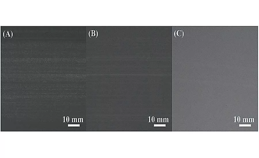

Different scratch traces can be generated based on the geometry and composition of the scratching tool. Which to choose depends on the material being tested and the use conditions to be simulated. Each of these scratching tool geometries may produce different mechanical deformations: a small ball point. Photos courtesy Taber Industries

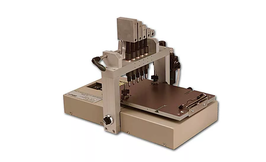

This apparatus involves a pneumatically driven sled and five “fingers” that can be tipped with either 1-millimeter scratch pins or 7-millimeter mar tips. Each finger is loaded with different weights, so each exerts a constant, vertical force on the test surface, ranging from 0.6 to 25 newtons. After lowering the tips onto the specimen surface, the platform moves under the fingers at a speed of 100 millimeters per second. Photo courtesy Taber Industries

While laboratory tests cannot exactly duplicate the wear-and-tear mechanics of real life, a controlled test allows engineers to at least approximate field conditions and evaluate materials with consistent criteria. This approach can provide considerable insight into the factors that contribute to a material’s performance. Lab testing is particularly important when there are many opportunities for damage to occur, from manufacturing to shipping to actual use.
Scratching is defined as the relatively deep penetration of a solid by an edge or protuberance moving along its surface. Marring describes relatively fine, shallow surface scratches, distributed over a large area, that spoil the overall appearance of the material or coating.

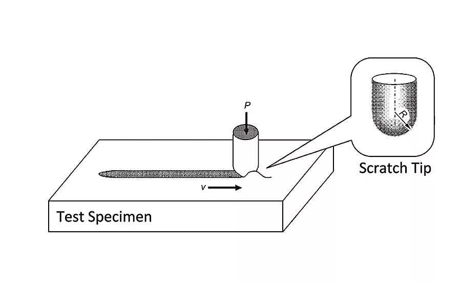

In a laboratory scratch test, a stylus with a defined geometry is drawn across a specimen at a known speed and force. A mar test might use a material, such as steel wool, to produce damage over a greater area. Either way, the objective is to determine the behavior of the material under specific test conditions; establish a relative ranking of similar materials; or establish the failure limit of the material or coating. The ultimate goal is to simulate damage that might occur during normal usage, handling, shipping or manufacturing.
Attempting to re-create scratch damage in a laboratory involves a complex combination of interrelated properties. The purpose of the test is to predict the performance of a material in a standardized way. Yet, when engineers try to correlate test processes with the conditions a product is exposed to during its life, they quickly realize the task of developing a test methodology is both multifaceted and difficult. In fact, a series of tests may be required to isolate key material properties.
The amount of scratch damage created by an instrument depends on many variables. For example, different scratch traces can be generated based on the geometry and composition of the scratching tool. Each of the following tools produces different deformations: a 1-millimeter spherical ball (hardened stainless or tungsten steel); a conical diamond; a cube corner; a pyramid; a cylinder sectioned at 45 degrees to the axis; or the radiused edge of a paper clip. Variation can also be introduced by the load applied to the tool or the speed at which the tool is drawn across the specimen surface. Material properties—such as surface roughness, hardness, modulus of elasticity, texture, grain, gloss level and coating thickness—can also influence the severity of scratch damage.
Once a test procedure is identified, the process of generating a scratch is relatively simple. However, trying to evaluate and describe the result is not always easy. Many of today’s plastics have viscoelastic properties, and the stresses in the plastic may relax during loading. Plus, plastics may demonstrate an elastic recovery after applied stresses are removed, so scratch width, groove depth, displaced material, and severity of damage may change over time. Other issues that affect the visual perception of scratches include the color of the sample; the amount of strain whitening; scratch direction; lighting and viewing conditions; and how much time an observer spends viewing the sample.

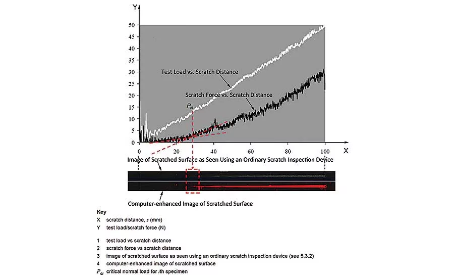

Nano-scratch testers are offered by a number of companies. This instrument performs a series of scratch tests with a stylus moving linearly over a surface under a constant load. The goal is to find the load at which the coating fails. Alternatively, a progressive load can be applied. In this case, the load is gradually increased until failure occurs.
Either way, at the moment of failure, the normal force, tangential force and acoustical emission are recorded. This enables the force fluctuations along the scratch to be correlated with failures observed under a microscope. This type of instrument offers the precision to differentiate between cohesive failure within the coating and adhesive failure at the interface of the coating and the substrate. Depth information can also be measured before and after the scratch. This provides information on plastic vs. elastic deformation during the test. 3D imaging and other options are available to assist with analyzing test results.

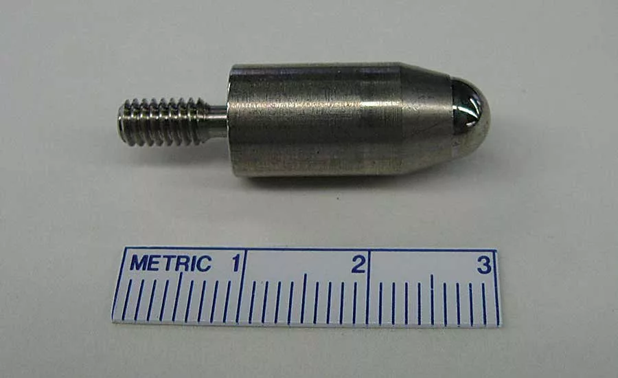

The Scratch Hardness Tester 430P from Erichsen GmbH permits testing of single cuts, parallel cuts and crosscuts. During the test, the specimen is conveyed linearly at a constant speed under the test tip, which has been set at a specific pressure (40 newtons maximum). A transmission guide ensures the test tip is lowered onto the test panel consistently. The test is carried out automatically and all parameters (cutting speed, cutting stroke and crosscut pattern) can be set using a keyboard. Each motion sequence (transport of test panel, cut positioning and pressure adjustment) is driven by a separate step motor.
The instrument is widely used for crosscut testing to evaluate adhesion properties. When used as a scratch tester, the instrument can measure plastic deformation, differences in brightness, and material removal (chipping).
The typical setup uses a tool (1 millimeter in diameter) that scratches a grid with spacing of approximately 2 millimeters onto a painted or unpainted plastic surface. For unpainted components, the load is 5 or 10 newtons, depending on the part and its use. For painted components, the load is normally 10 newtons. Each scratch is produced by one movement in one direction at a speed of 1,000 millimeters per minute. A colorimeter is then used to determine the chromatic aberration in relation to the unscratched surface.
This instrument is also available with the option to generate crosshatch cuts with graduated test forces. Or, the test can be performed using a disc with a rounded edge and a force of 7 newtons. In this case, the flattening of the microstructure of the test surface may change its gloss.

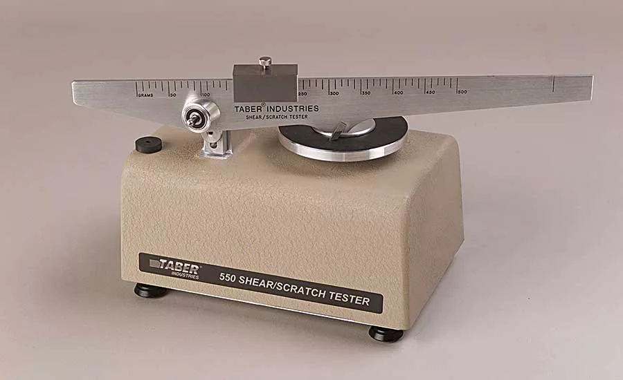

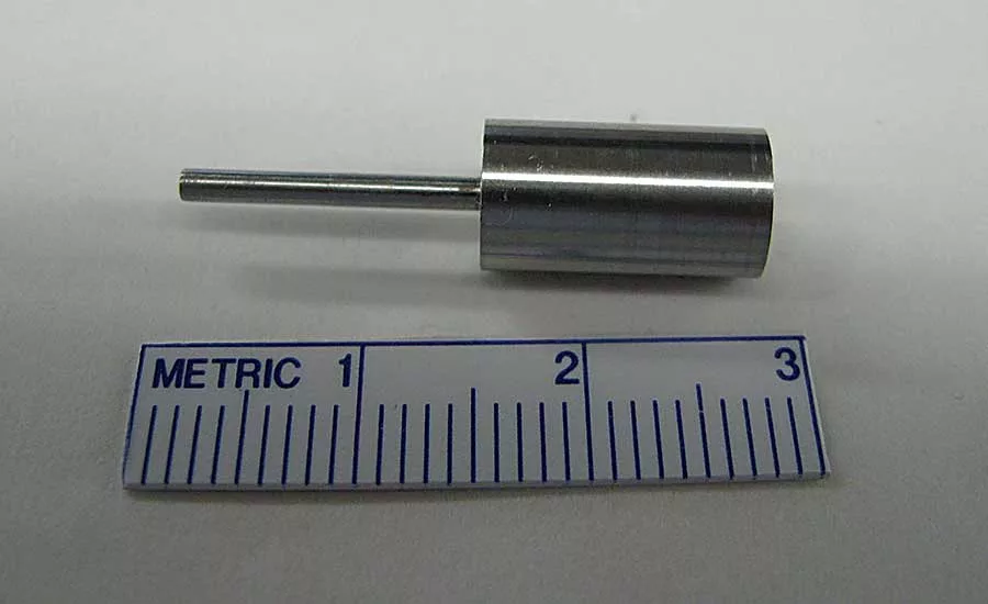

Coating manufacturers use the Taber Shear and Scratch Tester to measure a material’s resistance to gouging, scratching, engraving or shearing. A precision diamond tool is affixed to a balanced scale beam. Test pieces are mounted to a turntable, which rotates at a constant speed. By changing the position of a sliding weight, loads from 0 to 1,000 grams can be applied to the cutting tool. The test determines the minimal load to produce a continuous mark on the coating surface. By changing the position of the scratch tool on the test specimen, the operator can create a series of circular scratch marks. The depth of the scratch marks can be reduced from one line to the next by reducing the load, up to the point where no scratch mark remains visible or is noticeable under an accepted definition. This makes it possible to identify small differences in scratch resistance.

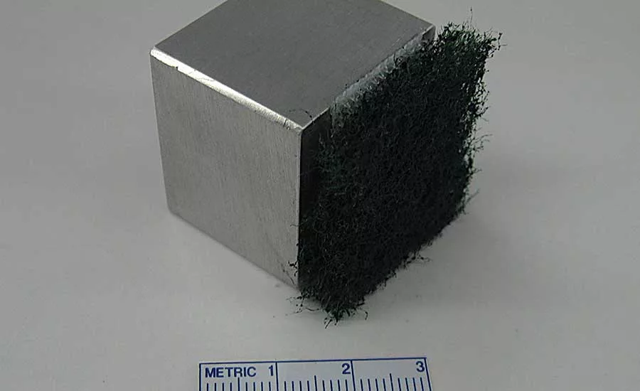

The Rotary Steel Wool Test Instrument involves rotating a weighted 1.25-inch-square steel wool pad under a load of 24 psi or higher (in some cases more than 50 psi). The pad is usually rotated 25 times at speed of 60 rpm, creating a circular wear or scratch pattern. To reduce variation, steel wool from the same supplier should be used with all tests.
The scratch resistance of the material is determined by visually comparing test samples to a reference sample at a distance of no less than 300 millimeters. The samples are viewed under a 1,000-lux light source. When testing transparent plastics, engineers can measure the difference in the transparency of the material before and after the test, or they can measure the percent change in haze (ASTM standard D-1003).

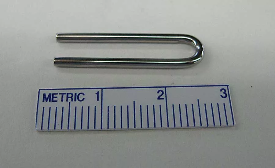

A popular instrument for automotive plastics is the Five-Finger Scratch and Mar Tester. Originally developed by Ford Motor Co., this apparatus involves a pneumatically driven sled and five “fingers” that can be tipped with either 1-millimeter scratch pins or 7-millimeter mar tips. Each finger is loaded with different weights, so each exerts a constant, vertical force on the test surface, ranging from 0.6 to 25 newtons. After lowering the tips onto the specimen surface, the platform moves under the fingers at a speed of 100 millimeters per second to generate scratch damage.

In some cases, more sophisticated tools may be required to measure scratch parameters, such as the reduction in gloss, increase in haze, or amount of material removed. Many nano-scratch testers have sensors that allow the
operator to determine when a critical condition has been reached. Other instruments measure the friction between the stylus and test material, indicating the amount of energy dissipation that is occurring during scratching. Although they may be of limited use with soft, ductile materials, acoustic sensors can detect the onset of gross micro fractures or coating delamination.
