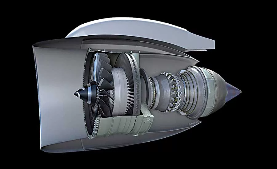

Ceramic matrix composites are ideal for jet engine applications, because they can withstand higher temperatures than metal alloys. Illustration courtesy Hexcel Corp.

CMCs are made of coated ceramic fibers surrounded by a ceramic matrix. They are tough, lightweight and capable of withstanding temperatures 300 to 400 F hotter than metal alloys can endure. Because of those qualities, they are ideal for jet engine applications.
Engineers at CFM International recently turned to CMC when they designed the new Leap engine, which is used on next-generation Airbus A320neo and Boeing 737MAX jetliners. It features a CMC turbine shroud so that the engine can operate at up to 2,400 F.
By keeping more heat inside the engine, commercial jetliners can use less fuel and emit fewer emissions. The CMC component also needs 20 percent less cooling air than traditional nickel or titanium super alloys.
Engineers at GE Aviation are currently developing a jet engine that will contain five CMC parts—two combustor liners, two nozzles and one shroud. The GE9X engine will power Boeing’s next-generation 777X jetliner.
