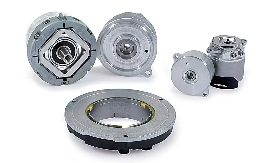

Classic rotary encoders like these continue to provide servomotor feedback at the robot’s axes. However, these encoders must be able to resist vibration and electromagnetic interference. Photo courtesy Heidenhain Corp.

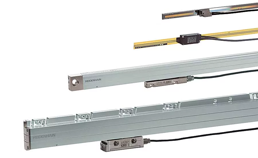

For highly accurate positioning of robots with a linear drive, enclosed linear encoders are available in lengths of up to 30 meters. Photo courtesy Heidenhain Corp.

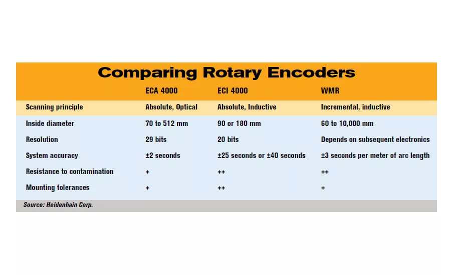

Comparing Rotary Encoders

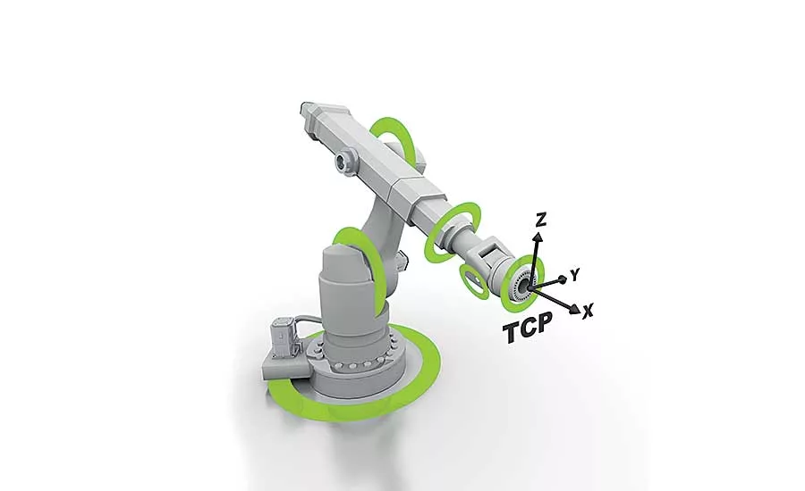

However, for these kinds of applications, the tool center point (the tool at the end of the robot’s arm) must be positioned and guided with sufficient accuracy. This is where the classic industrial robot runs up against its limits. Deviations result from a variety of factors.
To achieve the desired level of maneuverability, robots with serial kinematics are required, such as articulated robots with six axes. Each one of these axes is driven by a servomotor with a gear train. Zero position error, backlash and joint elasticities are the main sources of inaccuracy. Applied forces and dynamic effects during the machining process affect the rigidity of the robot’s mechanics and negatively influence the absolute position accuracy.
Thanks to advanced calibration methods, it is already possible to move a tool center point to a certain position repeatedly to within several hundredths of a millimeter. Depending on the manufacturer, the repeatability of articulated robots as per ISO 9283 is ±0.1 millimeter or better.
However, when compared with repeatability, the absolute position accuracy that can be achieved within the robot’s coordinate system is worse by a factor of ten. Depending on their design, maximum range, and maximum load capacity, articulated robots currently achieve an absolute position accuracy of ±1 millimeter. This is insufficient for meeting the accuracy requirements of industries such as the aerospace sector. Yet robot manufacturers have been responding to this problem.

Classic rotary encoders continue to provide servomotor feedback at the robot’s axes. Because servomotors require high control dynamics, robust inductive rotary encoders, such as the ECI 1100 and 1300 series, or multiturn models like the EQI 110 and 1300 series, are ideal for this type of application. These encoders deliver high control quality and system accuracy, and they resist strong vibrations. Since these encoders feature a purely serial EnDat interface, even applications exposed to strong electromagnetic interference do not impair data transfer quality or safety.
These inductive rotary encoders support safety integrity level SIL 2, category 3 PL d. They can even attain SIL 3, or category 4 PL e, if additional measures are taken on the control side. These encoders also provide the added safety advantage of mechanical fault exclusion against the loosening of the shaft and stator connection. With this safety package, these inductive rotary encoders can also be used in systems designed for human-robot collaboration.

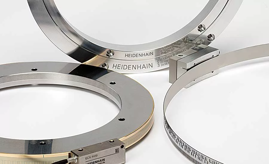

Secondary Encoders for Accurate Measurements
Robot manufacturers can significantly improve the absolute position accuracy of their robots by using additional, high-accuracy angle encoders or rotary encoders at every robot axis. These so-called secondary encoders, which are mounted after each gear train, capture the actual position of every robot joint. This allows the encoders to account for zero position error and backlash. The retroactive forces on each axis resulting from the machining task are measured, as well. All of this results in a 70 to 80 percent improvement of the absolute position accuracy at the tool center point.
Modular angle encoders, such as the ECA 4000 with optical scanning, the ECI 4000 rotary encoder with inductive scanning, and the AMO WMR angle encoder, are well-suited for these applications. Thanks to their modular design with a scale drum or scale tape and a separate scanning unit, these encoders are well suited for large hollow-shaft diameters and for the challenging installation requirements often encountered in robots due to space constraints. The signal quality of these secondary encoders is considerably better than that of the rotary encoders on the servomotor, meaning that the returned position values are significantly more accurate—even for highly dynamic movements.

To reach all of the machining positions on very large or long components, such as an aircraft fuselage or for
manufacturing large composite fiber components, robots can be moved along the length of the component on linear axes. For highly accurate positioning of robots with a linear drive, enclosed linear encoders are available in lengths of up to 30 meters. Position measurement from a linear encoder compensates for thermal errors and other factors that influence the feed mechanisms. These factors cannot be captured by means of conventional position detection methods based on the pitch of the recirculating ballscrew and the angular position of the rotary encoder on the motor.
