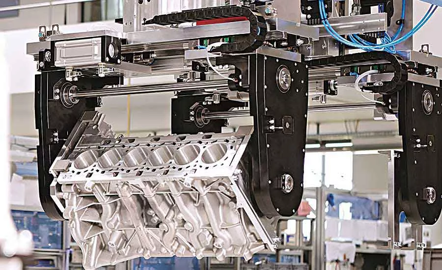

Automotive manufacturers use SBZ swivel jaws to lift, transport, rotate and set down large components. The jaws feature a dual rack-andpinion rotary mounted on each gripper finger. Photo courtesy Zimmer Group U.S. Inc.

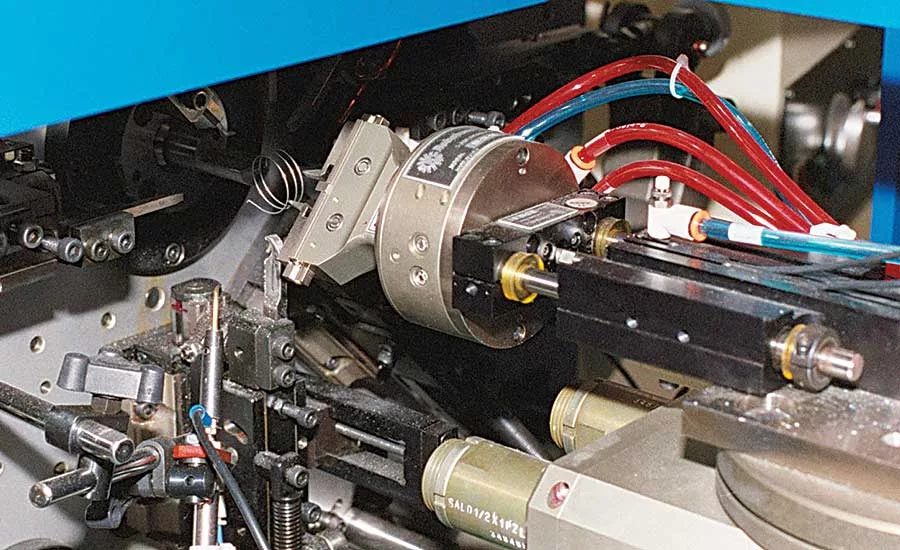

This image shows a combination rotary, gripper and linear slide performing part loading and unloading. Photo courtesy Destaco, a Dover Co.

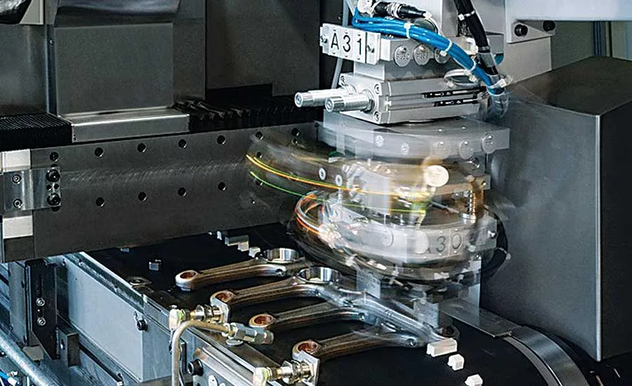

Pneumatic rotaries with a dual rack-and-pinion design produce much more torque than units with a single rack and pinion. Photo courtesy Festo Corp.

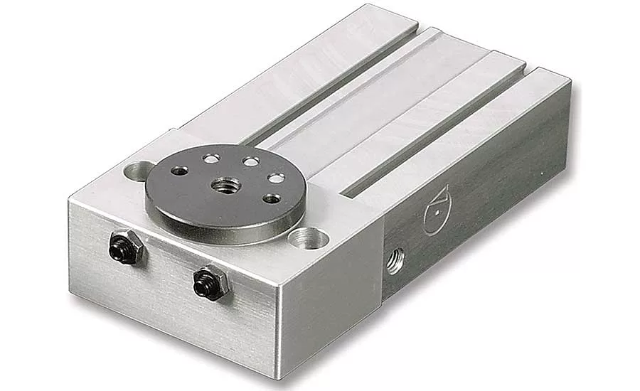

The low-profile pneumatic RCC rotary is driven by an aircraft-quality steel cable and rotates 90 and 180 degrees. Photo courtesy PHD Inc.

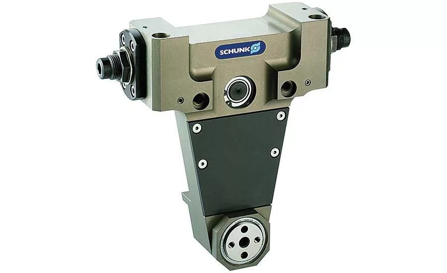

GFS swivel fingers are able to turn workpieces that are held by a gripper. Photo courtesy SCHUNK Inc.

Zimmer Group U.S. Inc. offers the SBZ series of swivel jaws, with a dual rack-and-pinion rotary mounted on each gripper finger. Charalambous says that manufacturers in automotive, white goods, medical devices and consumer goods have used the jaws for several years to lift, transport, rotate and set down small, medium and large parts. Five sizes of jaws are available, with a torque per jaw of 1.2, 3.5, 10, 23 or 57 newton-meters. Swivel angle capability is 90 and 180 degrees. The jaws are rated for 10 million maintenance-free cycles.

Another type of pneumatic rotary actuator is one driven by a cable, such as the RCC model offered by PHD Inc. Carey Webster, senior segment manager at PHD, says an aircraft-quality steel cable is used to drive the unit in two standard rotations (90 and 180 degrees). The actuator has a low profile for confined spaces, but produces high axial thrust loads for its size. Typical applications include light part rotation, electronics assembly and labeling.

“The dual rack-and-pinion design produces much more torque than the single style, and with no backlash,” says Charalambous. “It’s analogous to the difference between trying to rub a stick with one hand or both hands. Your hands are the racks, and the stick is the pinion.”

SCHUNK makes the pneumatic GFS swivel finger for turning workpieces that are held by a gripper. Standard features include a single rack-and-pinion rotary and a pressure maintenance valve that enables the GFS to hold its position even in case of pressure failure. Standard swivel angles are 90 and 180 degrees, with other angles available on request. Several series are available (16, 25, 32, 40), enabling manufacturers to grip parts that range in size from large engine blocks to tiny PCBs.
