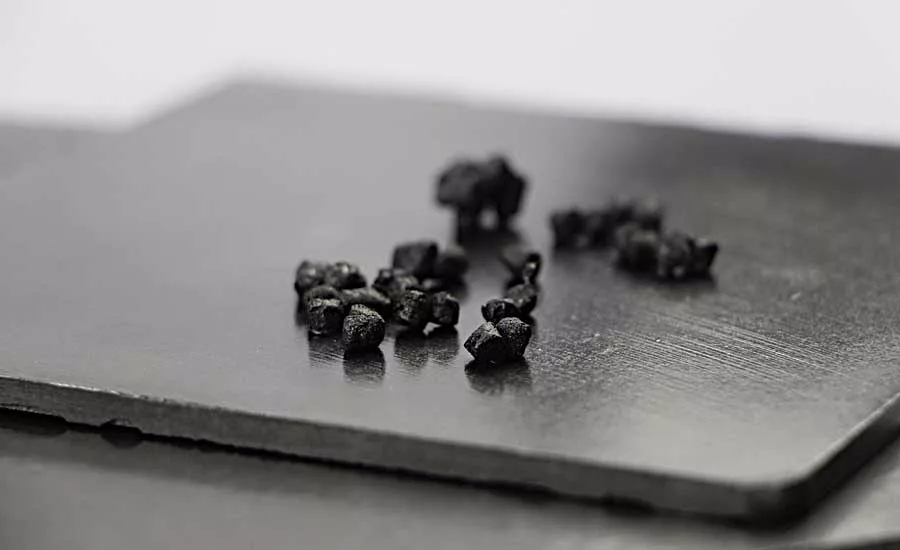

A new manufacturing process uses recycled, small chopped carbon fibers (top) to produce bipolar plates (bottom) for batteries.

Seiler and her colleagues developed a process that enables carbon fibers to be recovered from the plastic matrix. They use microwave radiation to burn the plastic matrix that surrounds the fibers. The combustion has to be performed without oxygen so that the fibers don’t burn up at temperatures of up to 900 degrees C.
“This is called pyrolytic decomposition,” says Seiler. “The advantage of microwave radiation is energy efficiency. A whole oven no longer needs to be heated—just the component itself.
“Our polymer engineers embed the recovered fibers in thermoplastic material,” explains Seiler. “This composite material has similar properties to graphite and is suitable for the production of bipolar plates.
“Our prototype passed all the tests for conductivity, density and corrosion resistance perfectly,” claims Seiler. “We’ve proven that it’s generally feasible to use recycled CFRP fibers to produce bipolar plates for batteries and fuel cells. This shows that recycling works in a holistic approach.
“The next steps are the characterization of the bipolar plates in the battery cell network and studies concerning the life cycle assessment,” says Seiler. “Then, we want to tune the technology so that we can manufacture bipolar plates from recycled CFRP in series.”
