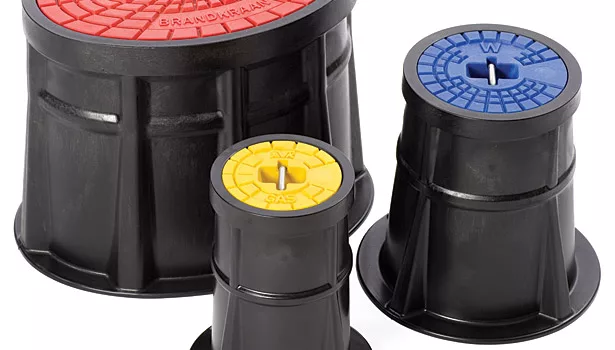

external valves black

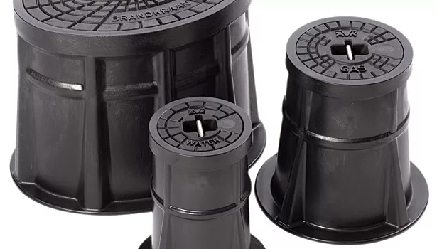

external valves color clips
Plastic cover for external valves: weight reduction as compared with cast iron facilitates assembly and annual maintenance and provides protection from theft or corrosion. The color helps clearer identification of functions and, if necessary, permits signal transmission. Clips prevent the cover being removed too easily and the use of plastic makes it simple to apply a logo.

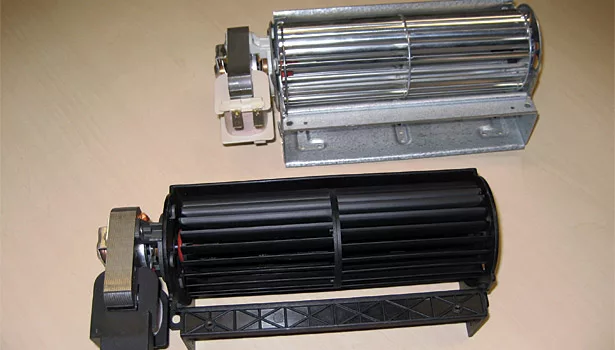

plastic fan metal fan
Figure 2. In the plastic version of the fan, thirty components became three. Operations such as stamping, bending, welding and counterbalancing were no longer necessary, while weight was reduced, tolerances improved, and corrosion and noise generation minimized.

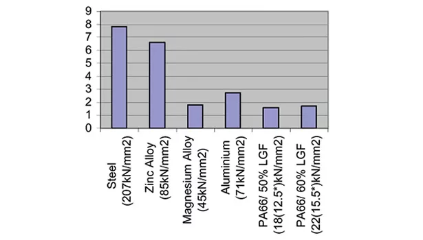

bar chart steel plastic zinc alloy
Figure 4. Material comparison: metals have both a higher material density and higher elastic modulus. To achieve the required tensile strength despite this, it is important to follow the principles of correct plastics design.

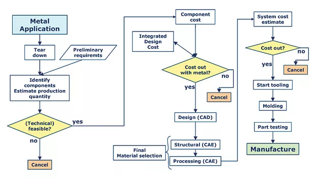

flow chart metal vs plastic
Figure 7. Influence of material selection on factors in the product development process.

Product Concept and Customers
Metal replacement projects should pass through the following phases in the product development process: definition of primary aims, product conceptualization, analysis of feasibility and potential savings, material selection, consideration of requirements and application of correct plastics design principles, design optimization through theoretical and practical mold filling studies, and evaluation of material suitability through test specimen and component testing.
Definition of customer requirements: A market trend analysis, comparison with the competition and step-by-step dismantling of an existing product can help to formulate primary objectives. In this process, it is important that a team of product developers and material and product specialists analyze the function of the individual parts and their present design, manufacture, assembly and finishing with a view to cost reduction.
Product conceptualization: Ideas for design alternatives, metal replacement, component integration and function combination or simplification of finishing and assembly operations for the components can be generated in a brainstorming session and evaluated with respect to their feasibility and the amount of potential savings.
Material selection: Once the decision about a certain component has been taken, it is time to select the plastic. In the case of metal replacement, this in itself severely limits the number of possible material options because of strength requirements, glass- or carbon-fiber-filled engineering thermoplastics are generally chosen instead of unfilled resins. Modification with steel fibers improves shielding against electromagnetic radiation. Assuming correct plastics processing, long glass or carbon fibers increase material stiffness and strength in comparison with standard fibers, which makes them of interest for components subject to very high long-term mechanical loads. To ensure that important material requirements are not overlooked, it is advised to determine requirements systematically with a checklist, and then carefully take them into account.
In practice, it seems that the benefit of early material selection in terms of system costs is often underestimated, if product design, mold construction, and production and finishing processes would have been adapted to the material.
Design & engineering: When materials have been identified as candidates for the design concept of the component, a computer model can be generated using computer-animated design and engineering. The mold design is developed according to correct plastics design principles to ensure material flow into the mold takes place with the least possible stress. Measures such as suitable location and dimensioning of the gate, radiusing in preference to sharp edges, the avoidance of abrupt wall thickness transitions and material accumulation to minimize sink marks and warpage, and the use of snapfit joints, clips or ultrasonically placed inserts instead of screws can help achieve this aim.
Component optimization: Material behavior during processing and in service can be predicted by computer simulation, if suitable material data is available on viscosity, thermal stability, and strength and processing. By this means, the suitability of the thermoplastics in question can be assessed and the position of weld lines and possible air entrapment can be optimized by modifying gate position and wall thickness geometries. Short material residence times in the screw, moderate injection rates and low pressures reduce material degradation during processing help extend component service life. In addition mold filling and demolding behavior due to optimized design and skilled material selection can lead to faster cycles and increased productivity in the production process.
