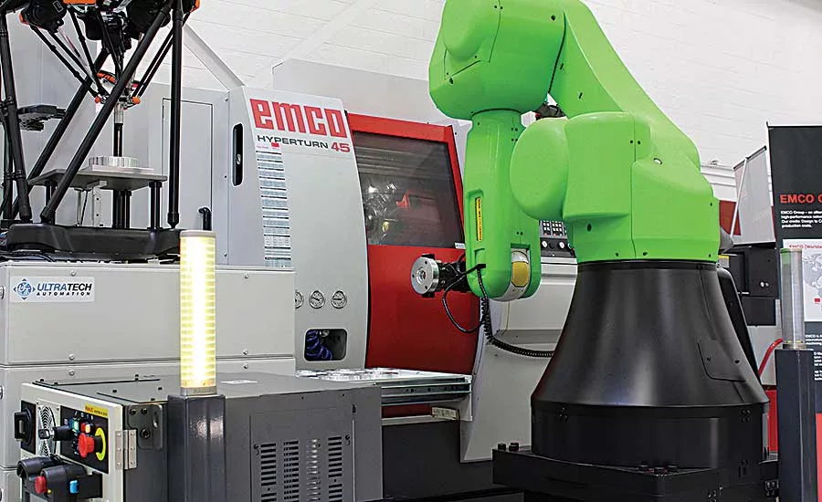

The ideal application for a cobot is one in which it functions as a rote assistant to a human worker. Photo courtesy Ultra Tech Automation

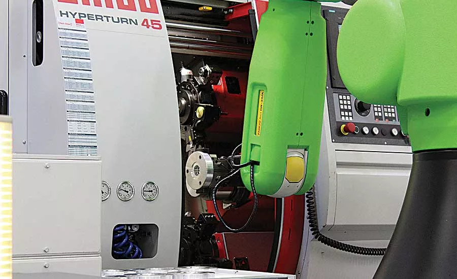

There are trade-offs between traditional robots and cobots. Cobots may not provide the throughput that a traditional robot can deliver for your specific application. Photo courtesy Ultra Tech Automation

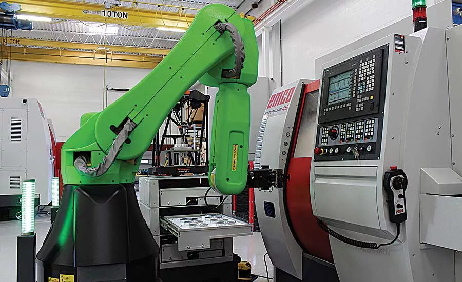

In many cases, the decision to use a cobot turns on a company’s assessments of floor space, line speed. Cobots are often a good choice when people must be able to access a machine to restock parts. Photo courtesy Ultra Tech Automation

Useful applications for cobots include palletizing, small-parts assembly, machine tending, packaging, polishing, machine tending and parts inspection. Photo courtesy Ultra Tech Automation

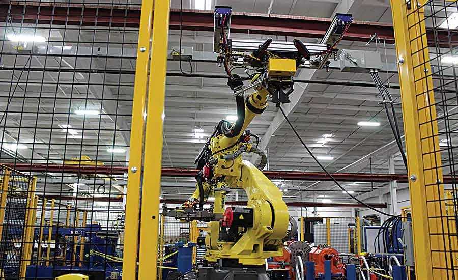

In many cases, an application is best be solved with a conventional robot and a well-engineered process, avoiding the compromises sometimes associated with cobots. Photo courtesy Ultra Tech Automation
