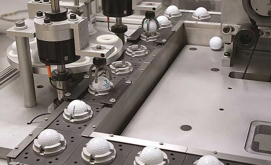

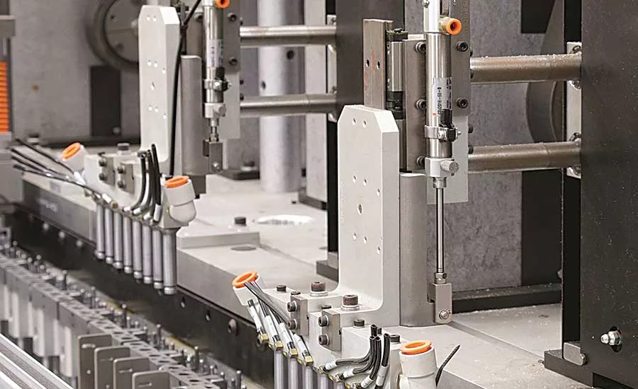

This precision-link conveyor is tooled up with synchronous pick-and-place units for the assembly and testing of fiber-optic connectors. Photo courtesy Stelron Components Inc.

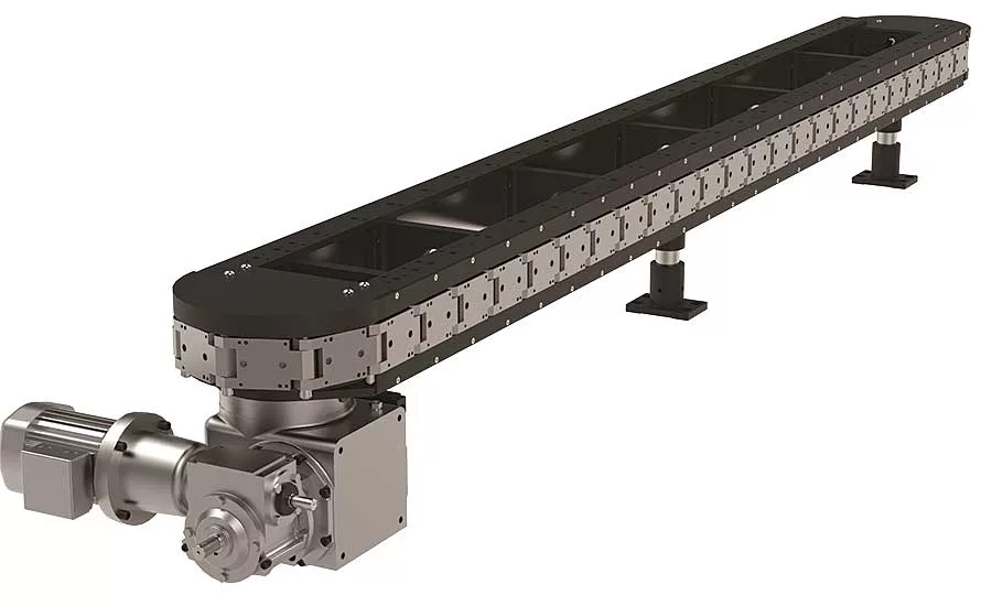

The CAMCO modular series of precision-link conveyors come in carousel and over-under style, tabletop or base-mounted, and have a link pitch of 3, 4.5 or 6 inches. Photo courtesy Destaco, A Dover Co.

Last year, a medical-device manufacturer installed four custom Stelron PLCs. Three of the conveyors feature a carousel-style chassis and work together to assemble blood-centrifuge cylinders. At the customer’s request, Stelron manufactured, assembled and mounted custom fixtures to these conveyors, according to Beezer.
On the other conveyor, which has an over-under chassis, Stelron mounted four MD-2 through-hole indexers to efficiently feed blood-platelet-separator parts to the chassis links. Beezer says the indexers’ large through-hole also makes it easy to run air tubes and cables to pneumatic grippers, ancillary cam-driven components and robotic devices.

Developed in the 1950s, the PLC is great for the automated assembly of products with 10 or more parts. The conveyor indexes a precise stroke, at which point equipment mounted at the side performs an assembly function. This event is then repeated many times along the entire length of the conveyor until the product is complete.
PLCs are only used in applications where assembly accuracy is critical; never to simply feed parts to a line. The conveyors are powered by a cam- or servo-driven rotary indexer, and they consist of machined plates, or pallets that are linked together in a chain like tank treads. This chain rides in tracks between two large sprockets.
Roller bearings enable the plates to move smoothly along the tracks and to pivot as they move around the sprockets. Part fixtures are mounted directly to the plates, which are made of aluminum, steel or cast iron. Aluminum plates are lighter and less expensive, but can stretch over time in high-speed applications.

The conveyors come in many sizes and have a link pitch of 3 to 9 inches. Modular tabletop systems range in length from 2 to 30 feet, with custom lengths also available. Heavy-duty conveyors feature a solid base and heavily ribbed legs to support large loads.
Modular systems have a wide, open frame so pick-and-place units, timing chains and power lines can be located in the center of the machines. Larger conveyors can be built with an open configuration, or with a closed configuration for increased rigidity.
During operation, the PLC has a move-dwell-move motion, which comes from a globoidal (sphere) or barrel cam driven by a DC motor. The conveyor can index continuously, or it can index on a signal from a programmable logic controller or a switch activated by an operator.
