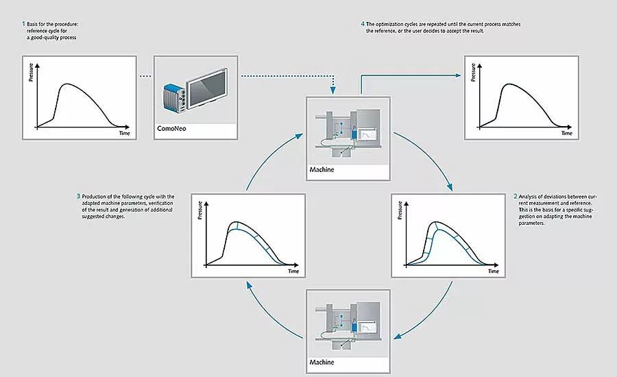

Inline process monitoring systems, such as ComoNeo from Kistler, capture the pressure in the cavity throughout the entire molding process. They document the values measured by piezoelectric sensors in the form of a time-pressure curve. Besides ensuring transparency, this approach plays a key part in process baselining. Once a stable process has been defined, its profile can be used as a reference. This is a major factor in ensuring that quality parts can quickly be produced even after a change of machine or location.
To achieve this, ComoNeo’s Recover Restart Assistant accesses the reference curve for an existing optimal process that is already producing a quality part. It compares this curve to the curve for the new process, so any deviations in the characteristic process phases become clearly visible. On this basis, the system suggests that the operator should change specific machine settings to approach the ideal profile for the baseline curve.
Part quality is determined by a number of parameters, such as injection speed, holding pressure time and temperature, so the curves are compared in a series of consecutive adaptation steps. As this sequential process proceeds, the operator can see whether and how individual machine setting values affect the cavity pressure. Process optimization continues until the new operating point precisely matches the reference cavity pressure, or until the user personally judges the result to be satisfactory.

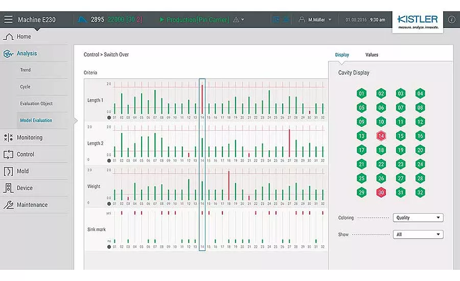

The first step is to generate extensive test plans (known as design of experiments, or DoE), which are worked through to determine how various machine settings influence conditions in the mold cavity—as expressed by the cavity pressure profiles. A vast amount of data must be recorded and statistically evaluated to identify the relationships between machine settings and part characteristics. Together with Stasa QC software, technology from Kistler makes it possible to examine these process windows efficiently at shop-floor level. DoEs are then generated and transferred into the Stasa QC software. Automatic recording of the cavity pressure curves is handled by ComoNeo’s Predict functionality.
The data is then fed back into the Stasa QC software, which uses it to generate a statistical quality prediction model. The completed model simulates the relationships between machine parameters and expected part attributes. In conjunction with ComoNeo Predict, engineers can then have these expected quality characteristics specified directly on the machine without actually measuring them. Due to this approach, the part’s quality can be predicted even before it has been manufactured. Besides improving validation, this method yields a major advantage during production. With the help of the quality prediction model, automatic separation of good and bad parts can be implemented directly on the machine—together with all the documentation that is required.
