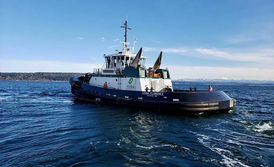

Tugboat operators also have a keen interest in using unmanned technology for near-shore applications, because autonomy offers the potential to improve safety and efficiency.
Autonomous operation enables unmanned tugboats to maneuver alongside traditional manned vessels without the risk of serious injury. That’s because one of the most perilous elements of a towage operation is when a tug has to engage with a much larger cargo ship.
The tugboat crew has to physically catch the ship’s weighted heaving line from the deck, which can be particularly dangerous in bad weather conditions or heavy seas. Once the heaving line is captured, a crew member also has to attach the tug’s towing line to it so it can be winched aboard the connecting ship and secured for towage.
One of the first attempts to integrate autonomous systems in real-world commercial tugboat operations was launched earlier this year. The 100-foot-long Rachael Allen, which was built at Nichols Brothers Boat Builders, in Freeland, WA, will operate off the coast of California towing ships for Foss Maritime.
It features a SM300 autonomous-command-and-control system supplied by Sea Machines Robotics Inc. Capabilities include transit autonomy, as well as remote access to the tugboat’s onboard machinery, a feature that allows personnel to manage and support operations from anywhere on board the vessel or from shore. The tugboat is also equipped with navigation obstacle detection and avoidance capabilities.
The project marks Sea Machines’ first installation of an autonomous system on a vessel over 5,000-hp.
“While our space has seen a number of government-innovation backed prototype initiatives for autonomous tugs in Europe, Japan and Singapore, it’s notable that Foss is launching the first commercially funded project in U.S. waters,” says Michael Johnson, CEO of Sea Machines. “Our technology has been in use aboard commercial vessels around the world for nearly three years and is backed up by thousands of hours of testing and validation.
“This is yet another real-world example of how autonomy is reshaping the way work is being done by vessel crews on the water,” notes Johnson.
Capitalizing on Sea Machines’ remote command and control capabilities, Foss will use its existing Fleet Monitoring Center personnel to survey the tugboat’s systems and operating domain via streaming video and sensor data.
“By having an extra set of eyes and hands with access to vessel command and control, the Sea Machines system allows [us] to maximize productive time, safety and crew welfare,” explains Will Roberts, president and CEO of Foss Maritime. “[We are] leveraging cutting-edge technology to take on the routine work and allow crew to focus on higher-level tasks and improve safety, while also increasing productivity and efficiency during harbor operations.”

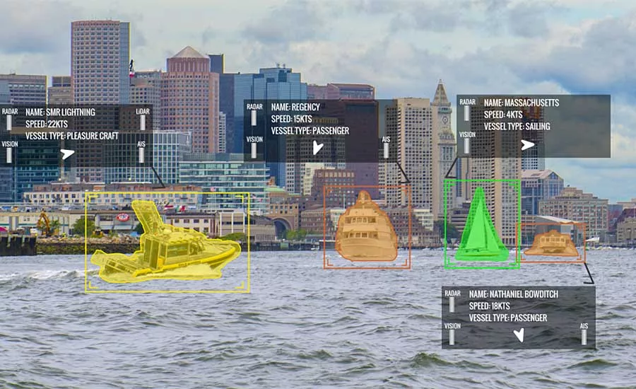

“Our focus used to be on vessel capabilities and how to navigate safely with sensors, but if you want to remove the crew, you still need to have an environment with a remote operation center with the right data and connectivity links with redundancy and security,” says An-Magritt Tinlund Ryste, director of next-generation shipping at Kongsberg.
Then there’s the question of what technologies to use and where. As Ryste points out, lidar can be good for a harbor, but not cost optimal for deep sea operations. “You have to think of the cost benefit of adding more equipment,” she points out. “We’re not doing autonomy for the sake of it; we’re doing it to solve safety, emissions or logistical challenges.”
Part of the focus at Kongsberg is adding optical sensors for navigation that can pan, tilt and zoom to track objects and apply machine learning to predict the movement of an obstacle. The devices also need to recognize an obstacle’s shape, how it will move and in which direction.
“Then, you have to think about how you’re able to collect data from multiple sources and make sense of it, and utilize those data sets, as well as have trust that what you have detected is actually accurate,” explains Ryste. “Remote piloting has been more heavily investigated in the last year. It has changed our way of thinking and has set the scene for a change of pace that hasn’t been there before.”

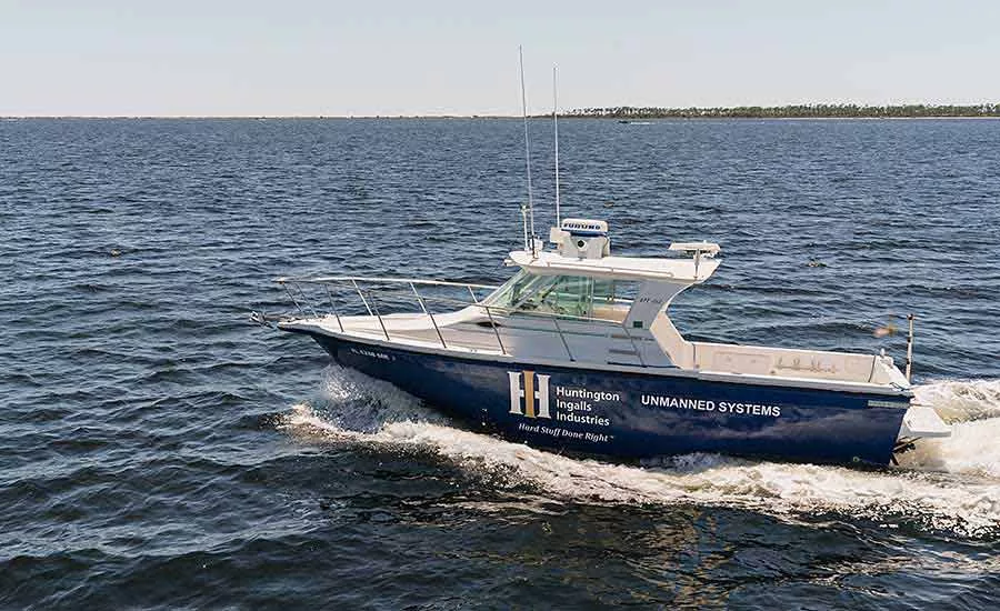

Naval engineers see a bright future for unmanned surface ships. In fact, the U.S. Navy has several autonomous vessels currently operating in sea trials.
Recently, two supply ships successfully travelled more than 4,500 miles, via the Gulf Coast and the Panama Canal, to the West Coast. It’s part of the Navy’s secretive Ghost Fleet Overlord program that is studying the benefits of unmanned vessel technology. Except while transiting the Panama Canal, the ships operated almost entirely in autonomous mode as engineers collected data.
Earlier this year, the U.S. Navy Pacific Fleet conducted an exercise dubbed Unmanned Integrated Battle Problem 21 (IBP21). A variety of unmanned aerial, surface and underwater vehicles were put into real-world, “blue-water” environments, working in sync with manned platforms in combat drills.
“Advancements in technology have created the opportunity to provide our military with an operational advantage by developing improved command and control capabilities,” says Dorothy Engelhardt, director of unmanned systems for the deputy assistant secretary of the Navy for ships. “This enables our military to be more agile, lethal and decisive.”
“Large-scale exercises such as IBP21 are critical for the Navy and Marine Corps to make the transition to a hybrid manned-unmanned force in the future,” adds Rear Admiral Lorin Selby, chief of naval research. “These demonstrations ensure what works in theory will work in the fleet—in an environment that is messier, dirtier and wetter than a lab. They also allow us to get valuable feedback from the Sailors and Marines themselves.”
According to Selby, the purpose of IBP21 was to explore a variety of questions about how unmanned systems can be incorporated into fleet operations. For example, how can unmanned and manned systems work together effectively in diverse warfighting scenarios, and how can unmanned systems be seamlessly integrated into existing platforms?
“Unmanned systems are resilient, enable better beyond-line-of-sight targeting, and improve battlespace awareness and command and control,” explains Selby. “They also provide significant advantages in ISR (intelligence, surveillance, reconnaissance) and targeting and firing capabilities, without creating additional risks to the mission or warfighters. The result—more effective offensive and defensive postures.”
