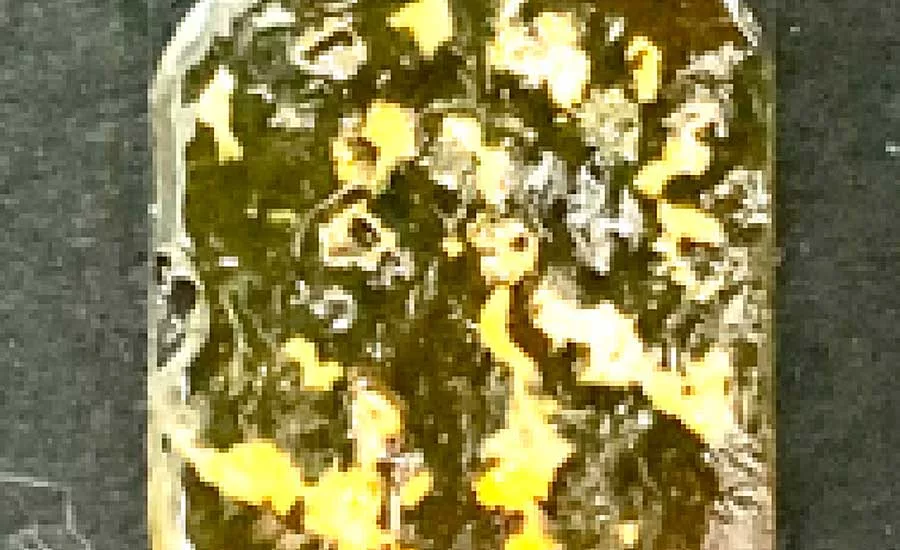

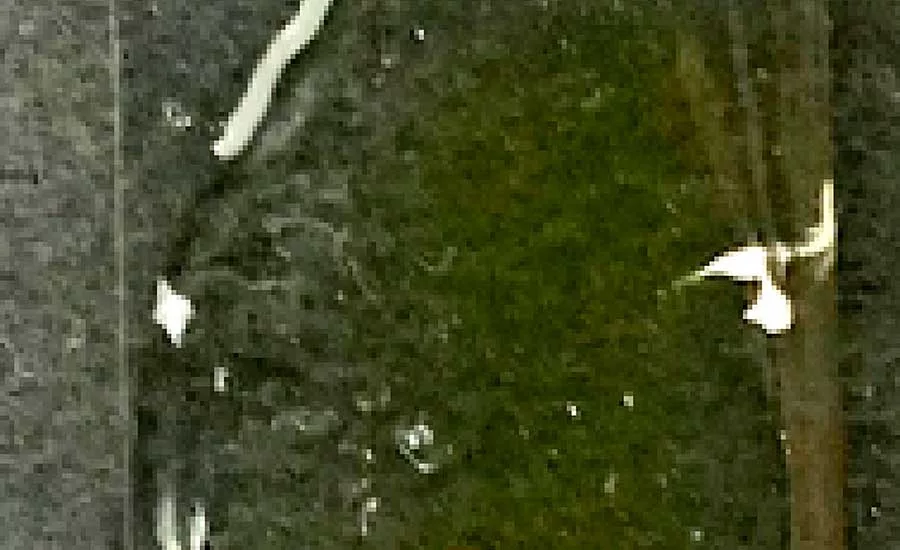

After 10 minutes of microwave heating, the epoxy cured to a clear resin (here). In contrast, after 20 minutes in an electric furnace, our epoxy still showed some uncured material (next). Photos courtesy Sophia University
Microwave Curing of Epoxy
After 10 minutes of microwave heating, the epoxy cured to a clear resin (prev). In contrast, after 20 minutes in an electric furnace, our epoxy still showed some uncured material (here). Photos courtesy Sophia University

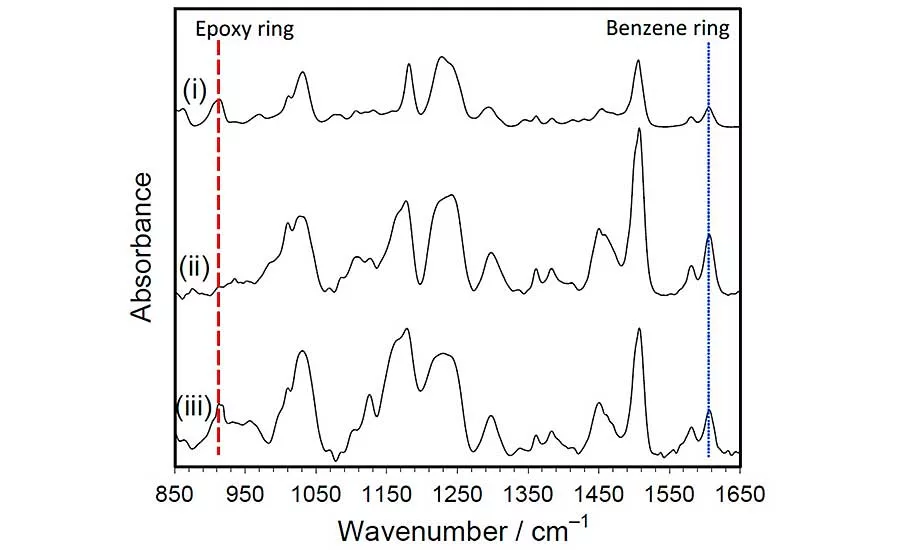

The quality of the cured adhesive was examined by attenuated total reflectance Fourier-transform infrared spectroscopy. Our tests indicated complete cross-linking of BADGE after 10 minutes of microwave heating. In contrast, complete cross-linking had not occurred after 20 minutes in the furnace. Source: Sophia University

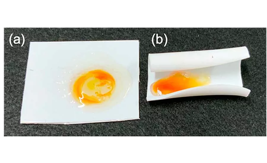

These photographs illustrate the curing of the adhesive on a polystyrene plate by microwave heating (left) and heating in an electric furnace (right). The microwaves did not degrade the polystyrene. Photos courtesy Sophia University

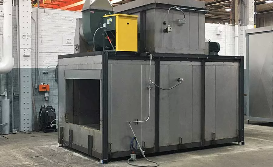

Epoxies can be cured more quickly by heating the bonded assemblies in an oven. However, not all substrates can tolerate extended time in an oven. Photo courtesy International Thermal Systems

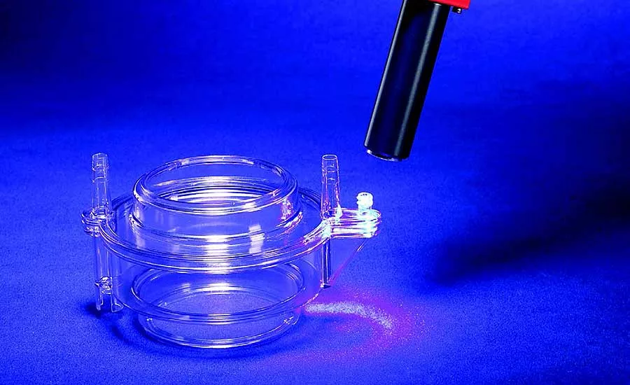

The obvious disadvantage of UV curing is that the radiation must be able to reach all parts of the assembly. Photo courtesy Henkel Corp.

After microwave heating for 10 minutes, the adhesive appeared as a pale-yellow transparent resin. In more detail, the PA began to become transparent about 5 seconds after the start of microwave irradiation. Approximately one fourth of the PA was not observable after 45 to 60 seconds of microwave irradiation. After 70 seconds, much of the PA disappeared, and after 80 seconds, the curing was complete.
The heating of the adhesive never occurred from the edge. In other words, heating appeared to proceed relatively evenly.
Curing in the furnace was different. After heating for 10 minutes in the furnace, the adhesive was sufficiently cured. However, visual observation clearly showed that unreacted PA was present near the center. Heating proceeded rapidly from the surface of the adhesive the moment the mixture was placed in the furnace. The edge of the adhesive appears to be more cured 30 seconds after being introduced into the furnace. After this time, however, no further changes were observed. After 180 seconds, the surface seems to have hardened. In reality, however, the resin was not cured and was soft when pressed with a finger.
In short, microwave heating ensured that the adhesive components reacted uniformly. In the furnace, curing was not uniform. The radiant heat from the furnace cured only the surface of the adhesive near the heat source, since the thermal conductivity of the adhesive is very low. Thermosetting did not occur much below the surface. In contrast, with microwave heating, the microwaves penetrated to the center to cause uniform thermosetting throughout. In addition, since the curing reaction is an exothermic process, curing was accelerated by self-heating.
Prior to curing, the initial temperature of the sample was 25 C. With 20 watts of power, the sample needed just 32 seconds to reach a temperature of 140 C. In contrast, it took 81 seconds to reach 140 C with conventional heating.
The difference in the structure of the adhesive between microwave heating and conventional heating after curing was investigated by the attenuated total reflection technique using a diamond prism in the FTIR spectrophotometer. Differential scanning calorimetry was also performed. No differences were observed in the results.
