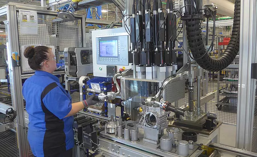

Laser welding enables GKN Newton to streamline a process that previously required mechanical fastening. Photo by Austin Weber
2021 Assembly Plant of the Year: GKN Drives Transformation With New Culture, Processes and Tools
Laser welding provides a quick production process that eliminates 12 bolts. Photo by Austin Weber

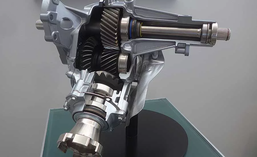

All-wheel drive (AWD) technology has taken the automotive world by storm in recent years, because of its ability to effectively transfer power to the ground. Today, many sport utility vehicles use AWD for better acceleration, performance, safety and traction in all kinds of driving conditions.
Typically, an AWD drivetrain operates as a front- or rear-wheel drive system. It preemptively sends power to front and rear axles to prevent wheel slip, then backs down if no slip occurs. No driver effort is needed to activate the system.
AWD systems use sensors and control systems to automatically decide which axle and which wheels receive the most power at any given moment when road surface conditions or vehicle dynamics demand extra traction. The wheels receive varying amounts of torque through a system of differentials and clutch packs that distribute power to optimize traction in rain, mud, snow and ice.
AWD is often confused with four-wheel drive systems, but it is different. The former are controlled more by electronics than by mechanical parts and are fitted primarily to road cars. In contrast, four-wheel drive systems tend to be more complex, and are often equipped with more mechanical parts for off-road applications.
As the auto industry quickly evolves to electrified drivetrains, demand for AWD technology is expected to intensify in the near future. That’s good news for GKN Automotive, a Tier One supplier headquartered in London.

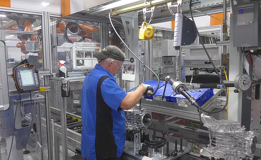

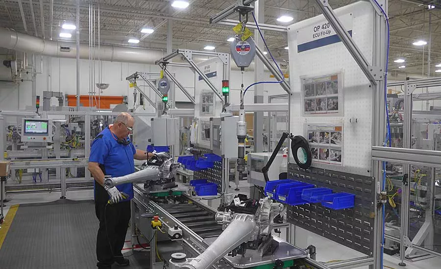

“In the past, it was production first and operator second,” recalls Chad Hawes, operations director. “Today, our focus first and foremost is on safety, followed by quality and productivity. We worked hard to get that culture change and stabilize things in the plant to achieve continuous improvement and process repeatability.”
“We have a lot of automated workstations, but people can become complacent when they do a repetitive job,” adds Andrew Smith, director of quality, risk and operations excellence. “We try to move operators around and teach them multiple stations. To ensure that safety is our No. 1 priority, we reviewed ergonomic concerns and started a safety committee.

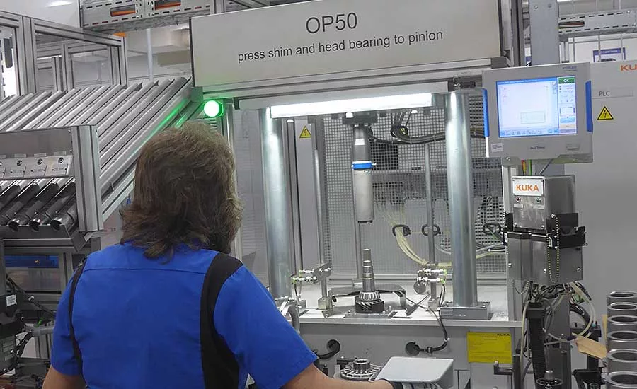

Error-proofing efforts in the plant have been upgraded and now include non-quality critical operations as well to ensure that even minor maintenance-related issues are addressed quickly. In fact, GKN Newton’s newest assembly line features robots that automatically error-proof the process every few cycles.
Shims, which are used to address tolerances and variations, play an important role in the assembly process. For some products, there can be up to 30 or 40 different shims that can vary in size by around 30 microns. To improve alignment and press operations, shim selection is error proofed multiple times throughout the assembly process.

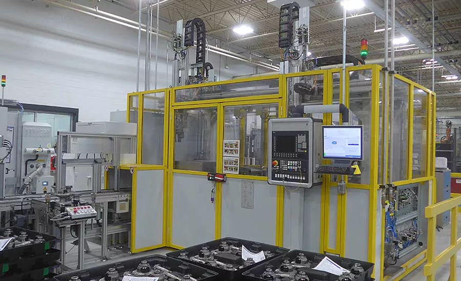

Vision systems have also helped GKN Newton reduce errors and improve quality. Cameras are primarily used to detect external components such as circlips and O-rings.
“They are also used frequently during the application of sealant beads to analyze the quality and location of the application,” explains Nash. “Similarly, we also use 3D profilers to create a solid model that analyzes the height of certain installed gaskets.”

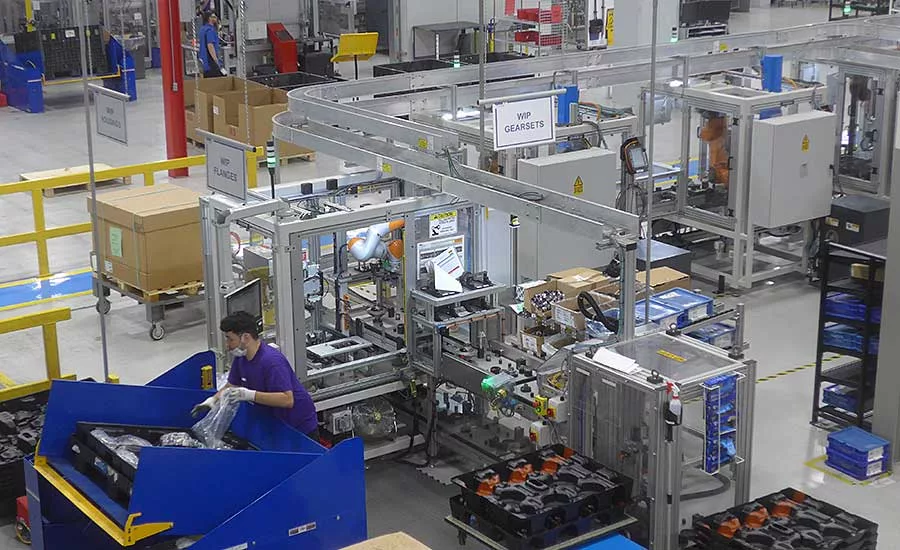

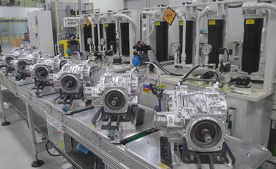

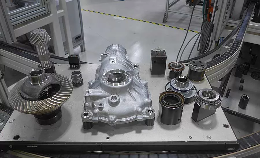

GKN Newton mass-produces PTUs, rear drive units (RDUs), front drive units (FDUs) and clutches. Product mix is approximately 60 percent front-drive and 40 percent rear-drive.
Front and rear-drive units are built on separate assembly lines, because complexity and number of components differ for various units. For instance, some contain only about 50 parts, while others have more than 120 components.
“Each product has its own variable, depending on the customer’s needs,” says Matousek. “But, the primary difference is in the gear set; specifically, the ring gear.
“In the RDU, the ring gear will be accompanied by either a differential or a clutch system to balance power to the rear wheels,” explains Matousek. “The RDU will have one power input and two power outputs. The PTU will have one input and one or two outputs.”
PTUs include disconnect and nondisconnect products. The former refers to a clutch system that disconnects power from both the PTU and rear-drive module (RDM) to save energy when a vehicle is operating in front-wheel drive only. RDMs include differential ring gears with no clutch or a single clutch and spool ring gears with twin clutches.

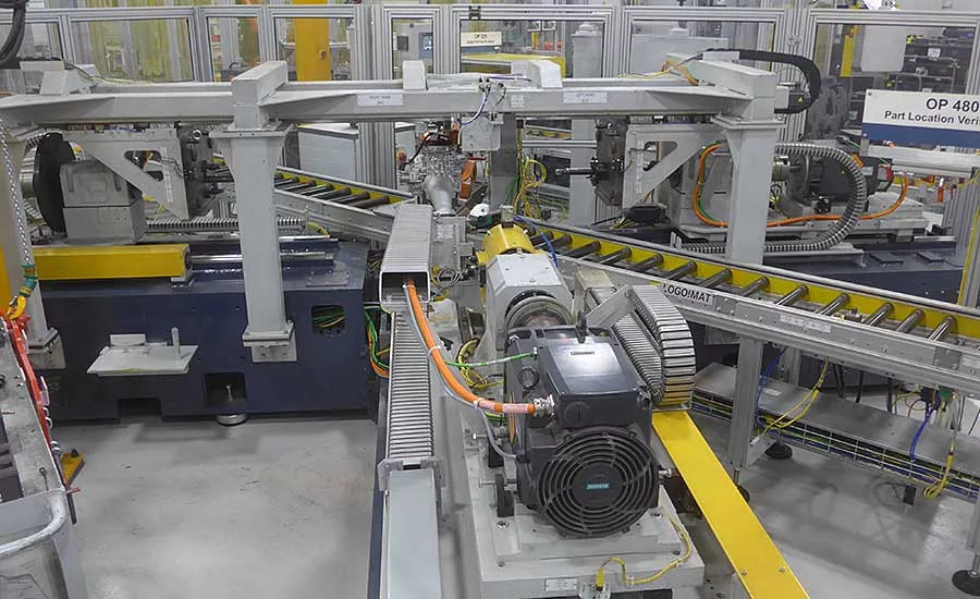

The plant features a large heat treatment facility that can process 15,000 parts a day. Elsewhere in the building, hard and soft machining operations focus on various types of metal cutting operations, such as tooth generating, lapping and testing. Aluminum housings are also machined in the plant.

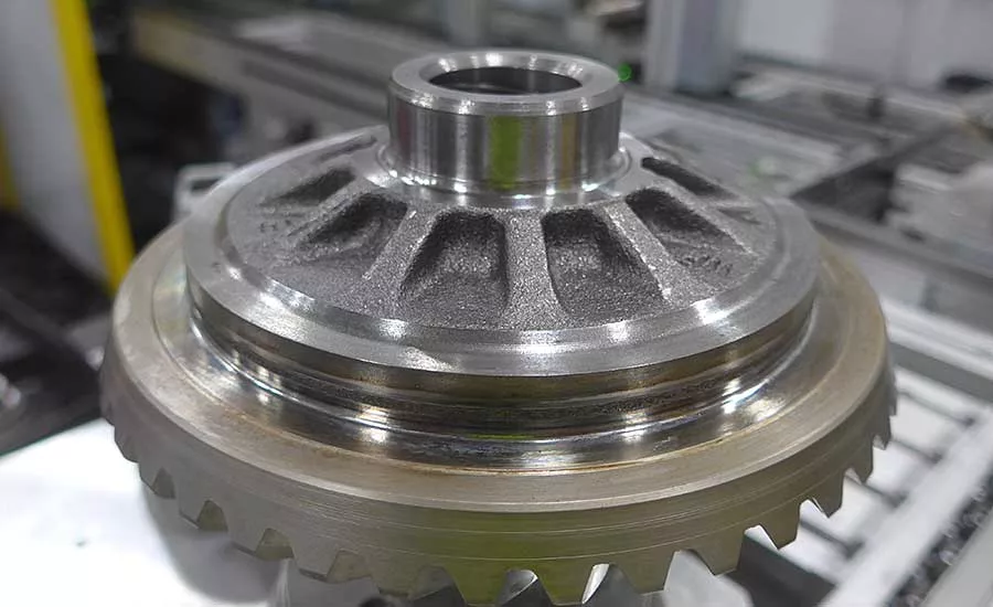

The facility recently invested in fiber laser welding equipment that forms a radial, 360-degree joint around parts. It enabled GKN Newton to streamline a process that previously required operators and equipment to drill holes and install 12 bolts to join a ring gear to a differential. The new production process is significantly faster, plus it reduces weight and friction on the part when in use.
“We eliminated a series of machining processes in Plant 1 and fastening processes in Plant 2,” says Nash. “Fiber laser welding requires about 14 seconds to weld each part. Our manufacturing engineering and product engineering teams are currently working on a project that will reduce this process to less than 8 seconds of cycle time. By comparison, the old bolting process required a cycle time that averaged around 70 seconds.”

Most assembly lines are semiautomatic, with operators interacting with presses, fastening tools and test stands. Workstations feature a variety of ergonomic lift-assist devices, jib cranes and tool balancers. All stations are designed for quick changeover, with cycle times averaging between 40 and 80 seconds.
Plant 2 also features a flex line that enables operators to build eight entirely different axles for two manufacturers and five vehicles. Each station is equipped with a set of changeover tooling unique to each part type.
“This assembly line was designed to be easily adaptable to produce a wide range of part types,” says Nash. “As a part reaches end of production and phases out, the full-scale line is decommissioned and this line is adapted to build these service parts. Not only does this allow the plant to preserve floor space, it also helps ensure that the quality of the service parts remains the same or better after the transition.”
Automation has also played a key role in GKN Newton’s recent success. In fact, more than 100 robots are currently in use throughout various parts of the plant, including a mix of SCARA and six-axis machines from several vendors.
“We try to automate whenever there are ergonomic issues or concerns,” explains Nash. “We also look at areas where operators are struggling or where consistency and quality is lagging behind.
“Our main focus with automation is in tightening, torqueing and testing operations, because consistency often goes up dramatically,” Nash points out. “We still need a lot of skilled operators, but repeatability is always something we look at carefully.”
The newest assembly line in the plant is fully automated. It features 12 robots and only three operators, arranged in a linear, single-station format. A collaborative robot at the start of the assembly line enables operators to feed parts. Components move between stations on a palletized conveyor system.
GKN Newton is also in the process of implementing automated guided vehicles (AGVs) for material handling applications. The four-phase project is scheduled to begin early next year. The first AGVs will be used to transport bearings, fasteners, seals and other commodities to the assembly lines via tote trains.
All AWD products are checked with a series of functional tests at the end of each assembly line. Processes include pressure decay leak testing and noise, vibration and harmonics (NVH) testing. Additional tests measure backlash, clutch balance and total torque.
“The NVH test station takes the largest number of measurements in a single operation and it tends to have the longest cycle time,” says Matousek. “These test rigs do more than just test for noise. They also pinpoint and record the amount noise or vibration of each and every moving component.”

Fastening plays a critical role in assembling products at GKN Newton, because AWD components are subjected to dynamic loading and heavy amounts of vibration when in use. The plant features several types of fastening equipment, but primarily relies on DC-electric tools to drive screws.
“Nearly every fastening method is used in some area of the plant,” says Emil Naslund, engineering manager. “Typically, for any pre rundown, we use torque-limited pneumatic guns or battery-powered tools. For final rundown on high-volume bolts, we use electric spindles.
“Spindle tooling varies by each line and includes fixed, robot-mounted, CNC-mounted, operator-controlled fixtures and multi-spindle applications,” explains Naslund. “For small screw applications, cordless drivers are typically used.”
“All operations target specific torque and angle specs,” notes Naslund. “Depending on the application, the bolt tightening order is controlled by spindle location monitoring. We also utilize automated bolt loading systems to reduce cycle time. In one application, a battery powered right-angle torque gun is used to measure the torque-to-turn average of an assembled unit.”
Cross-threading and defective threads are automatically detected in station.
“How we monitor the process depends on what combination of conditions we are working with, such as whether a bolt arrives seated, slightly started or placed in station,” says Naslund. “Other variables include tapped vs. thread cutting and thread locker vs. lock washer.
“Each combination has a unique set of steps to monitor,” Naslund points out. “Most importantly, we make sure our torque programs are recording and saving the results of each critical part of the process, so the torque and angle limits can be accurately set.”
GKN Newton recently implemented a multi-spindle screwdriving operation to improve productivity and quality on one of its assembly lines. The previous assembly process involved three workstations, two operators and a 65-second cycle time.
The former method involved an operator loading all 16 bolts, then pneumatically running down four of them. At a following station, another operator would run down the remaining 12 fasteners. Finally, a robot with a single spindle would complete the final tightening of all the bolts in a specific point pattern for proper clamp loading.
“The second challenge was variation in the pallet fixturing, causing the part presentation to slightly vary,” says Naslund. “When a robot was unable to engage a bolt, it would begin a search cycle moving 1 millimeter in each X-Y direction until the bolt was found. When the search cycle was utilized, it added significant cycle time.
“We were using a very low-profile Torx bolt at the time,” explains Naslund. “Because of these difficulties in engagement, our assembly and design engineers collaborated on a change that resulted in standard 10-millimeter bolts.
“With the new design, the overall cycle time was reduced to less than 45 seconds and only requires one operator to load the bolts,” adds Naslund. “In the near future, this will be replaced with a robotic pick-and-place operation to fully automate this task.”
Another issue arose with the previous design. After all fasteners were tightened, the first few bolts that were tightened by the robot would lose clamp load after all bolts were seated. This typically occurred when the operator at the upstream station did not fully seat all bolts at the pre-rundown operation. This required a secondary torque check of the first few bolts, which further added to cycle time.
“With the new design, the bolts are seating more in-sync,” says Naslund. “Since the fixture engages all the bolts at once, a redundant torque check can be performed in a fraction of a second as a final layer of security.”

Presses also play an important role at the 2021 Assembly Plant of the Year. In fact, there are more than 100 different press operations in the factory.
The machines are used to attach bearings, bearing cups and shims, in addition to various types of seals and circlips, dowel pins and flanges. The plant’s largest presses are typically in charge of pressing ring gears onto differential or spool shafts before the welding process. Some unique applications include pressing a wiring harness connection into an electronic control unit or evaluating the depth of a manually installed seal.
“We primarily use electromechanical presses, but we have a very wide range of press types,” explains Matousek. “Our smallest electromechanical machine is a 1 kilonewton press and our largest is 200 kilonewtons. We also use arbor presses, but at these operations they are fitted with transducers to monitor the force and distance of the manual operation. In addition, we use hydraulic and air over oil presses.
“Our press stations are our first line of defense in ensuring we produce consistent quality parts,” says Matousek. “Specifically, how we control this process is key. Properly controlling our press operations provides multiple benefits, such as maintaining station condition and early detection of supplier part quality defects.
“Perhaps most importantly, our equipment can capture and reject a defective unit or press in station without relying on subsequent testing operations,” claims Matousek. “From a bottom line perspective, each station a defective unit passes through after a press is money lost in both labor and unnecessary scrap at each downstream station.
“For example, say we are pressing a seal into a housing and the seal is damaged during the press operation,” Matousek points out. “With the right detection in place, we can capture the abnormal spikes in force and reject the component right there in the root cause station. The only scrap loss at this point is a single seal.
“If this part wasn’t captured in station, it would continue through the assembly process accumulating additional scrap at each station, until finally being caught at the leak test operation,” explains Matousek. “By the time it arrives at the leak test operation, it’s a fully assembled unit, so the amount of scrap loss at this point is significant.
“When our limits are properly controlled, it can also provide several other benefits, such as early detection in station condition,” says Matousek. “If a press becomes misaligned or tooling becomes worn, we are able to detect it before it begins to impact part quality.
“Another recent example that comes to mind is a press operation where a shim is installed,” notes Matousek. “One day, a new operator mixed shim sizes in a loading tray. When the shims would not verify, she assumed the verifier was malfunctioning, measured one shim and installed the mixed shim instead.
“Although both shims were technically in print specification, the final distance was outside of our controlled range and was rejected,” says Matousek. “Instead of accumulating scrap from potentially hundreds of fully assembled units, we were able to quickly address the issue.”
