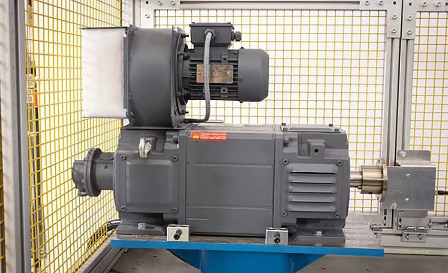

This custom test stand is designed to accommodate a wide range of small, high-speed electric motors. Photo courtesy ACS Inc.

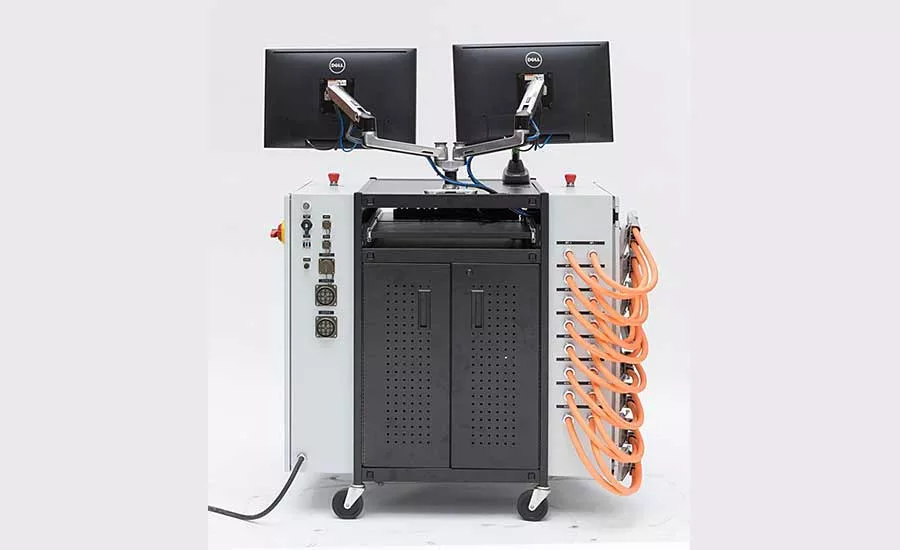

This electric transmission assembly manually mounts to a motor for testing. Photo courtesy ACS Inc.

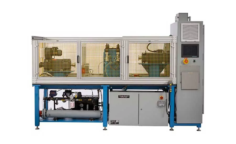

This electric transmission assembly test stand verifies production quality. Photo courtesy ACS Inc.

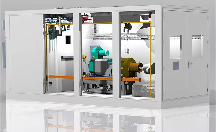

This 3D model depicts a modular enclosure for testing EV power train components. Illustration courtesy ACS Inc.

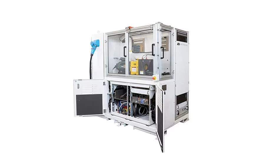

This lithium-ion battery pack and battery module production verification stand is designed to handle multiple devices under test. Photo courtesy ACS Inc.

These safety challenges have led to rising interest in modular test cells. Standalone units can be located outside of the main facility and are not tied into the larger plant’s infrastructure. When a battery fire starts in a burn box or a modular unit, it can be left to burn out without presenting a danger to people or property. Should a battery or battery pack experience a catastrophic failure, modular cells contain the damage without putting the rest of the facility at risk.
