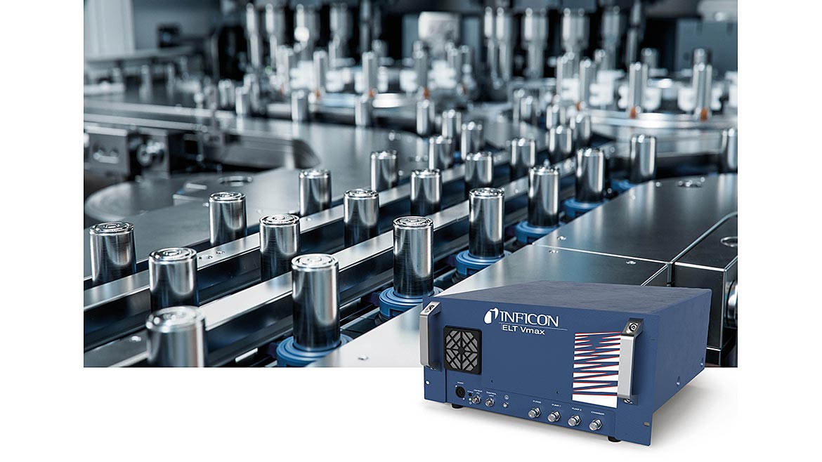

Leak testing battery cells in production by direct electrolyte leak testing.
Leak testing battery cells in production by direct electrolyte leak testing. Image Source: INFICON
This is woefully inadequate to ensure quality in the manufacturing of such a significant element in an electric vehicle and should be on the order of 100 percent to ensure safety for consumers in daily operation. In fact, battery makers should test at every step in the manufacturing process, from the production of each battery cell to when it is assembled into a module and then into a pack.

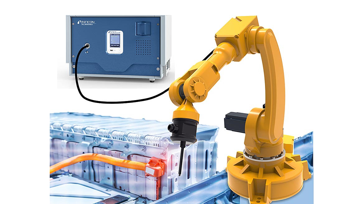

Robotic-sniffing battery pack with XL3000flex
Leak testing of assembled battery packs via robotic sniffer leak testing. Image Source: INFICON
In January 2025, the Battery Standards Testing Committee issued J3277/1_202501, a recommended practice that established nondestructive in-line production test methods for evaluating water leak tightness for propulsion battery packs. Using the Selected Equivalent Channel (EC) method defined in SAE J3277, its purpose is to achieve results equivalent to the IEC 60529 standard’s IPX7 standard. The recommended practice looks at ways to provide nondestructive end-of-line leak testing for battery pack assemblies and coolant systems.

In practice and in production environments, after ensuring cells are leak-tight, and modules properly constructed, assembled battery packs can be tested using test gas, typically helium, to discern leak rates that conform with manufacturers’ standards. Packs are pressurized to above atmospheric pressure with tracer gas and industry-standard robotically controlled sniffer probes are moved near to all seals or other potential leakage locations to ensure leak tightness. This is accomplished at production line speeds.
