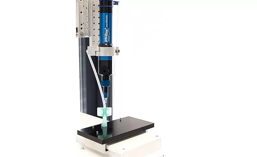

 A look at medical technology and for example, the developments in catheter manufacturing, shows the potential of adhesive technology as a component of automated production. There is hardly a medical field in which catheters are not used. Whether in intensive care medicine for ventilation, in urology as bladder catheters or in cardiology as heart catheters. In simple terms, the production of a catheter always begins with the extrusion of the tubes, which in the next step have to be glued to the so-called connectors, as you can see on the picture to the left. This adhesive connection must also ensure that the catheter is leak-proof. An optimal process combines extrusion, cutting and gluing via an automated process, since the risk of error is highest in manual joining.

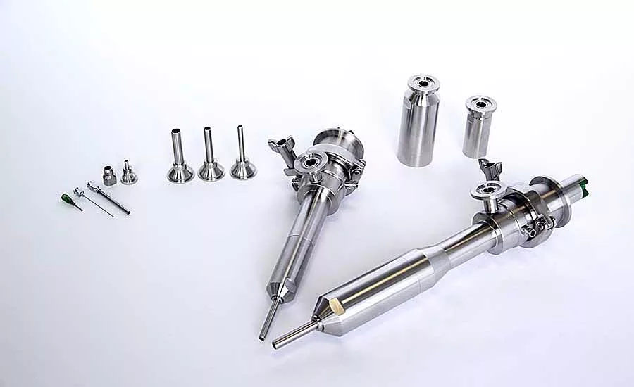

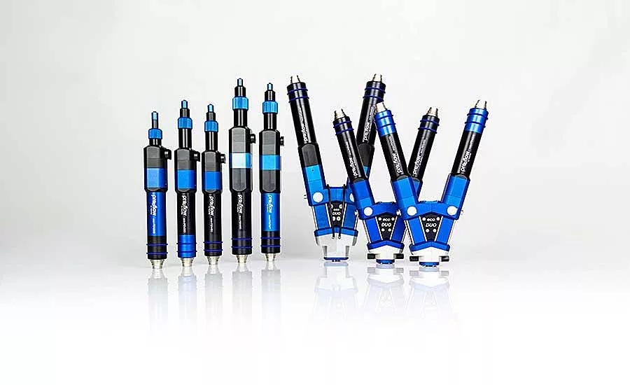

One way to automate the joining process is to use purely volumetric dispensers. Available under the names ViscoTec and preeflow (you can see the portfolio on the pictures below), among others, this technology allows continuous and pulsation-free dosing. In addition, the process is gentle and low-shear with all materials - regardless of the viscosity of the adhesives to be processed.
Particularly important for medical devices that are used on and in the body: Smooth and sterile surfaces, the base of which is superimposed over the bonding and subsequent sterilisation. The thread breakage of the adhesive, which is absolutely necessary for this, results from the technical implementation of the volumetric dosing unit: The conveying direction can be reversed. In this way - in addition to the exact thread breakage mentioned above - dripping of the material is prevented. Bonding of even the smallest difficult medical devices is made possible with an absolute accuracy of +/-99 % even in the microlitre range. The smallest amounts of adhesive are applied to the tubes without tearing and with pinpoint accuracy - the volume is demonstrably the same throughout the entire production cycle. The delivery rate can be changed if required by a specific component of the catheter such as balloon, cuffs or connectors. Even after adjusting the delivery rate, the dosage is accurate and tearproof. In order to be able to cover all automated, semi-automated but also manual processes with one dosing technology, the dispenser has been technically designed for all areas of application.
