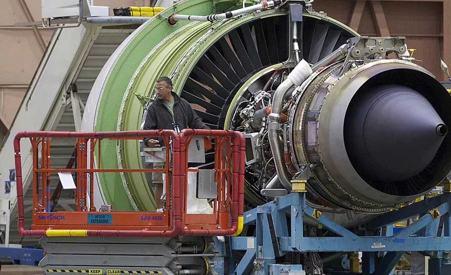

GE originally developed Predix software for internal use to leverage data and drive productivity at its various business units, which operate hundreds of manufacturing facilities around the world. Photo courtesy General Electric

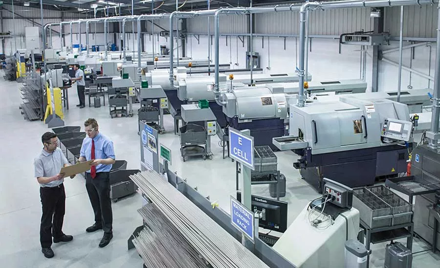

Siemens machine tools are, of course, compatible with the company’s Mindsphere software, which runs on top of Microsoft Azure or AWS infrastructures. Photo courtesy Siemens

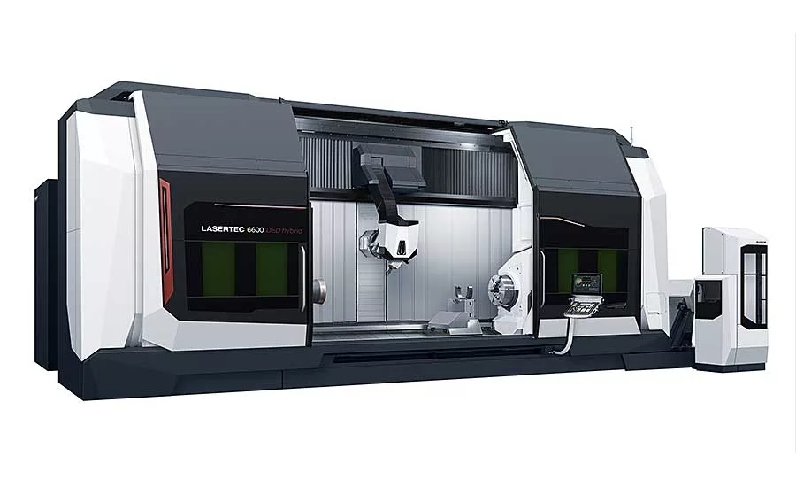

DMG Mori Seiki has been a pioneer in remote machine monitoring systems—software designed to allow users to monitor their shop floor equipment. Photo courtesy DMG Mori Seiki

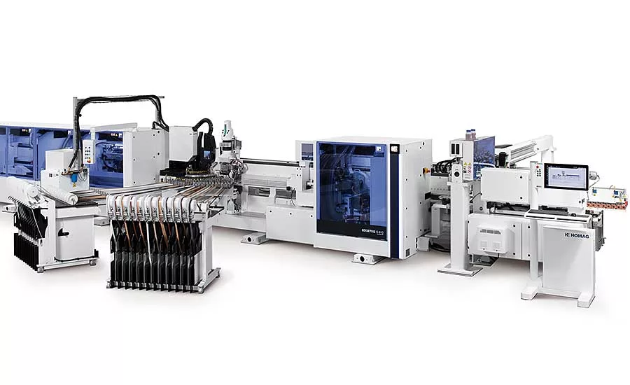

Machines from the Homag Group have been connected to the plant level for a long time. They even have their own MES system. Photo courtesy Homag Group

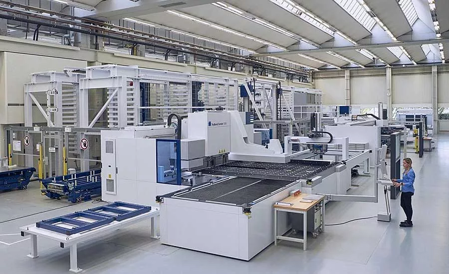

Trumpf’s smart factory platform, Truconnect, includes a comprehensive portfolio of consultancy, software and hardware resources. Photo courtesy Trumpf

DMG Mori is a pioneer when it comes to digitization in machine tool construction. DMG started with CELOS, an operating and control system based on applications. Supported in ADAMOS, CELOS can become an open network and a digital market for the machine construction industry.

Machines from the Homag Group have been connected to the plant level for a long time. They even have their own MES system. They started with their own digital platform that connected them to the cloud. Now, it is an open platform, called Tapio, integrated in ADAMOS.
Trumpf’s smart factory platform, Truconnect, includes a comprehensive portfolio of consultancy, software and hardware resources. Trumpf’s subsidiary, Axoom, provides a cloud monitoring platform for the company’s machines, but it is not exclusive to competitors.
