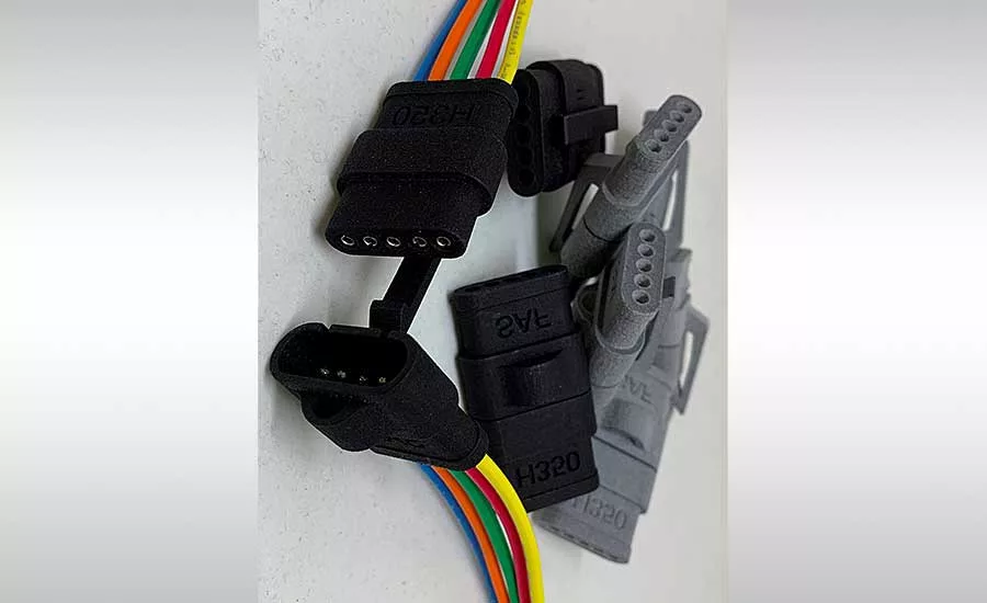

Harness manufacturers can 3D print high-quality connectors at production levels on demand with the H350 machine. Photo courtesy Stratasys Ltd.

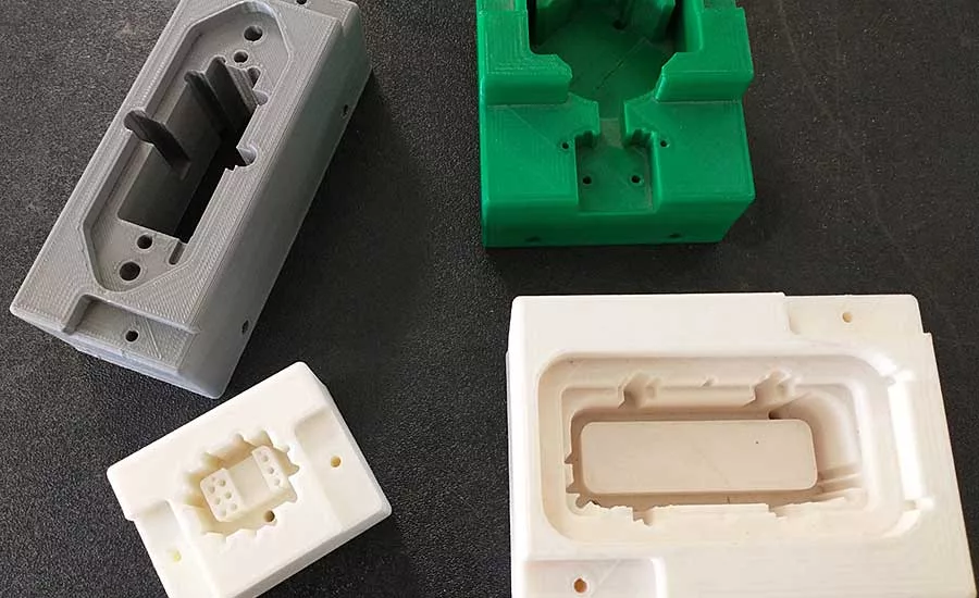

Made of plastic, these white blocks are holders that keep connectors in position during harness assembly. Photo courtesy HP Inc.

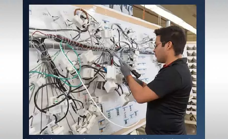

Wire harness manufacturer Cesar-Scott Inc. 3D prints connector holders, switches, jigs, fixtures, and machine safety guards and spare parts. Photo courtesy Cesar-Scott Inc.

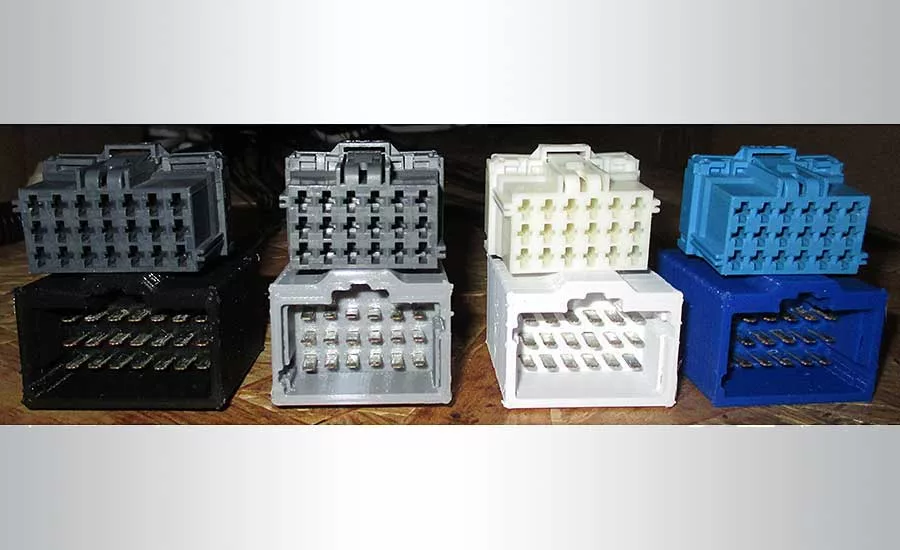

In this photo, CNC-machined harness connectors sit on top of their 3D-printed mating connecters, which are used for conductivity testing. Photo courtesy Electrex Inc.

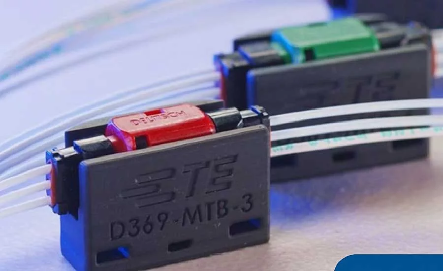

TE Connectivity designed and 3D printed this mounting holder for its D369 connectors at the request of an aerospace manufacturer. Photo courtesy Stratasys Ltd.

3D printing has also enabled Electrex to help its customers. Last year, for example, the company printed a unique connector that performs functional and continuity testing of harnesses for a priority customer that manufactures tractors. This increased the quality of the harnesses.

“Manufacturers can custom print connectors of any shape with any pin count they want,” says Logeman. “The printed connector body replaces that which usually gets injection molded, and the pins get inserted in a separate process.
“On the H350, its large work envelope (315 by 208 by 293 millimeters) enables a company to 3D print up to 200 standard three-pin Molex-type connectors in just 13 hours,” continues Logeman. “Nearly 400 smaller connectors can be printed in the same space. Production volume will vary by end-user, but the printer is cost-effective, regardless of whether the company prints thousands of connectors per week or year.”

Assemblers use various types of fixtures to mount a wire harness to a board during assembly. One type is a plastic holder or cover that each connector is inserted into.
Isabel Sanz, business development manager for the AMS region for HP Inc., says the Jet Fusion 5200 and 5210 models from HP are perfect for 3D printing connector holders. Both machines use Multi-Jet Fusion (MJF) technology for high-volume production.
MJF features a removable build unit with a print head that sprays a fusing agent in one pass onto a powder (PA11 or PA12) surface in the shape of a two-dimensional layer (0.003 inch thick). Infrared lamps then heat and fuse the powder, before another layer of powder is deposited, and the process is repeated.
Each printer features a work envelope of 15 by 11 by 15 inches, and a jetting system that precisely deposits 30 million drops of fusing agent per second per inch. As needed, the print head can apply a detailing agent onto areas next to the intended fusing area to prevent thermal bleed and enhance part performance. This agent also produces features such as rounded edges to prevent wire and connector damage during harness assembly.
“Either model can print up to 184 holders in one print job cycle, which involves 11 hours of printing, followed by 36 hours of cooling,” explains Sanz. “Our testing and research show that holders printed on the 5200 series reduce lead time from two to six weeks, down to one day. The holders cost from $6 to $7 per part when made at a rate of 250 to 300 per day. This represents a savings of up to 75 percent when compared to CNC-machined holders.”

“We’ve been 3D printing most of our prototype switches, along with connector holders, jigs, fixtures, and machine safety guards and spare parts, since 2015,” explains owner and co-founder C. Gustavo Farell. “Last year, we built nearly 500,000 harnesses, each of which features four or five switches and two to 10 wires.
“The main benefit of using 3D printing, for us, is that it quickens the speed to failure,” Farell continues. “What I mean by that is, the faster we can print the wrong part, the more efficient and cost-effectively we can create a mold for the right part to use in production. On average, it takes about three tries to get it right.”
Farell says CSI prints the holders in multiple colors to match those of the connectors. This helps ensure that the assembler places the correct connector in the holder and the correct wires in the connector. Colors include white, transparent white, black, red, blue and green. Most holders are one or two square inches, but can be as large as eight square inches.

Some component suppliers prefer doing their own 3D printing. TE Connectivity, for example, recently designed and 3D printed a prototype mounting holder for its D369 connectors at the request of an aerospace manufacturer. The holder correctly and securely mates connectors that are mounted inside aircraft enclosures.
Besides needing the holder quickly, the manufacturer required that it be made of aerospace-grade material to an accuracy of ±0.002 inch. The holder also had to pass industry-standard airworthiness and environmental tests to prevent failure during various operating conditions.
Engineers at TE Connectivity used the Stratasys Origin One for the project because of past experience with it. Experts at Stratasys, meanwhile, worked with Henkel Loctite to develop a flame-retardant photopolymer for the application.
