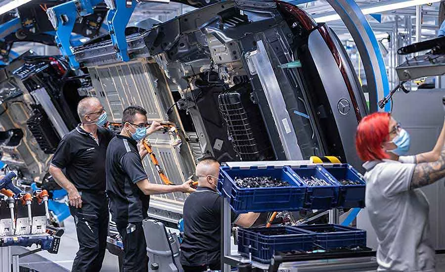

Pressure-sensitive adhesives are used in a variety of electric vehicle assembly applications. Photo courtesy Mercedes-Benz AG

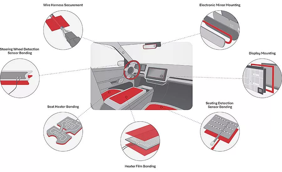

A variety of automotive interior applications depend on pressure-sensitive adhesives, including displays, mirrors and seats. Illustration courtesy Avery Dennison Performance Tapes

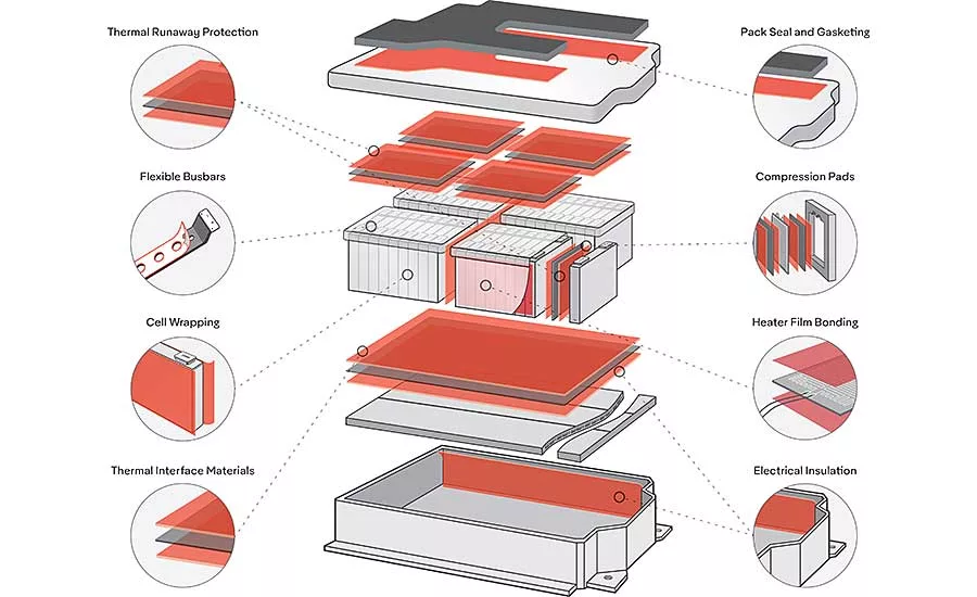

Adhesive tapes can optimize battery packs by reducing flammability and boosting dielectric strength. Illustration courtesy Avery Dennison Performance Tapes

Billions of dollars are being invested to improve driving range, reduce charging times, drive down costs and ensure safety. Adhesive tapes can help achieve these goals by reducing flammability, boosting dielectric strength, and optimizing design and assembly.
Safety is the No. 1 priority of battery manufacturers and their customers. Flammability issues with lithium-ion batteries can endanger drivers, lead to expensive recalls and erode consumer confidence in electric vehicles.
Tape designed specifically for EV batteries, such as acrylic, rubber and silicone-based technologies, provide protection against thermal runaway, allowing composites and materials to meet UL 94 V-0 and other flame requirements. These products offer the flexibility to work with all cell types and a wide range of materials.
Adhesive tapes can also support thermal interface materials (TIMs) that facilitate the transfer of heat between components in EV battery assemblies. Multiple adhesives for TIMs bonded to heat sinks or chiller plate materials assist with battery cell and module cooling.
These include high wet-out adhesives to lower thermal impedance between TIMs and the heat source; silicone-based adhesives that offer strong adhesion to silicone TIMs; acrylic adhesives for non-silicone materials; and flame-retardant adhesives.
Adhesive tapes are also being used for cell-to-cell bonding, gasketing, compression pads and electrical insulation. In cell bonding applications, tapes improve manufacturing efficiency by offering fast and simple bonding with excellent structural integrity. They require no cure time, providing immediate strength that allows them to serve as an assembly aid and bonding option simultaneously.
Due to their single component functionality, they eliminate the need for mixing nozzles and pot life concerns that exist with other adhesives. In gasketing applications, durable heat-activated acrylic foam tapes help maintain a watertight seal between the casing and rubber gasket.
Individual prismatic and pouch cells in EV battery packs require protection from impact and movement. Pouch cells can also swell during charging and discharging. To help prevent damage, battery manufacturers are using foams backed with PSA tape between each cell.
The ability to eliminate cure times enables the tape to serve a dual function. Flame-retardant and dielectric tapes can add functionality in this application when there are flame or electrical requirements
For electrical insulation, single- and double-coated tapes incorporating dielectric films are being used to protect sensitive components in batteries. Single-coated tapes can be applied to rigid materials like aluminum chill plates and other metal structures. Double-coated tapes can be combined with other materials, such as compression pads, to add electrical insulation to cell protection.
Using PSAs to bond flexible bus bars is another example of tape’s versatility, as they can provide insulation and flame retardancy as well as bonding.
