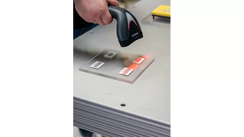

3. Component Identification
Each component involved in the threaded assembly process can be assigned a barcode. As workers scan these barcodes, the system can instantly identify the specific part, ensuring the correct components are being used, and the correct torque is being applied to the right fastener. Adding barcoding to your assembly cell can also be used for workstation verification, sequence control, error detection, tool verification, training, and documentation, making it a useful error-proofing tool.

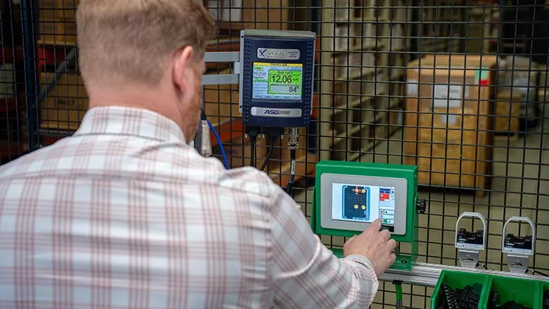

4. Angle monitoring
Angle monitoring, available as a standard feature on the X-PAQ, is sometimes overlooked as an error proofing method, and it comes free with every X-PAQ system. A tool will run the fastener to its assigned target torque. But if the bolt or screw cross threads (one of many rundown pitfalls), the tool is still going to hit the target torque and tell the operator that the fastening is good. Using an angle monitoring strategy will ensure that the fastener seats and hits the target torque by measuring the number of revolutions from a torque threshold all the way until the target torque is achieved.
5. Encoder Torque Arm
Torque arms with encoders are cutting-edge systems designed to ensure precise torque application in threaded assembly processes. The torque arms feature encoders that provide real-time feedback. By integrating an encoder torque arm with navigation programming like the ASG Nav-P, you are able to ensure that operators apply the correct torque for the assembly process in the correct sequence. By presenting a clear and intuitive user interface, operators can easily access assembly instructions and follow the correct workflow, reducing the likelihood of errors and minimizing rework.
